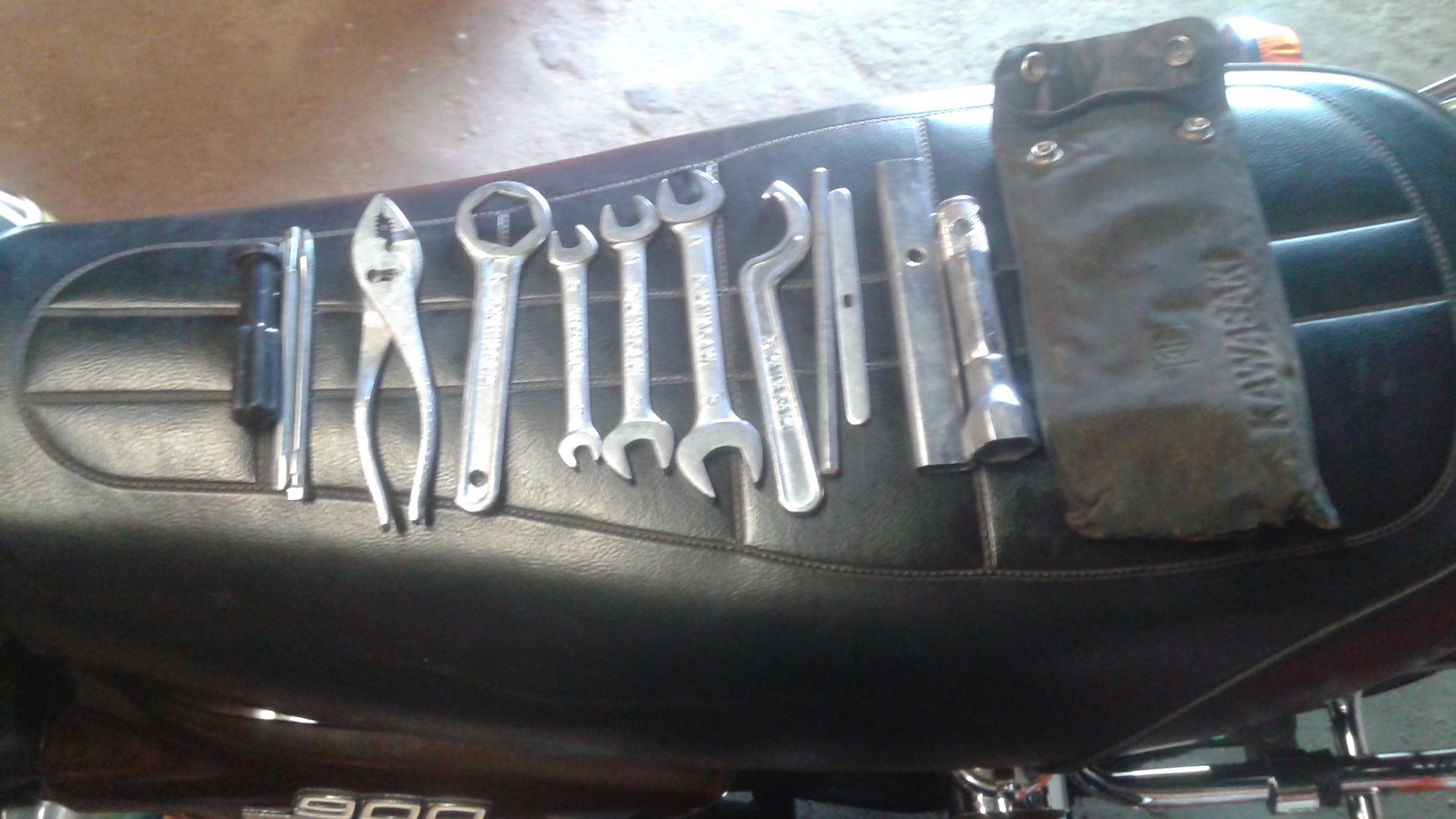

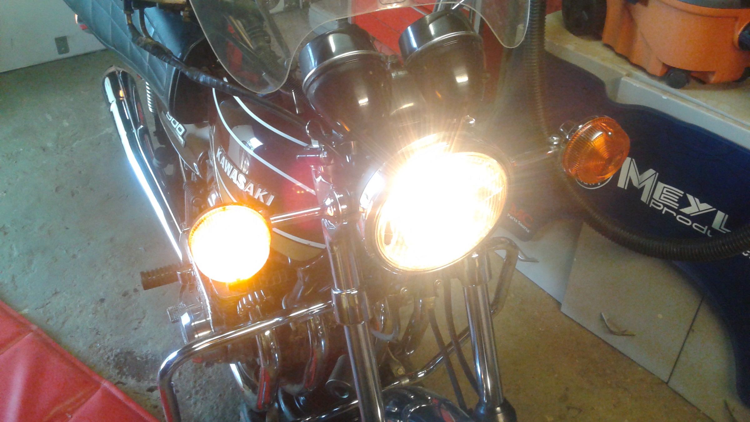

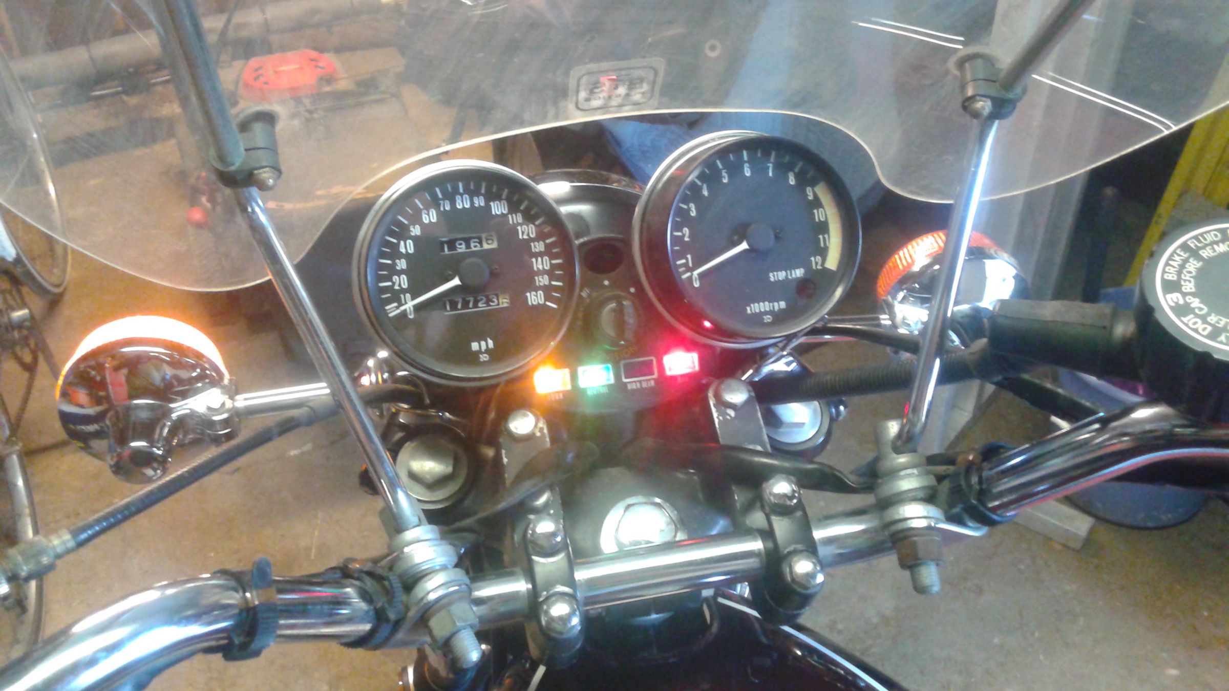

Jeff @ Z1 Enterprises is very knowledgeable about KZ/Z1's, i had a great phone conversation with him today. The other day i pulled the plugs, fogged the cylinders and gently kicked it over a bunch of times by hand. I just changed the oil & filter, hooked up my jumpbox, sprayed some starting fluid into the airbox and it fired up!!! Then died of course but those couple of seconds was music to my ears! All the lights, horn and switches work as they should. Now i plan to order a carb rebuild kit, M/C & caliper rebuild kit from Jeff. I also need the bolt that holds the oem pliers together, it's missing.
