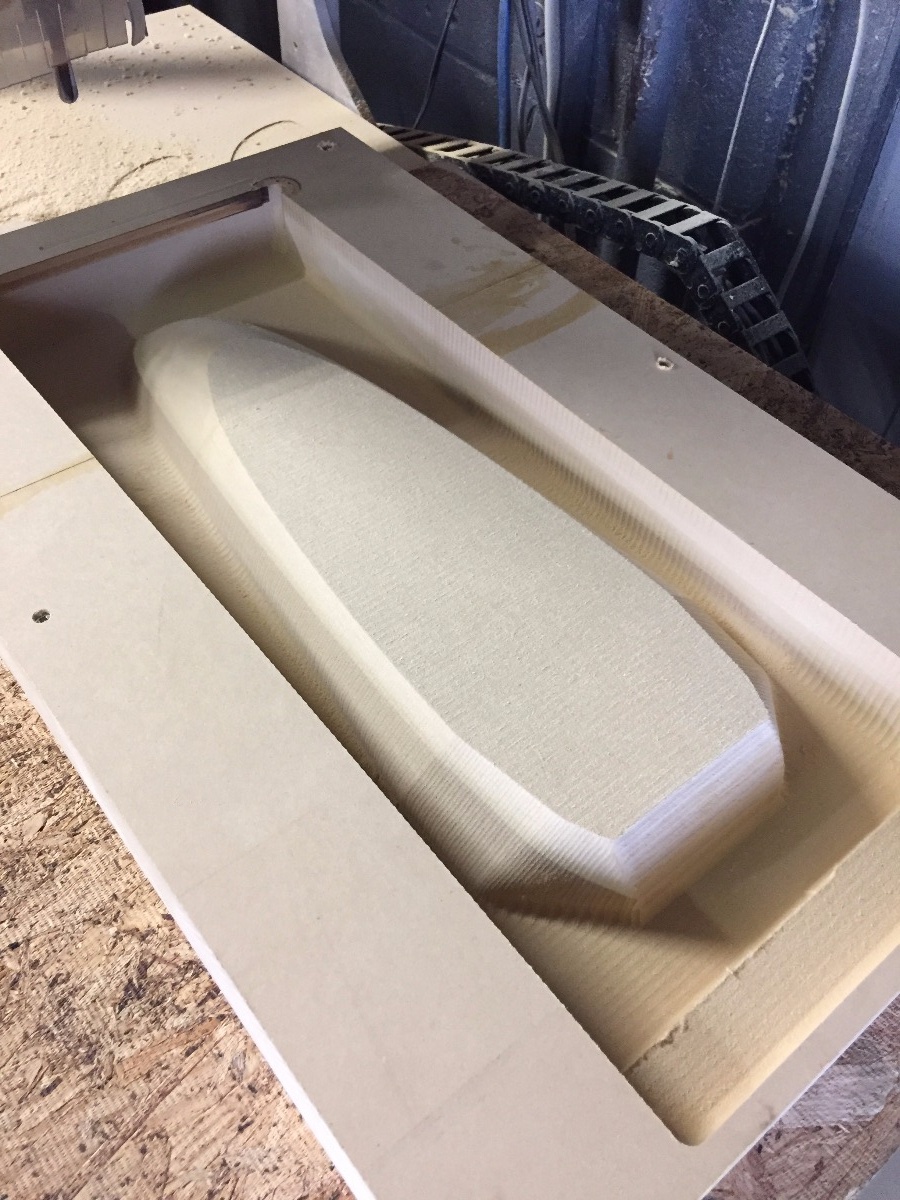

I started forming the inner fender. First I made a form that follows the seats angles, then I got a 10lb block of "air dry" clay from Walmart for $10. I felt like I was back in art class in middle school.
[IMG
[IMG
[IMG
[IMG

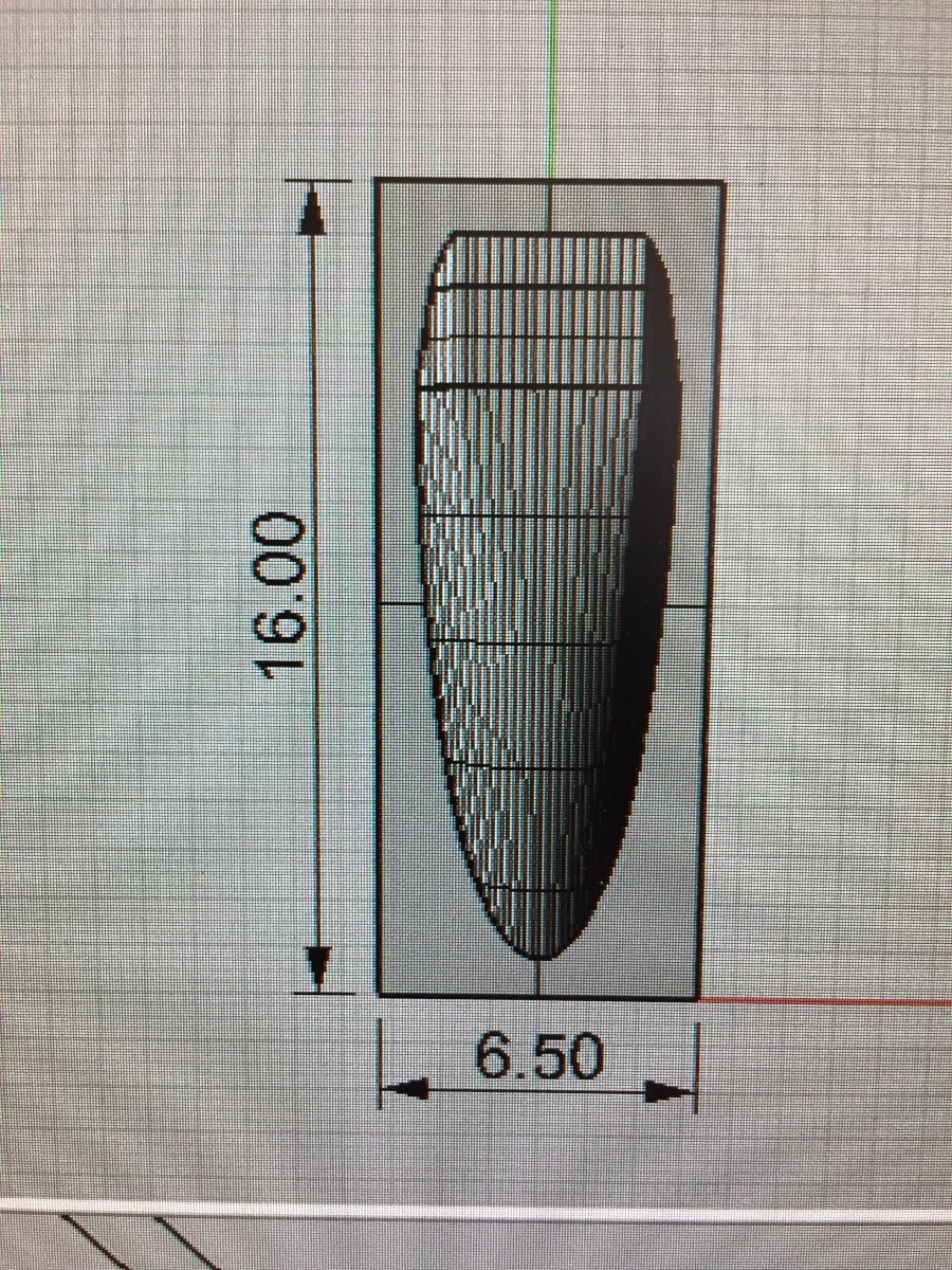

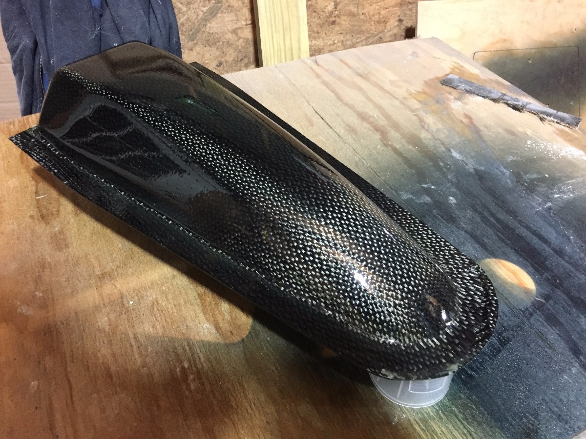

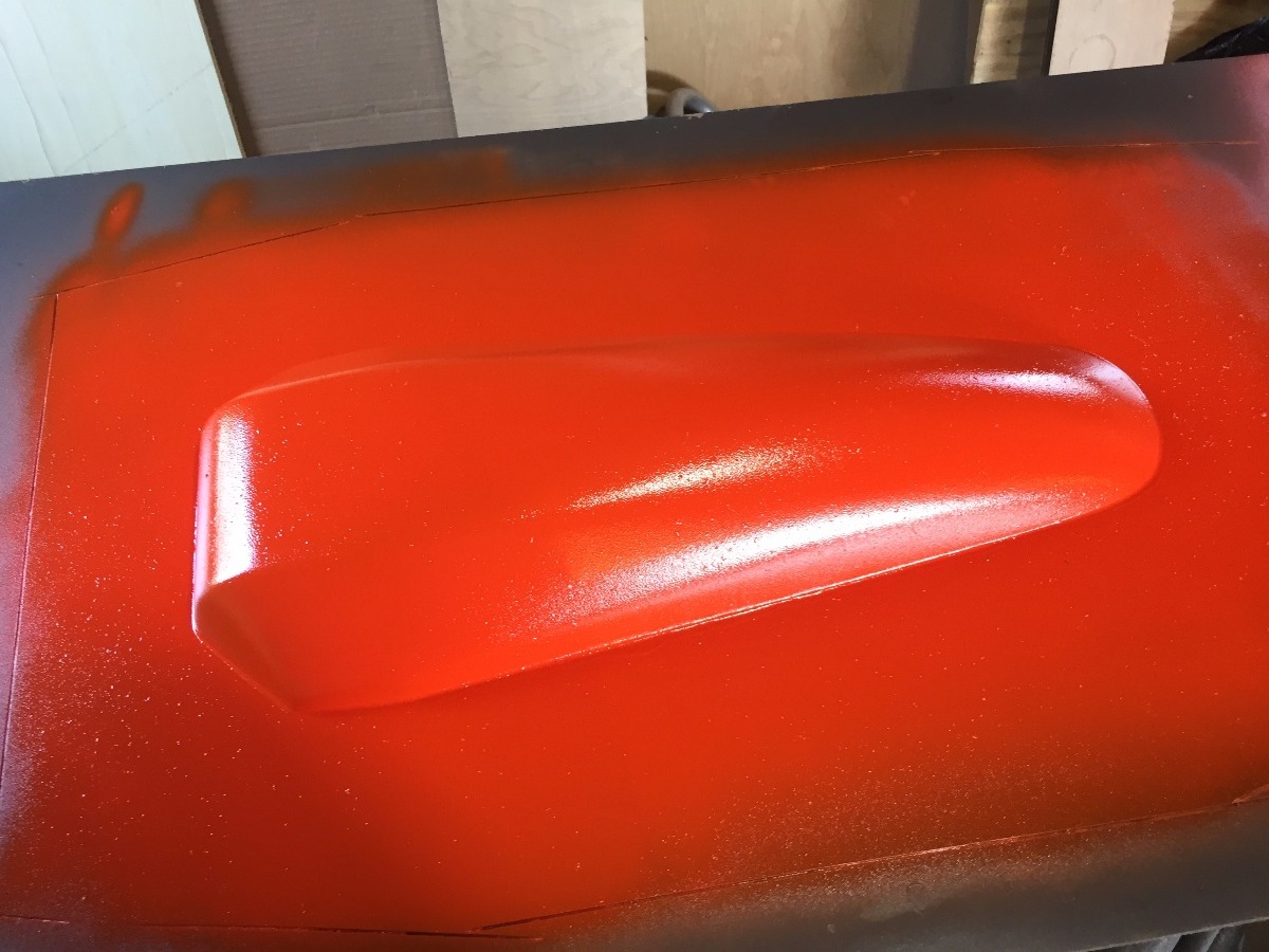

Made some progress
inner fender design
getting cut
gel coat
DONE

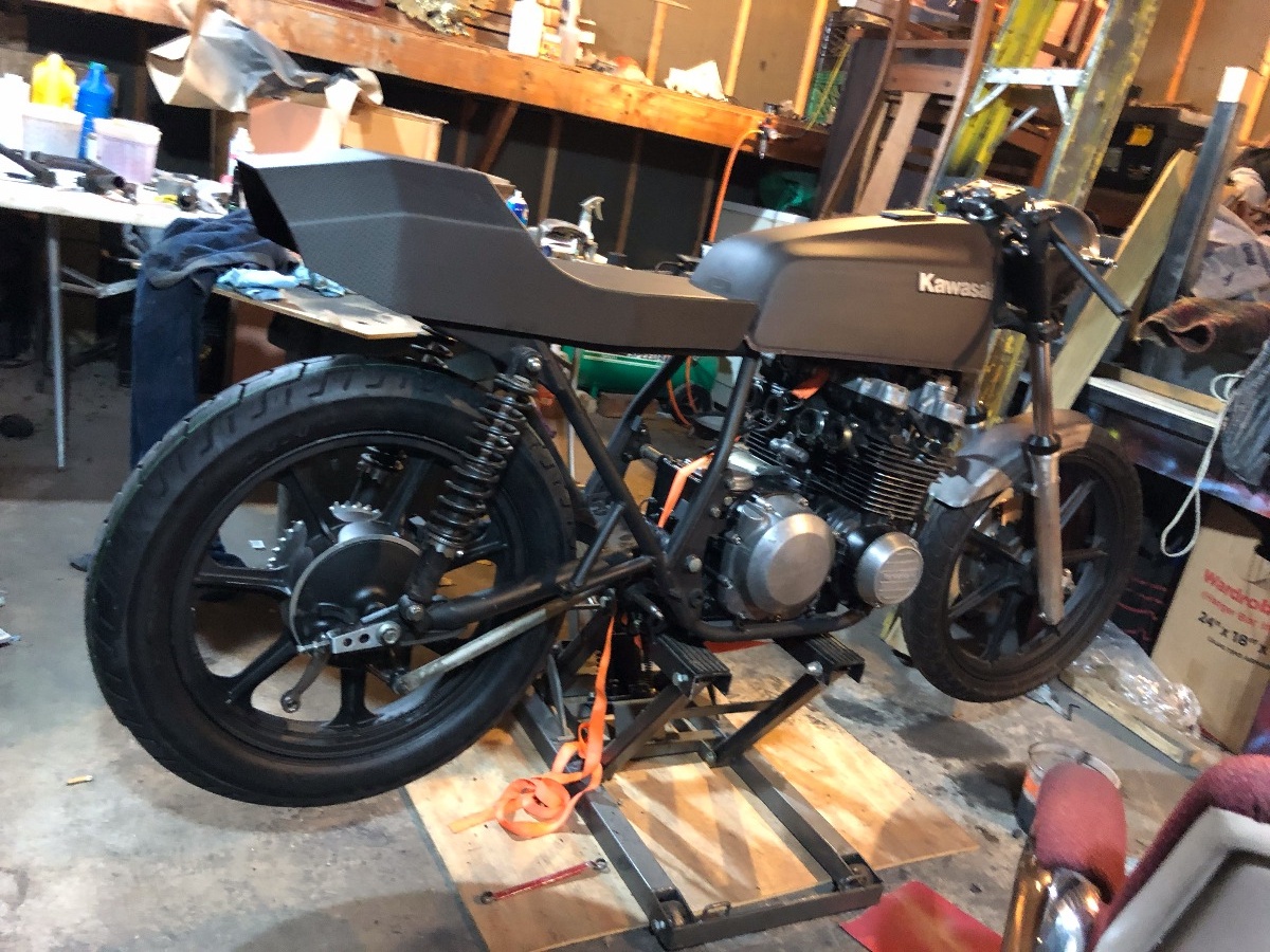

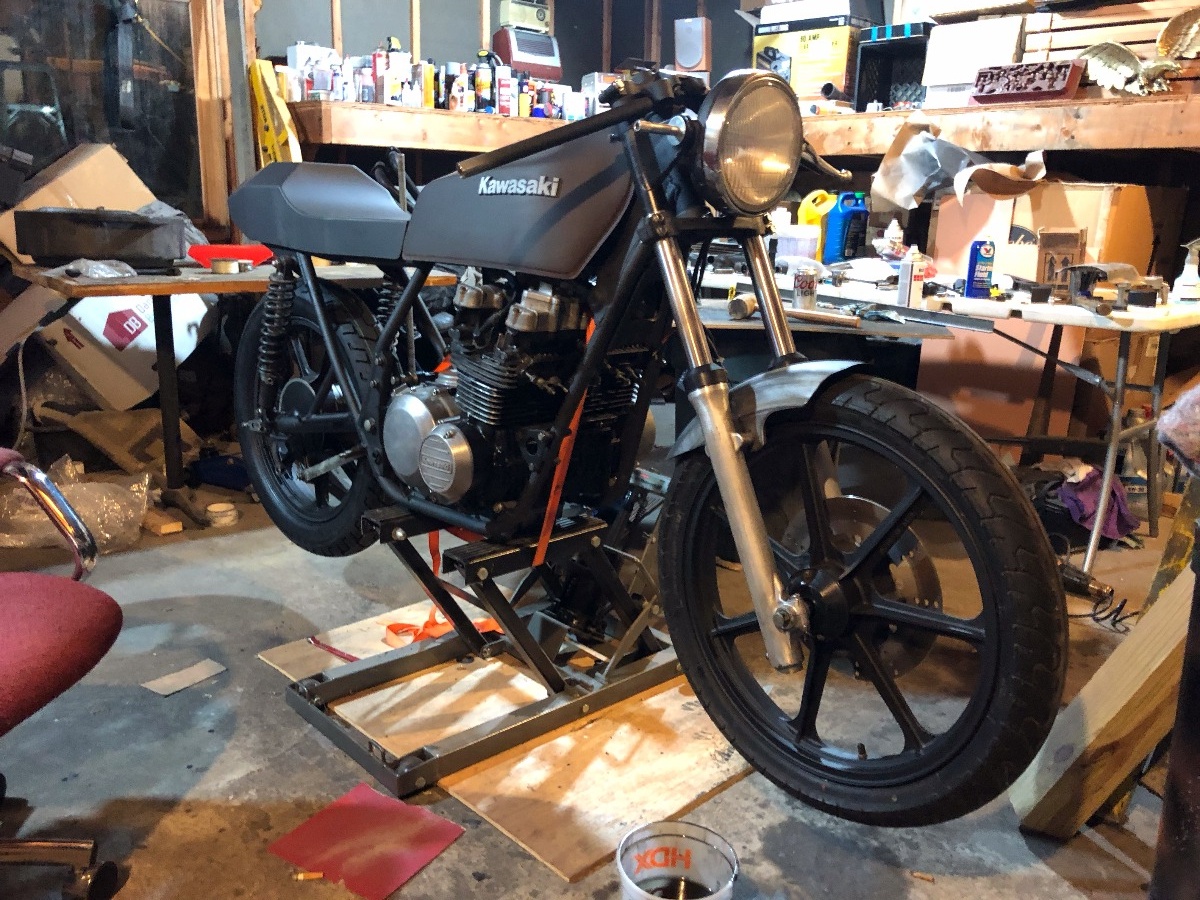

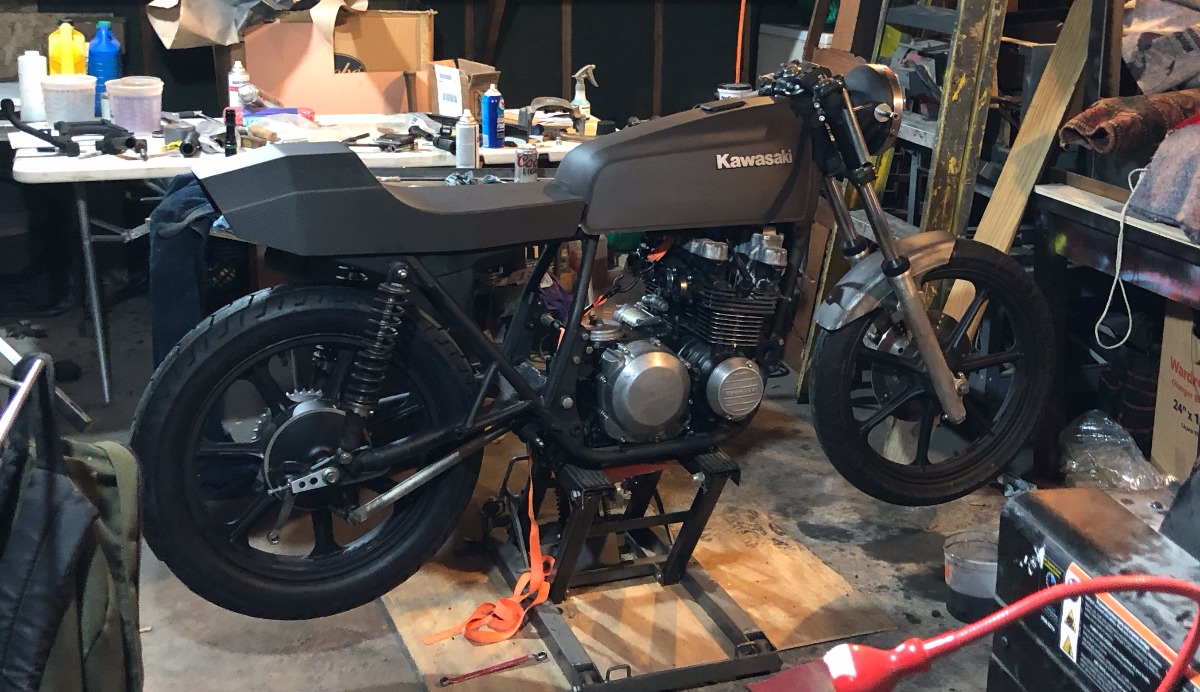

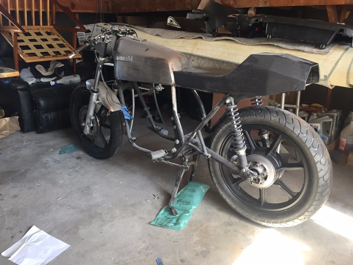

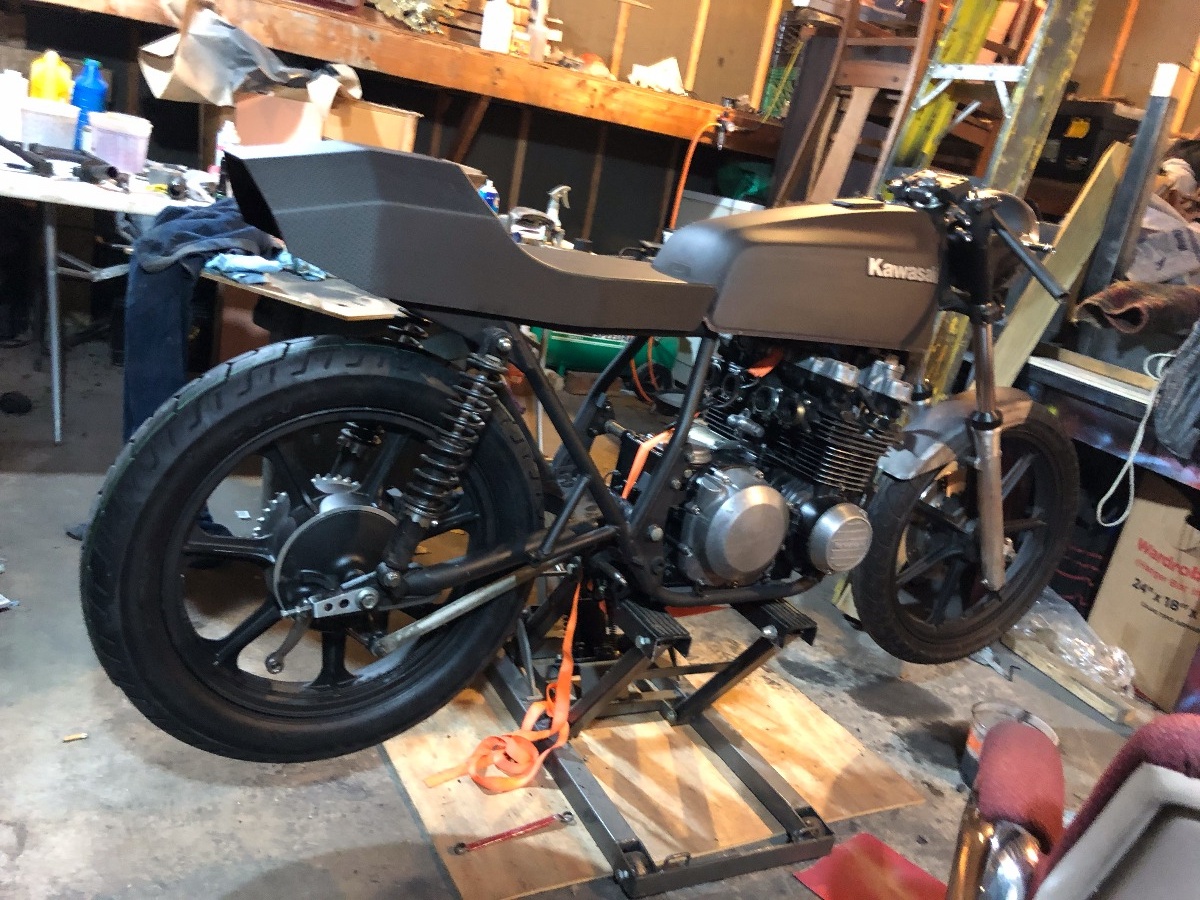

Painted the frame. Did a metal blackening thing to the tank and front fender. Mounted a new rear tire and mounted the wheels. I think it's starting to come together now.
before:
after:
Last edit: 24 Oct 2017 21:53 by acetone.
  • acetone
  • acetone's Avatar Topic Author
  • Posts: 24
  • Thanks: 0
Re: KZ550 Cafe Retromod
24 Oct 2017 22:04
#773686
Looks like I have the brake drum mounted upside down. oops.
