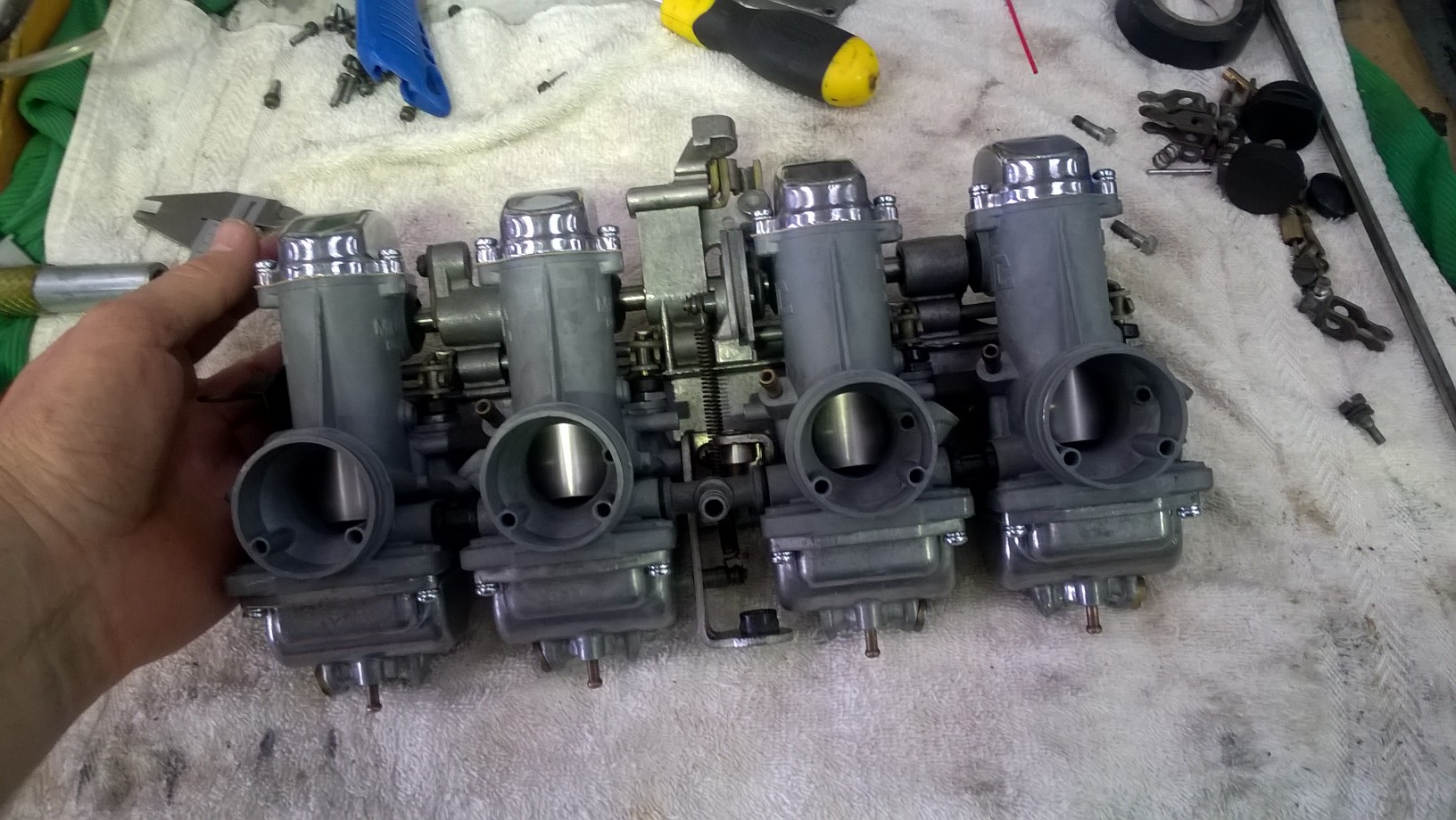

Awesome, Kiwi connection is always a good thing! My next project is a GPZ750R1, it will remain buried until I get the Z1R finished......so coud be a wee while! How much are you after for your 29's? Would love a set, would just have to do some serious sweet talking at home though. You did remind me though that I had actually finished the 28's and never posted a pic.

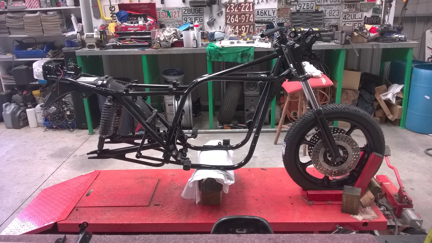

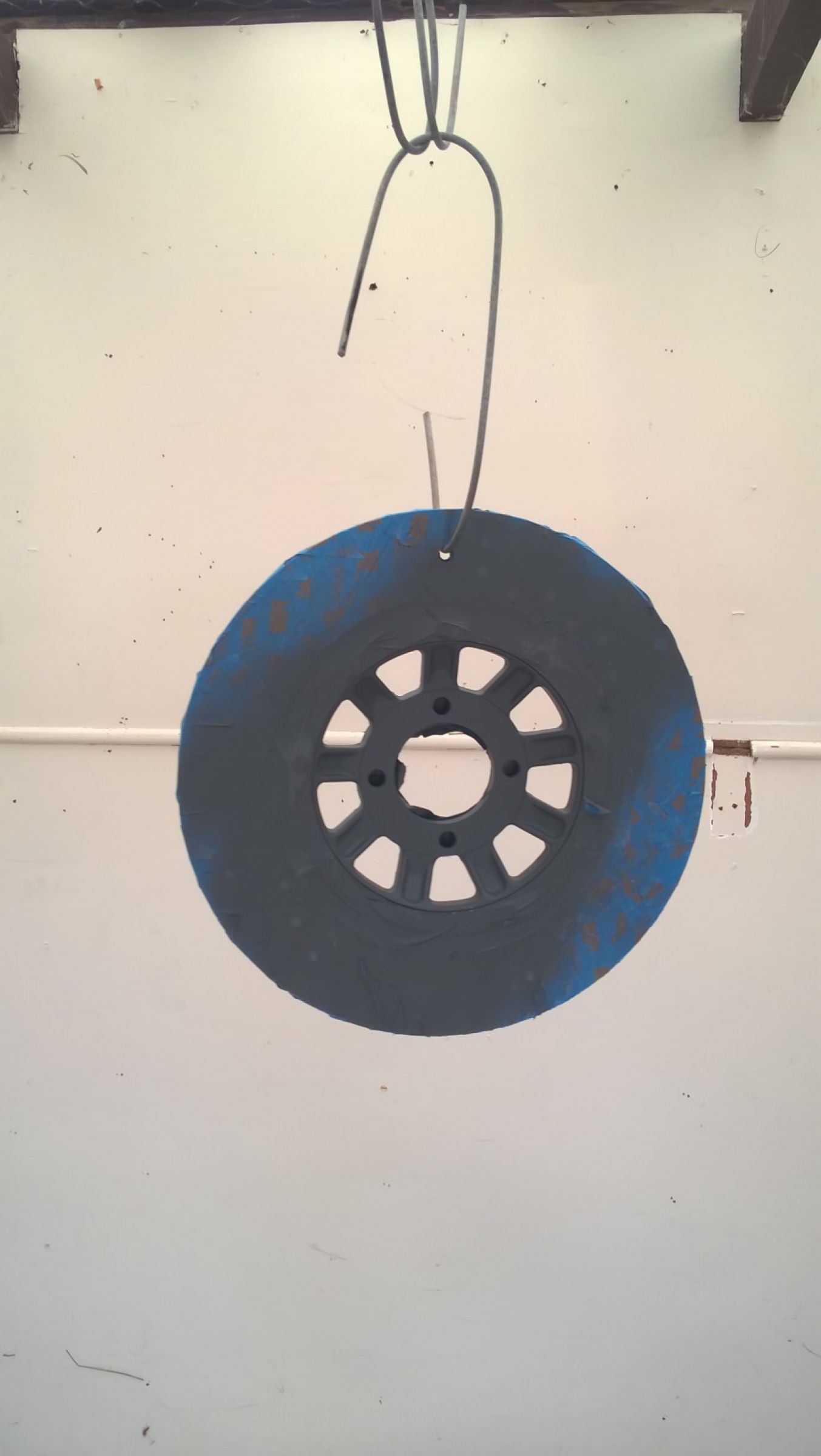

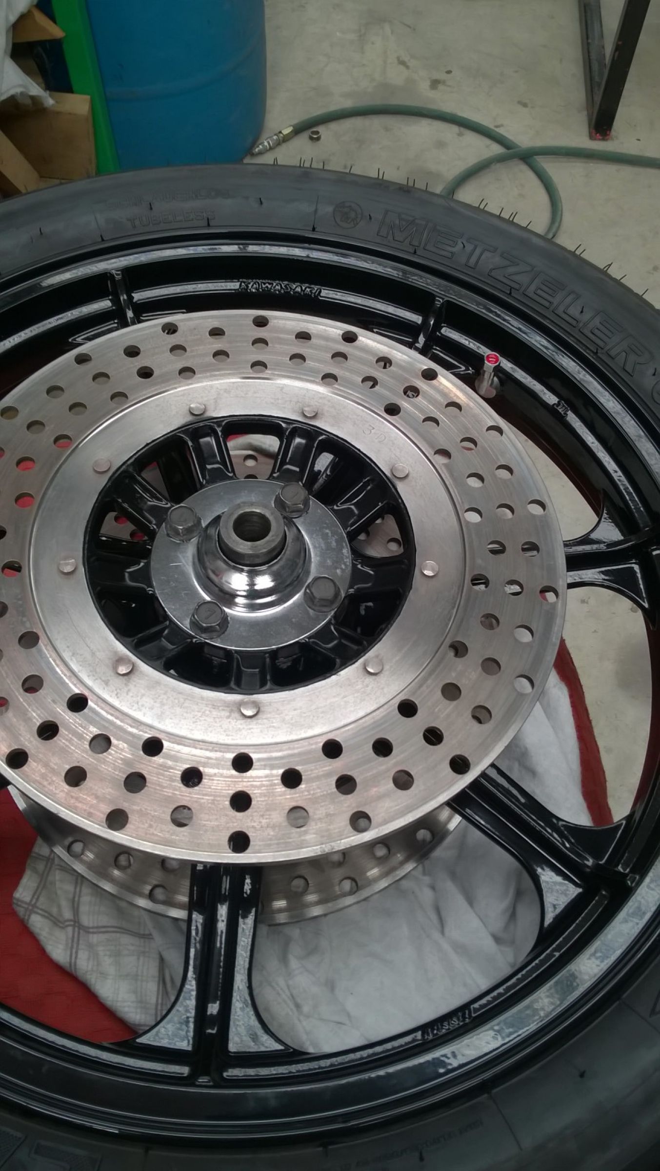

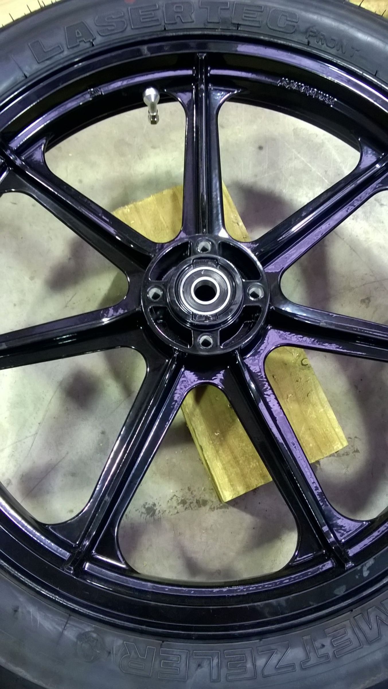

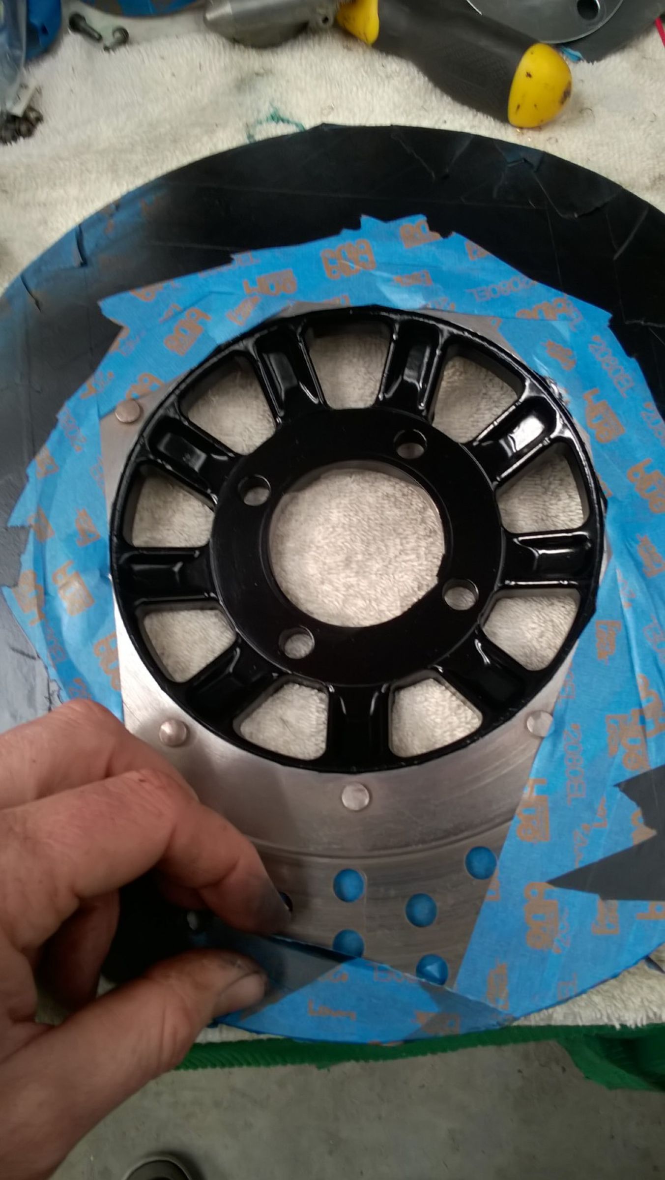

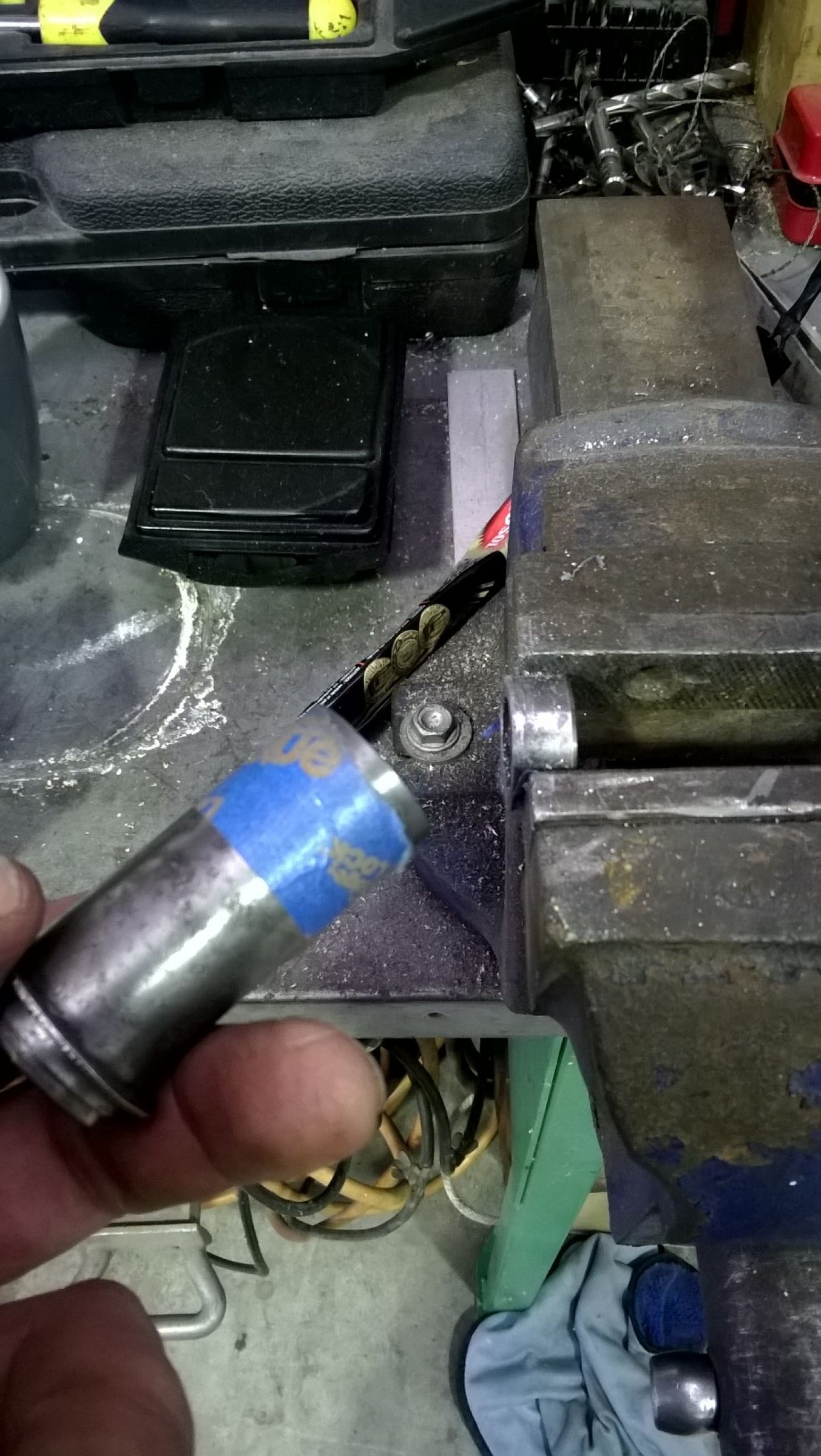

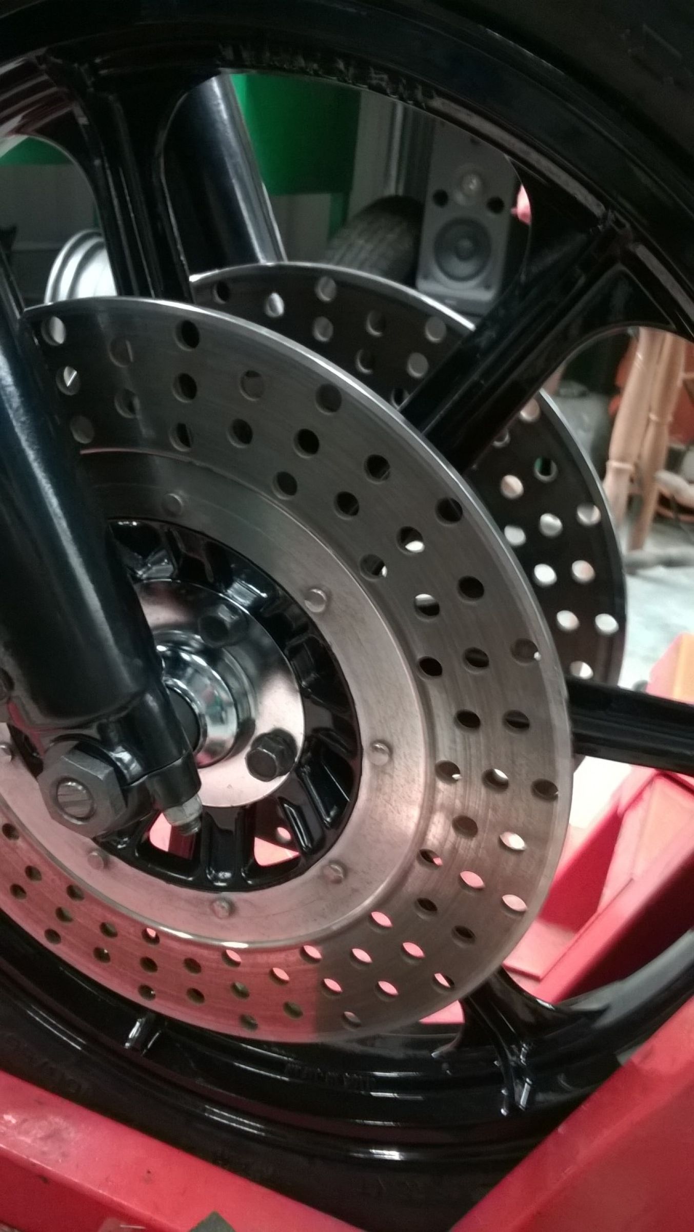

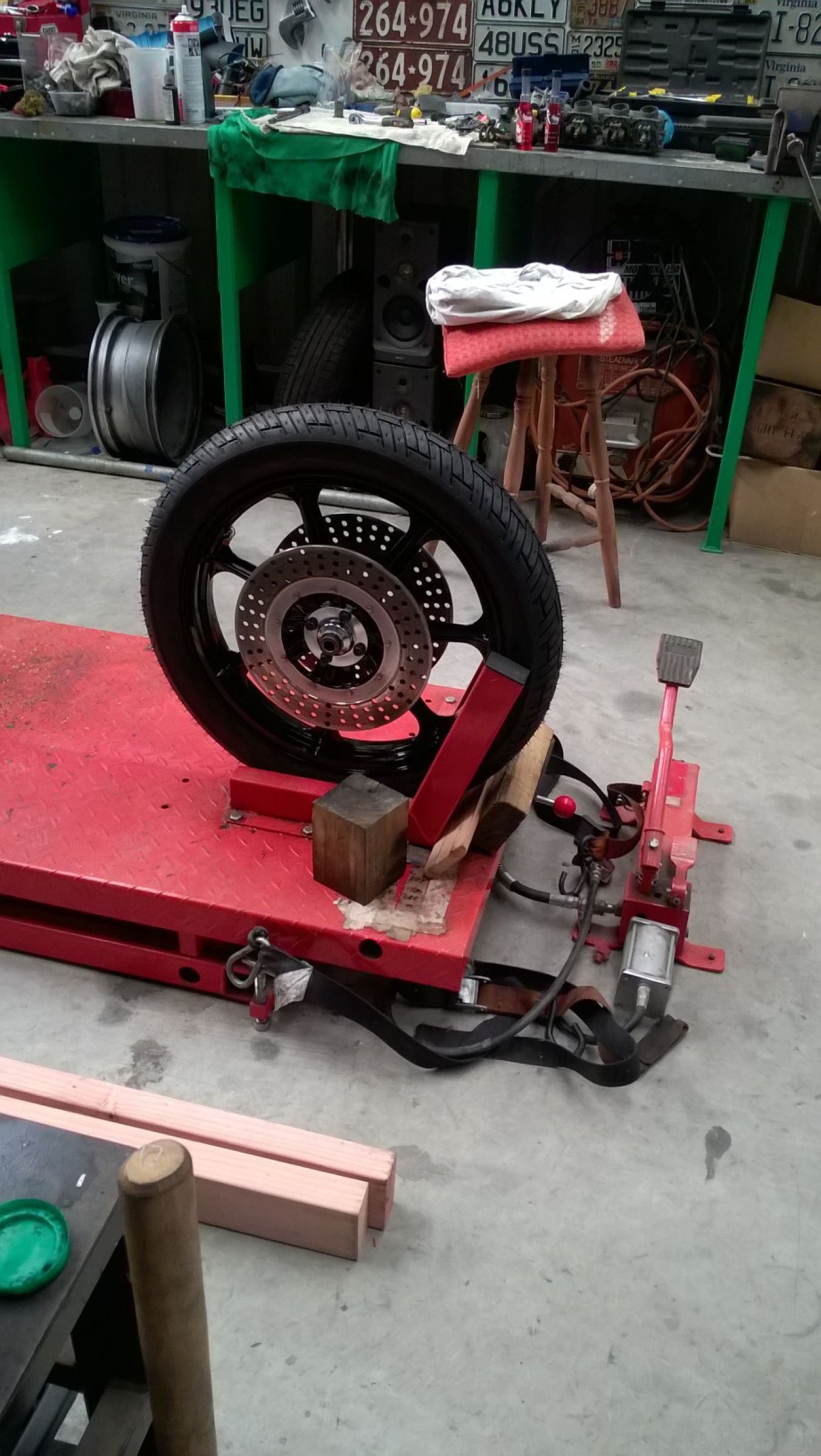

Cracked into the front rotors again today and blasted the centres, taped them up, and banged on some paint. Nice! One helluva lot better than the hideous rusty bits they were when I picked them up. Having discs means I can pull finger and bolt up the front wheel to the frame. Put new bearings into the front rim, remembered that the rim never had a crush tube in it so had to cut up one from a GT750 rim and use that. Job sorted. So now I have a nearly rolling chasis! More like a unicycle at the moment :S . Rear rim is pretty much all done but I need to rebuild the rear brake caliper before it can all go together.................so guess that means its on to brake calipers next then.

Re: Kiwi Z1R
26 Aug 2016 21:33
Kiwi
Those carbs came out great, im envious.
