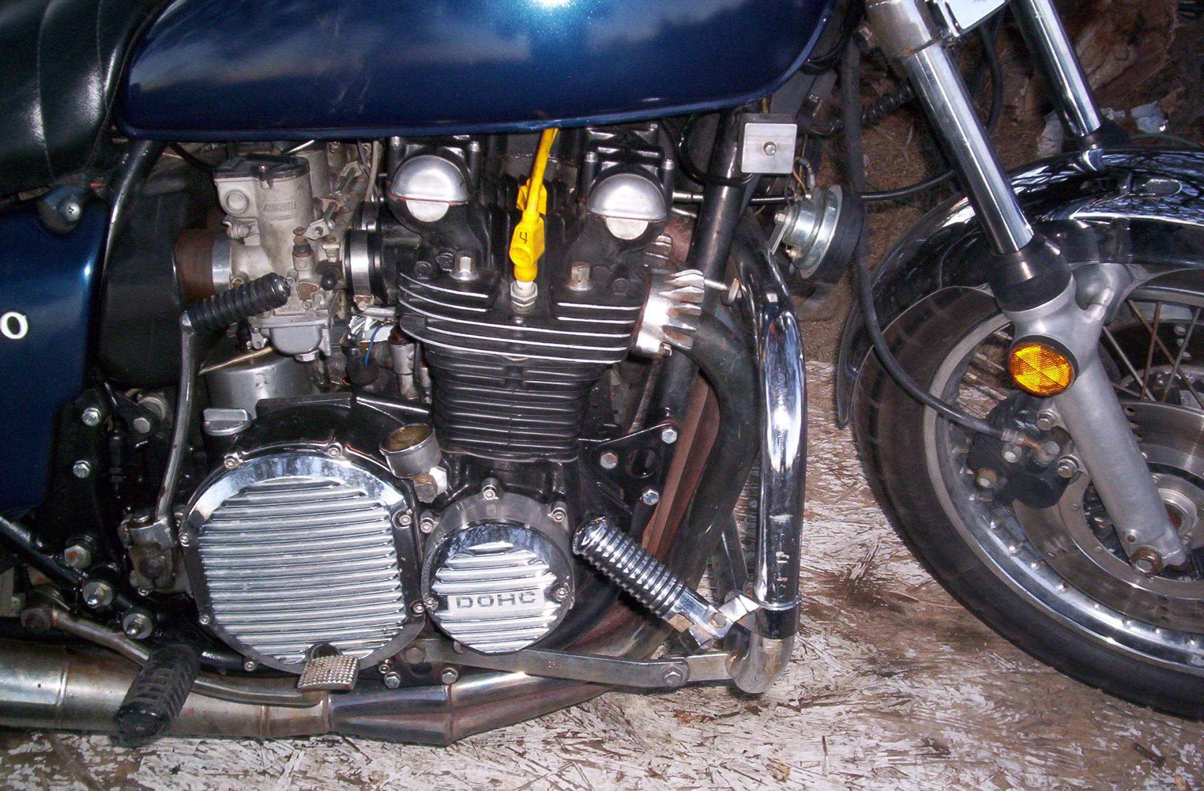

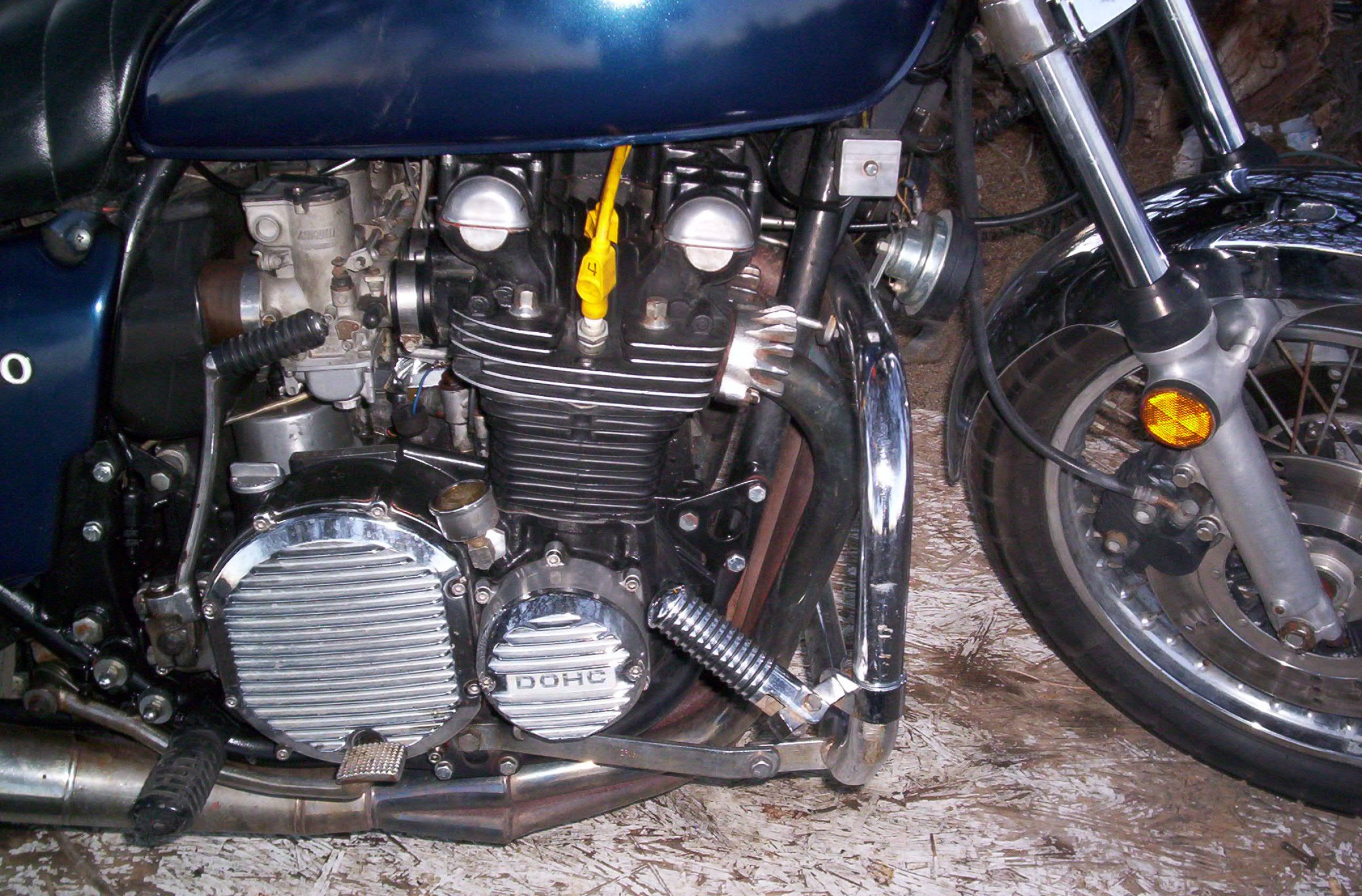

I have new plugs and wires. What is the best way to route the wires? It seems like a bad idea to just let them lay on top of the valve cover. I have them zip tied up above the valve cover but I feel there must be a better way.
