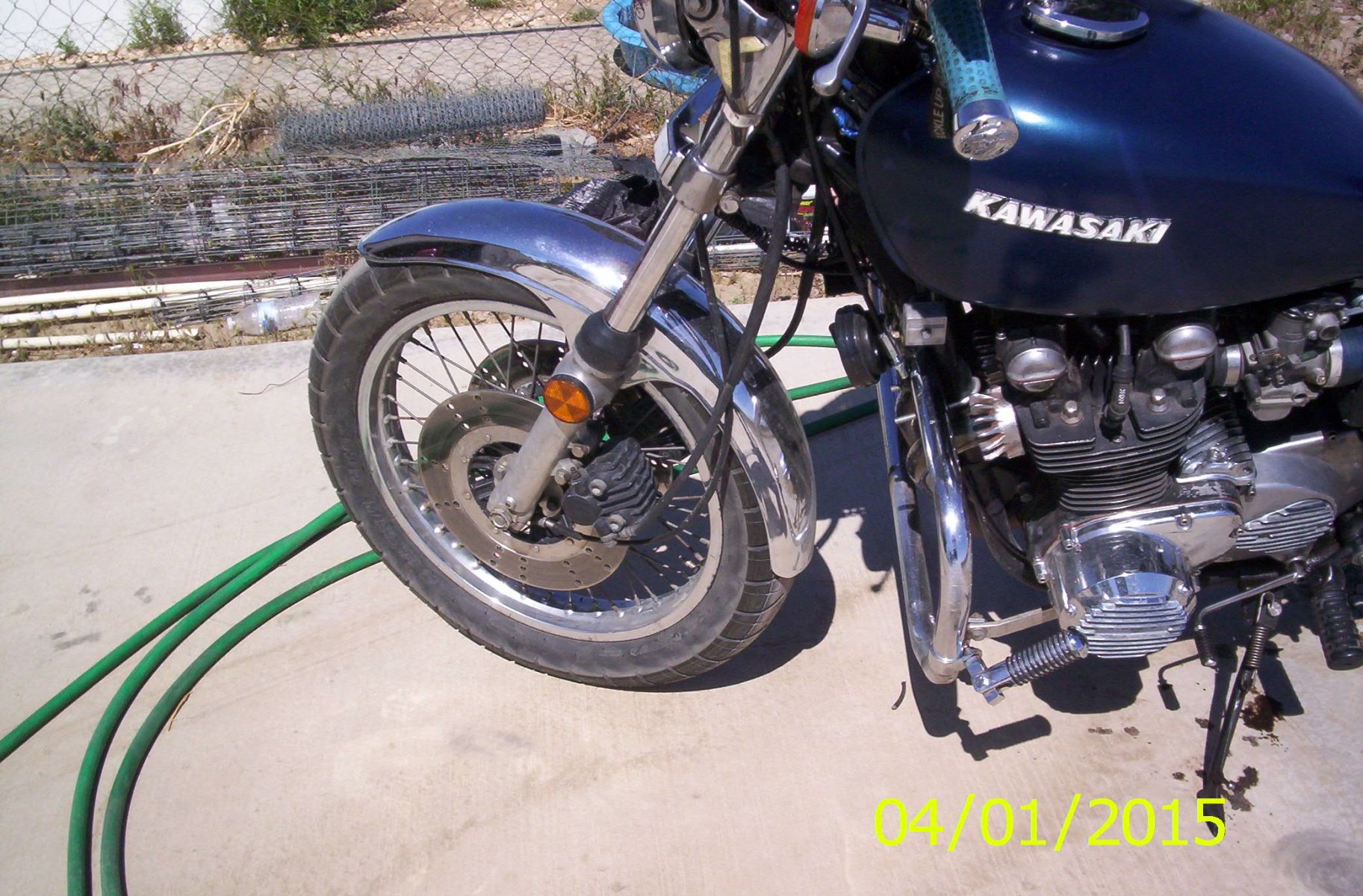

Ok, time to try and get some photos actually uploaded. The bike is in pretty rough shape, but some basic detailing is already showing results. The chrome is all pitted, at least somewhat. The seat has a split, but i have vinyl repair guy that should be able to fix it. The tank looks to have been repainted, and the emblems shaved. The repaint looks nearly stock in color. The bike is mostly complete, and has a number of period mods. Tommaseli headlight ears, dyna ignition and coils, a dresda swingarm, mag wheels (are they Lesters or stock from a later Kaw?). The tank still has gas in it (from 1997) but the carbs were removed and drained, and look good inside. Some mysteries too; it only has a single disc brake, but is on the right, as opposed to the left as most are.
Next steps:
- buy an ignition switch and key
- drain gas and hope for the best
- change oil
- change plugs
- buy a battery
Next steps:
- change oil
- change plugs
- buy a battery
Last edit: 16 Apr 2016 20:28 by Zoo Mob.

Dont forget to change the oil and filter. Might want to squirt a little oil down the sparkplug holes and work the kicker a few times.
In stock form, the brake caliper goes in front of the fork.

It was supposed to be for better braking and handling. I did it to my bike before I got duel ones in the 80's.

Looks like Lester rims, & Z1R rotors
