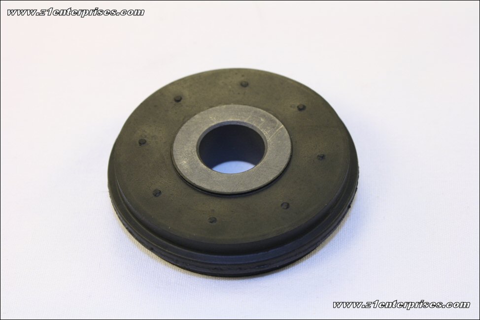

Damn laptop. Failing. The clean area around the edge of the piston suggests that. Be sure the roller rubber isn't hard, cracking or sloppy' They will come apart in no time. After all these years I finally put in Liska's. They won't come apart and are 1/2 the price of OEM.
