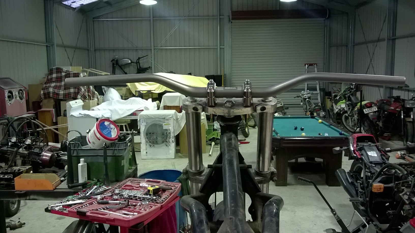

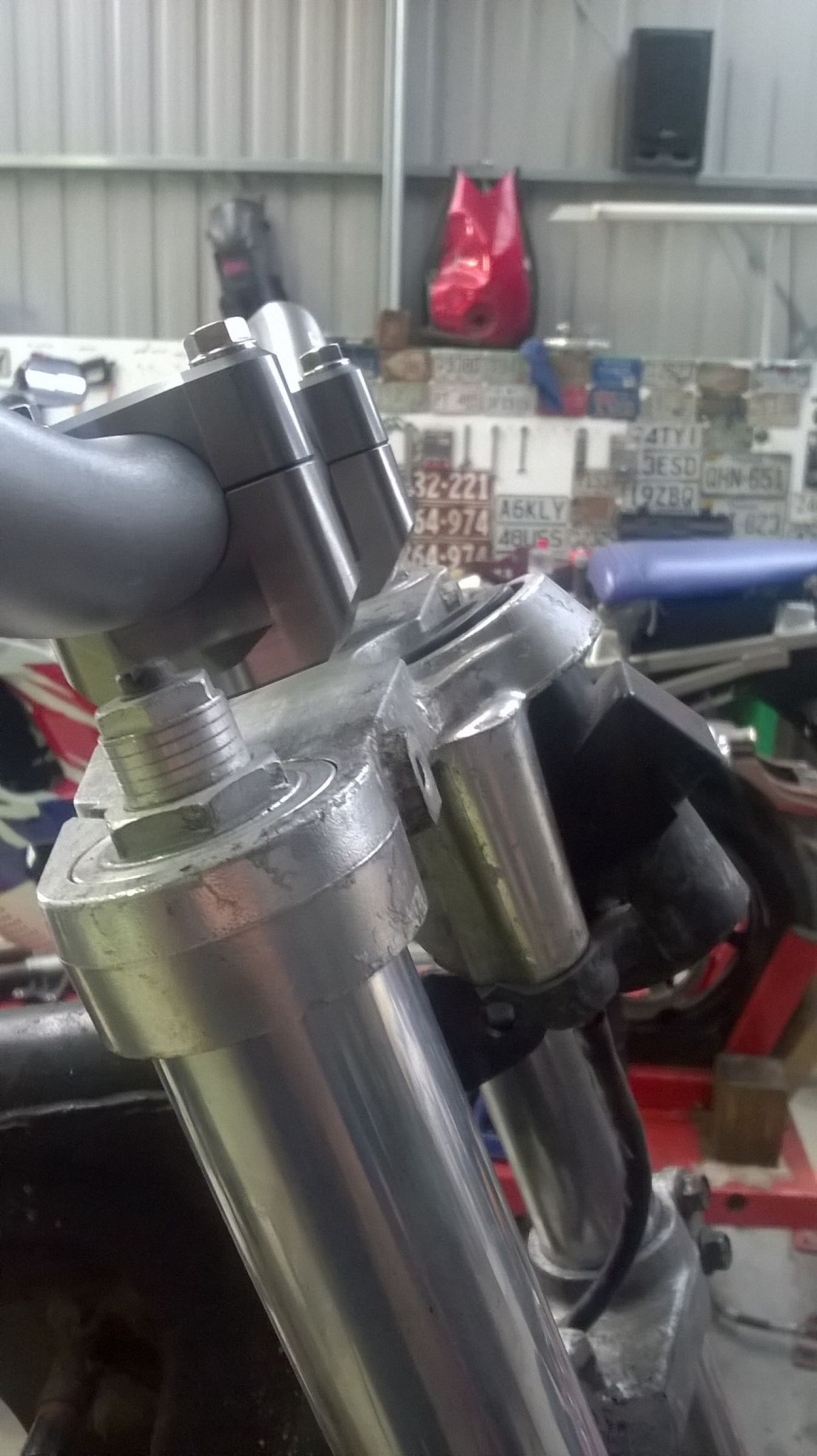

I haven't had a chance to get much done of late so I thought I would do something easy but rewarding on the weekend. Due to my dodgy back I really like high bars on my bikes these days. I bought a set of mx fat bars and risers and started the fit up. Placement was a bit of fun as there is a bracing web right smack in the middle of the underside of the top clamp. I was going to make some risers and lift the bars up higher than the forks and have them mount more central but after umming and arring for a while I decided to move them back a bit. Made life easier as I don't need to make riser mounts or deal with the casting ridge on the top clamp. Also looked good this way with the fairing fitted (me holding it up). Drilled up the holes and nearly jobs done. Just need to shorten the bolts and rethread them. Back to the rear swingarm again next.

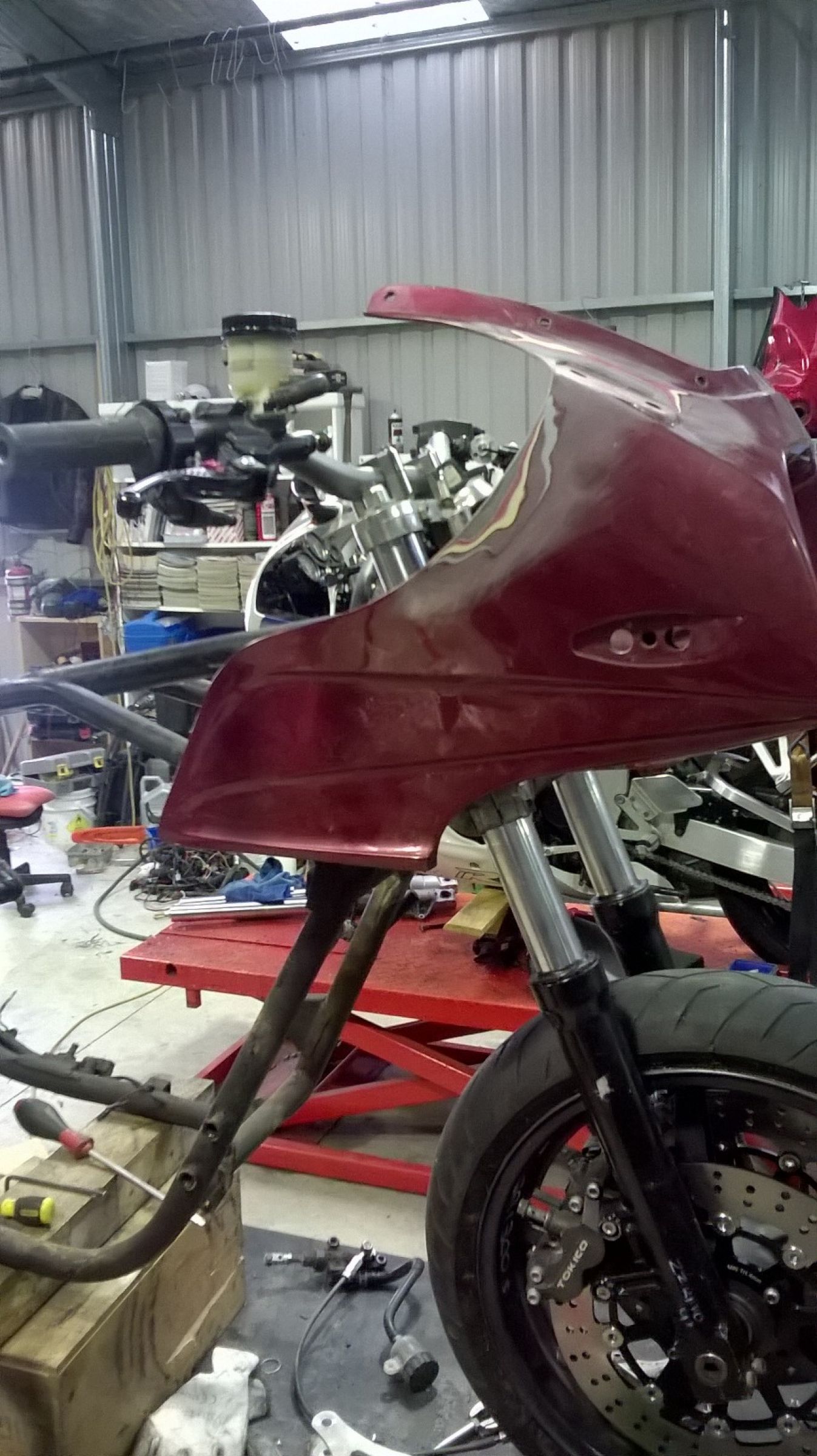

17 Mar 2016 23:59Okay, back into it................just so I could have a look at how it will all sit together I put the front fairing on loosely and attached the clutch and front brake levers. As I am using up parts that I have in the workshop where possible I have dug out the front brake master cylinder and clutch perch from a TL1000S that had a few years ago. They have a nice set of ASV levers as well which is a bonus. Once the clocks etc are fitted I am picking the big GPZ is going to look pretty cool with it's MX bar setup. Hope so anyways!

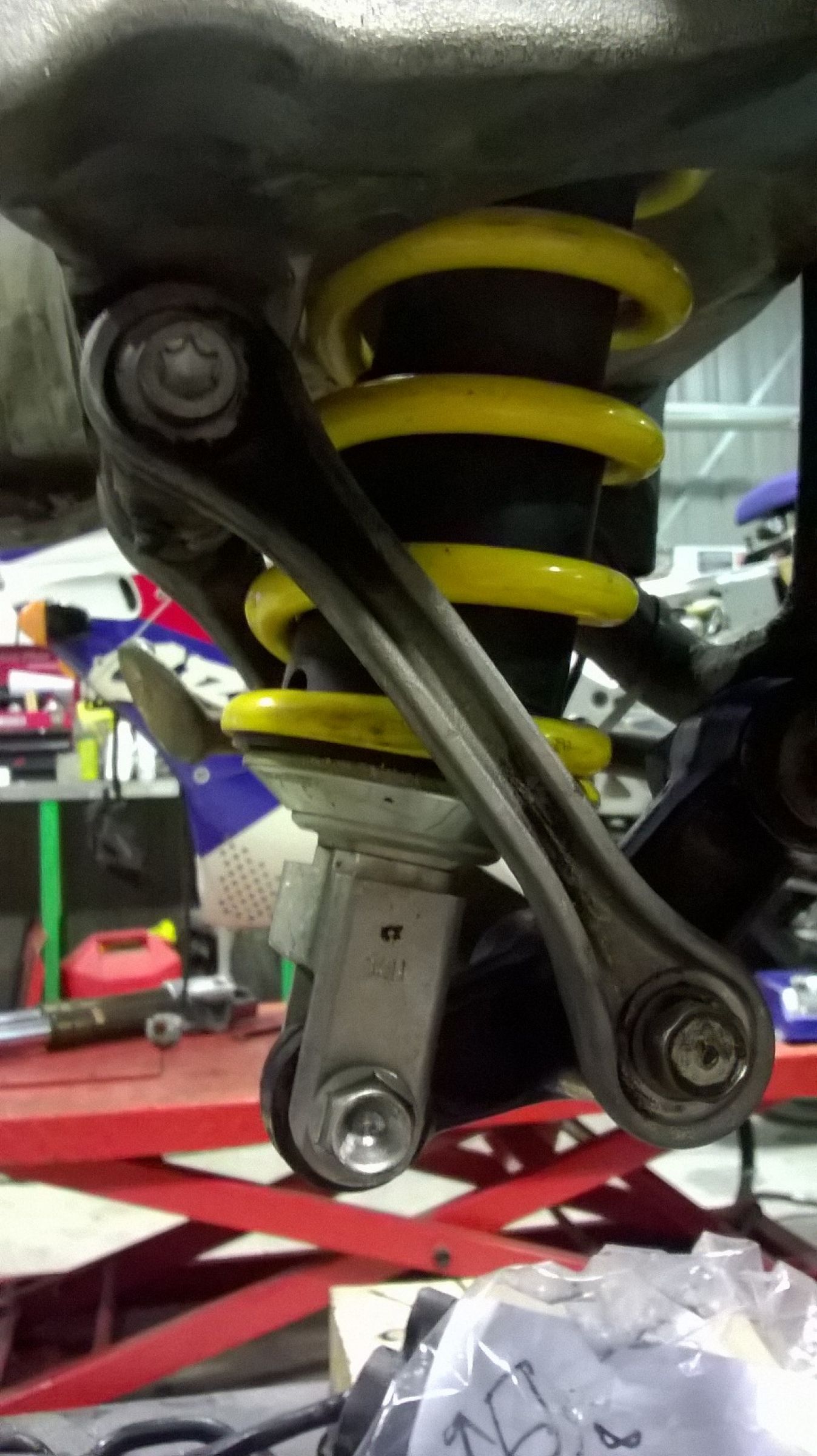

18 Mar 2016 00:05

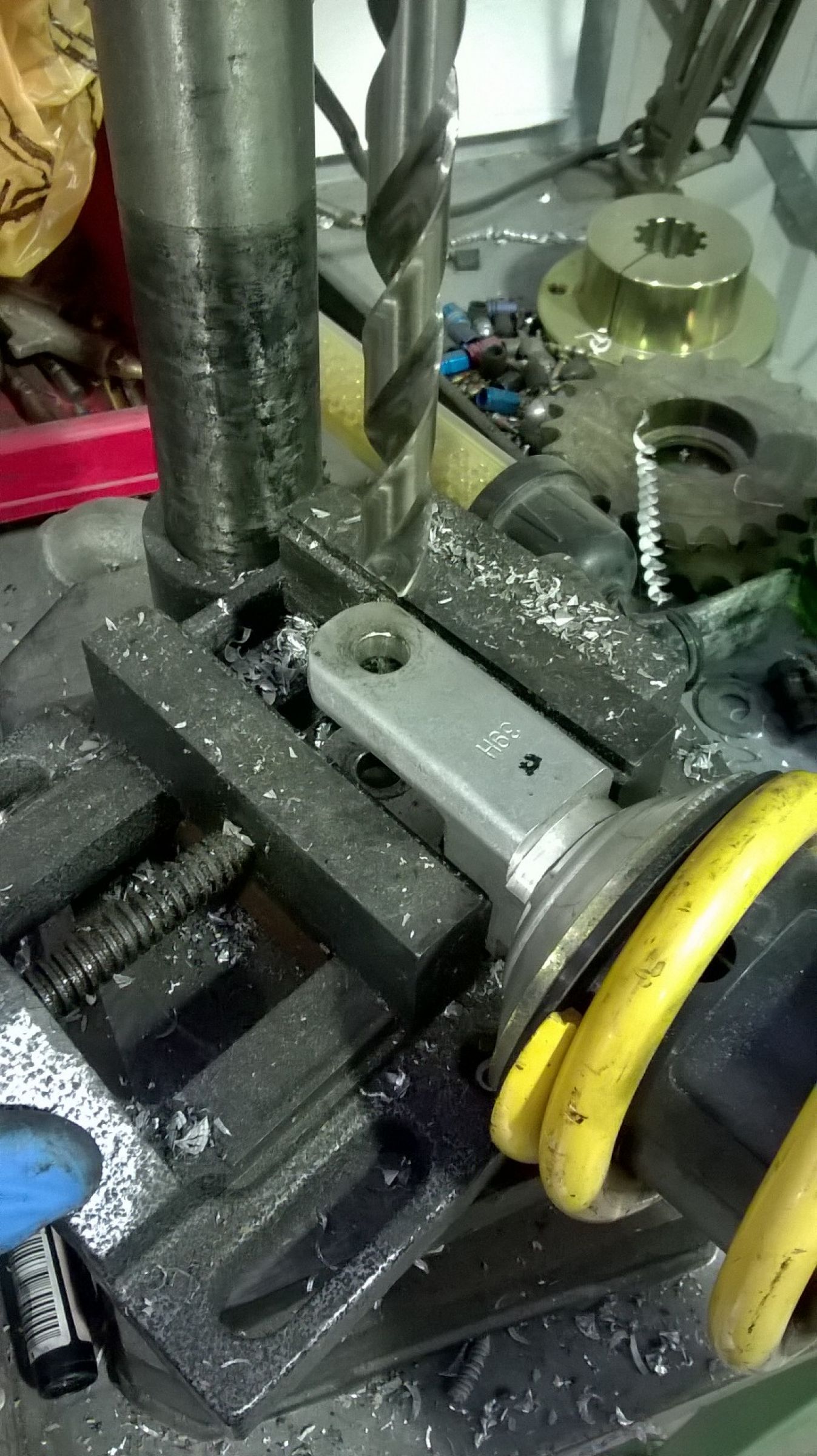

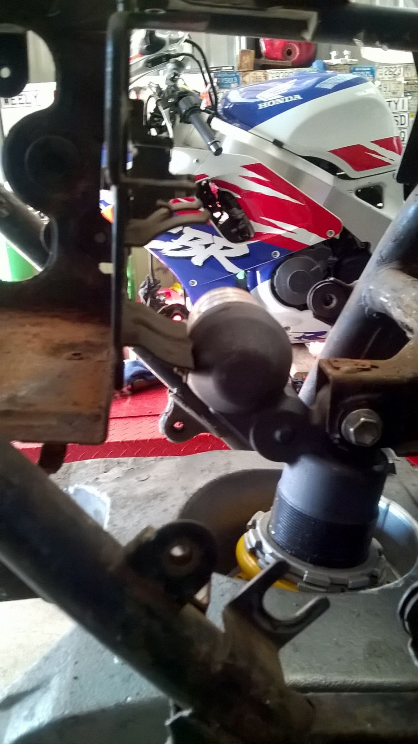

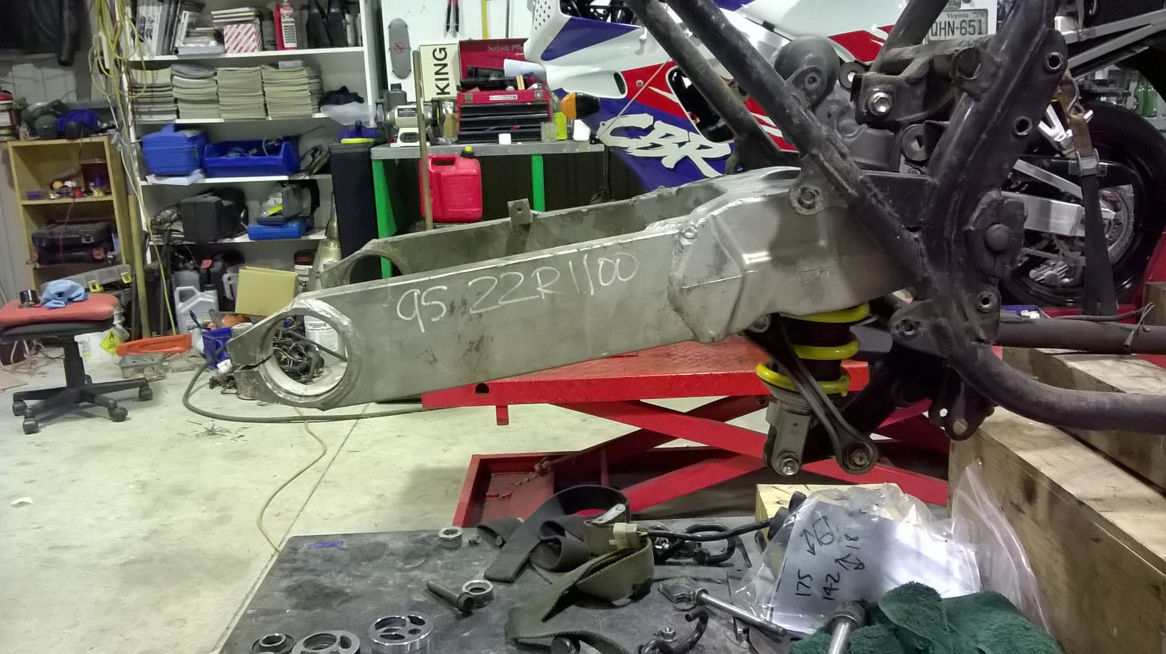

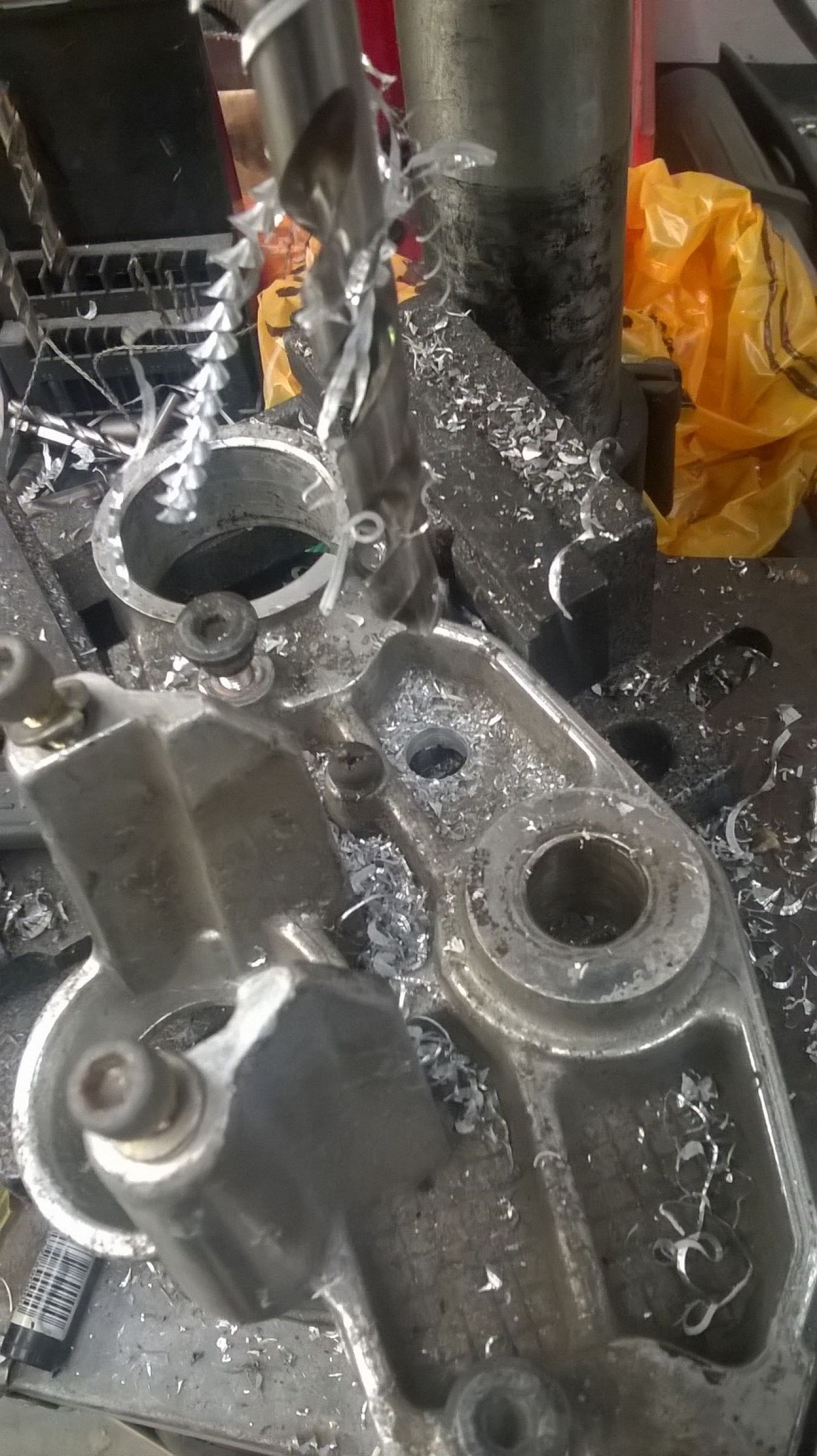

I also have fitted the shock and linkages properly too. I had to drill out the bottom shock mount to fit the larger diameter bolt that the ZZR linkage uses but other than that all pretty straight forward to be honest. I will have to buy a couple of bolts as I hate having mismatched bolt heads (anal I know) and jobs done. For now anyway.
Obligatory drill shot lol

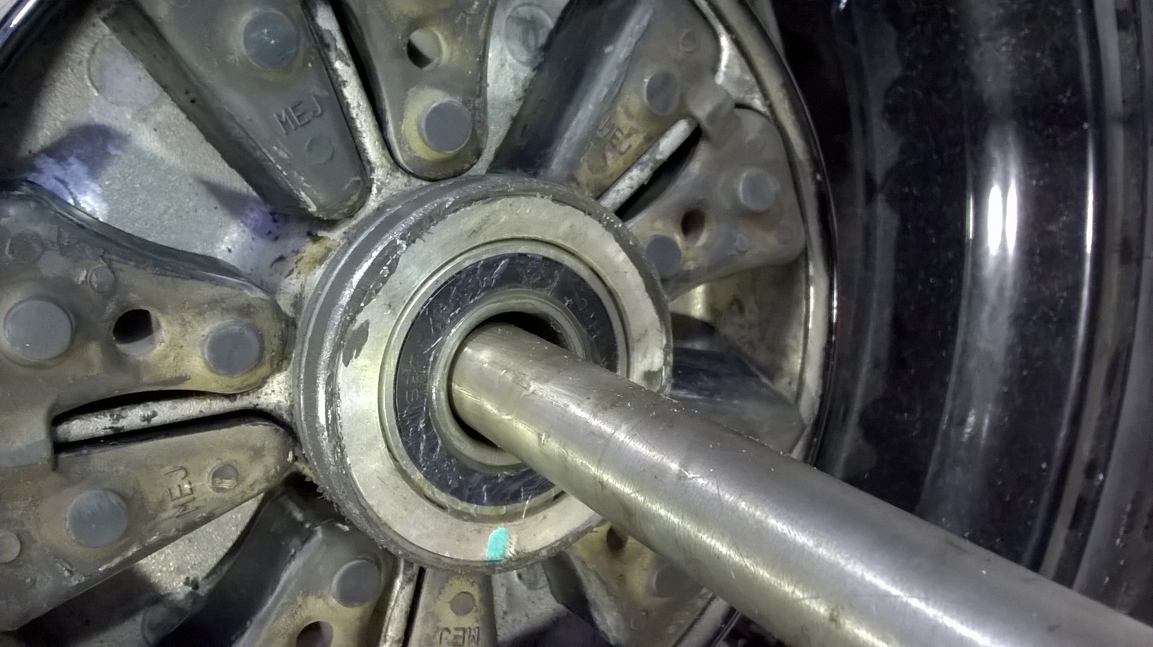

18 Mar 2016 00:13Now that the swing arm is mounted properly it means I can move onto the rear rim. First order of business is sorting out the smaller diameter axle vs the larger axle diameter of CB1300. Easiest and safest way to get over this issue is to fit try and find bearings with the same outside dimensions but an internal that fits the ZZR axle diameter. Off to Saeco bearings tomorrow to see what I can find...............Will keep you posted.

NOW THAT'S AN ARM. :woohoo:
I want to find a neglected KZP to make a street fighter out of. :evil:

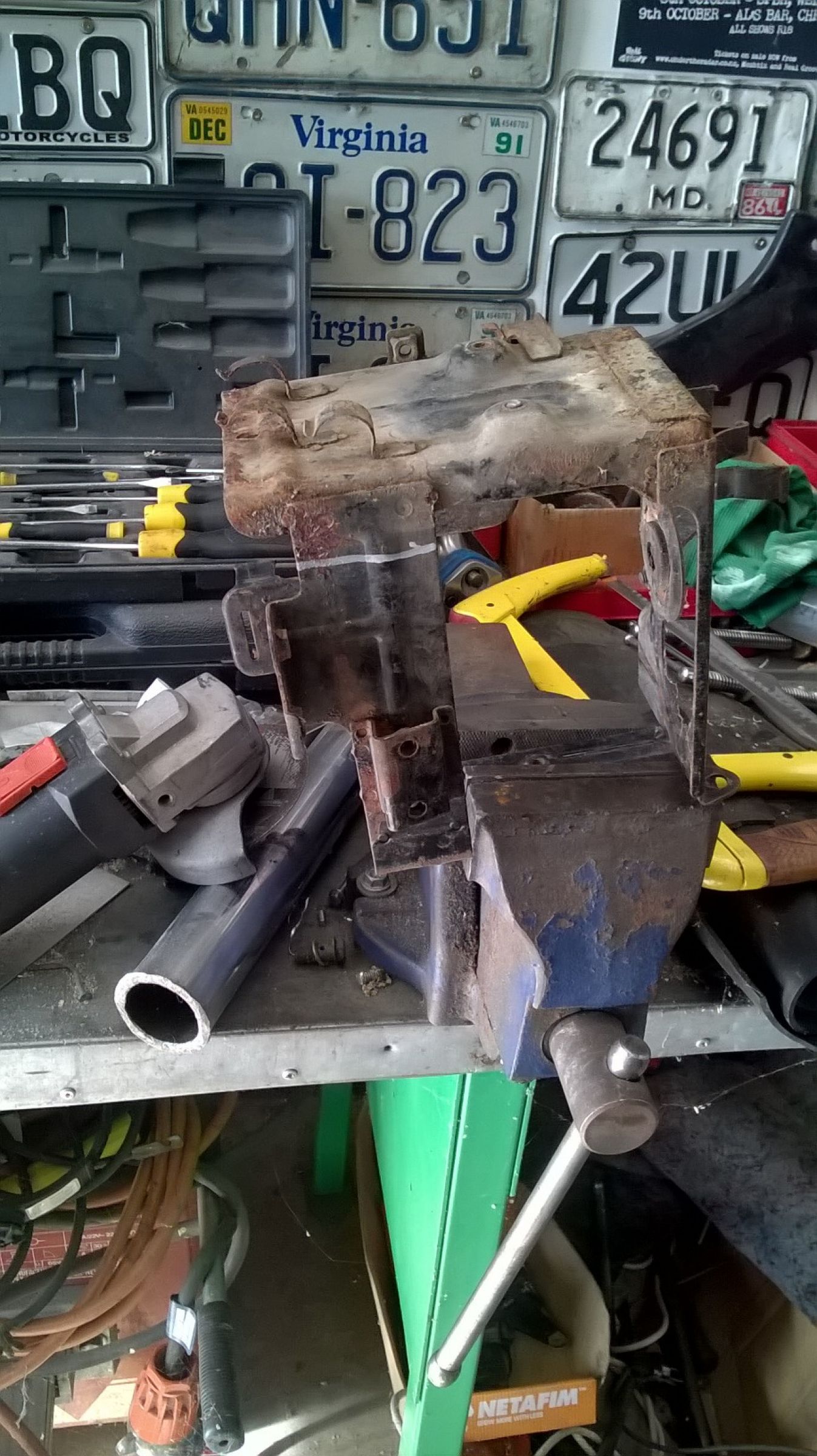

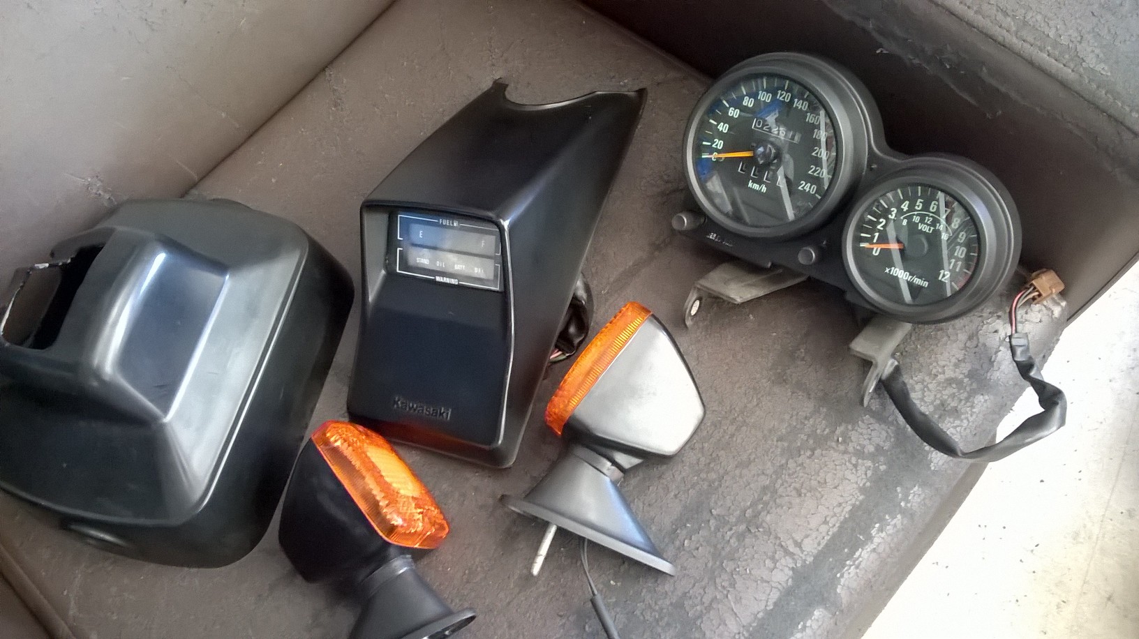

Mmmmm when one goes and sticks bits that don't normally reside in the bike you're putting them in bits that fitted don't want to fit anymore. With the GSXR shock now in place the battery box won't fit anymore. It's about 10mm to deep now so out with the grinder! I will cut out a new bottom tomorrow and we will have a new battery box. Luckily battery technology is heaps better now than in 1983 so I can fit a shorter battery in. Progress. Also finished refurbing and cleaning up the clocks (picture is shit but they look great, honest).

i have always loved that gauge cluster!
nothin like having the back tire lit up and watching the fairing wag around that gauge pack to bring a big ol smile to your mug!
onward and upward,comon man!
