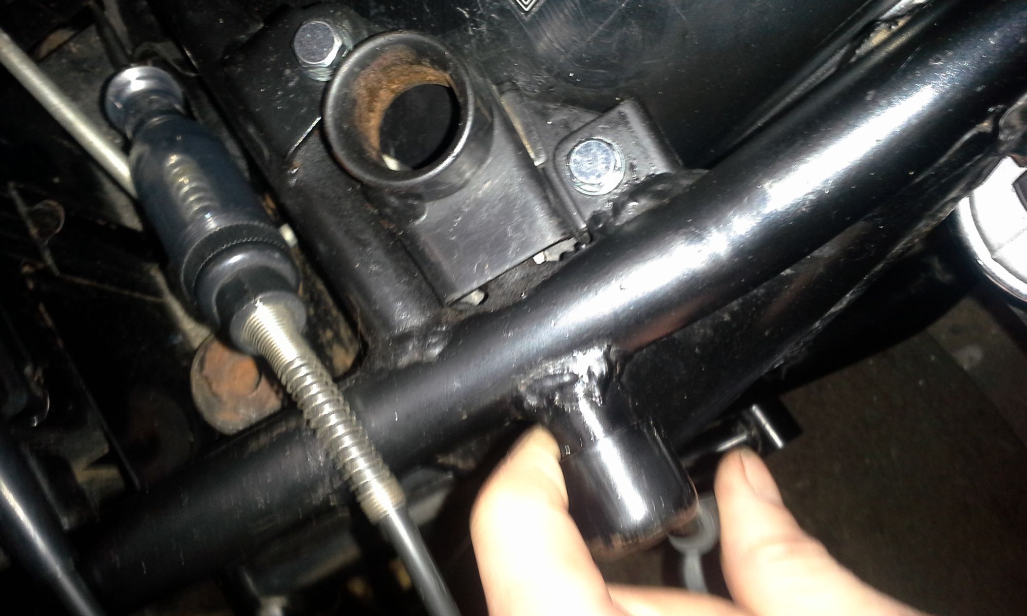

05 Feb 2016 14:45
Here's a pic of kidkawie's 75 z1.
