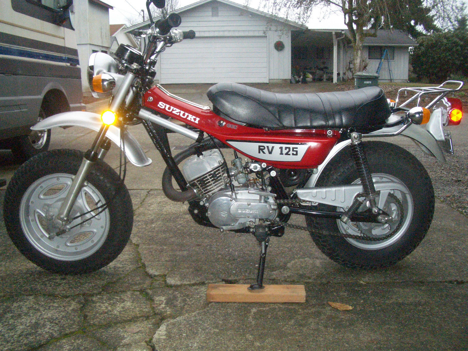

As for the RV - Yes, mines a 75, red with silver stickers on it. Has the fat tires, luggage rack, onboard tire pump, blinkers/headhlight/tailight and the hi/lo range. I rode that from 3rd grade or so til I got my 550 at 19. We got it from the original owner in the early 90s for $300. Had a top end refresher done on it once. Don't have the original blinkers anymore, but other than some dirt and a few dings it looks new. Usually starts with 3 kicks after sitting for a while. Problem with the bike is it's geared very low. Low range you maybe can go 35 mph with it all wound up. In high range you can squeek out 55, but she's just screaming and the tach/speedo is bouncing all over from vibration and everyone can hear you coming from a mile away. I always wanted to find a different sprocket to make it more road friendly. Definitely a unique looking bike. When dad came home with it I was like "what in the hell is that ugly thing?" but now I appreciate it. My folks still have it and my dad will take it out and ride with my mom on her Honda Metropolitan.
I guess the RV is actually worth quite a bit - but I'm not sure why.
Heres a pic - this isn't mine, but looks EXACTLY like mine. About the same condition as well.
