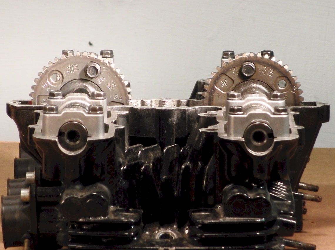

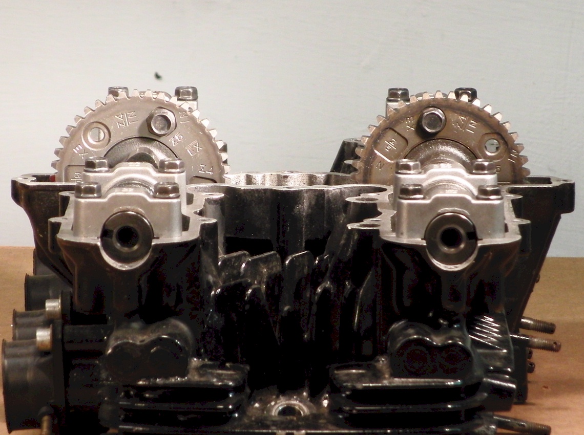

I have made significant progress, just need someone to verify camshaft timing:
The manual also states that the cam caps should be torqued to 104in/lb. There seems to be some conflicting reports on this, can someone verify what is the minimum safe torque spec?
1982 KZ550-C3
- Posts: 8205
- Thanks: 3577
Re: 1982 KZ550 C3 Engine Rebuild
07 Jun 2016 19:11
It's hard to tell from the photos about the cam timing.
1-4 T needs to be aligned on the crank.
EX line parallel to the gasket surface
The appropriate number of chain pins from EX to the IN line on the other cam.
Regarding the torque, 85 in-lbs should be plenty.

More progress to report.I redid the timing, moved the chain one link forward on the crank so that it matched the pics. I am now confident that it is correct. Valve cover, cam chain tensioner, and tach gear installed once again. The ignitions coils are installed. I have filled it with oil and will be looking for any static leaks overnight. I am currently cleaning the clutch cable cover as it still has 30+ years of dirt and chain lube on it. Still need to put the horn back on, clutch cable assembly, shifter, drive chain, exhaust, and the best part: the carbs + boots + fuel tank.

You should read this page, if you haven't already:
gpzweb.s3-website-us-east-1.amazonaws.co...KZZXZR550500400.html
Your earlier post looked ok. It should look like this.
Here's a photo of the sprocket positions.
You may need to open it in a new tab to see it full-size.
