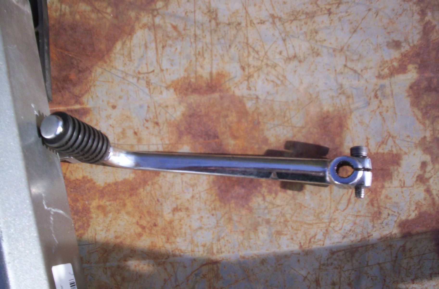

Found the problem. Spline is almost stripped on the outermost grooves. So the shifter is just not catching the grooves in the spline. Any suggestions on how to fix that? Also I found out that my inner right side carb leaks fuel badly. What can I do to fix?
Re: not shifting out of neutral
13 Dec 2015 12:20
Like I said, make the space bigger with a grinder or metal cutting blade in a saw and use a longer bolt in case you snap it off. You can grab the threads and screw it out.
Search clear tube method for the leak.
