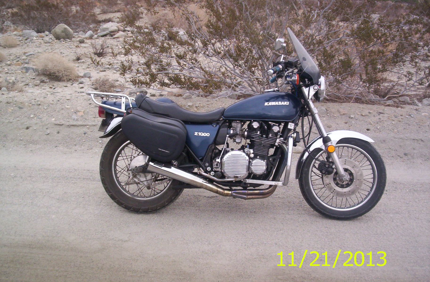

They'll work ether way. It was supposed to improve braking. I did it over 40 years ago. Before that I had only one disk. I can lock up the front tire at speed and have a few times.

Yeah, you have the fender stays. But ask yourself this, why are all the new bikes with calipers behind the forks?

Stands to reason. Instead of pulling on the forks, they're behind them. Mine are H2 calipers I got when I was wrenching at a MC salvage yard.
I like them for the cooling fins and they take the same pucks as the Z1.
