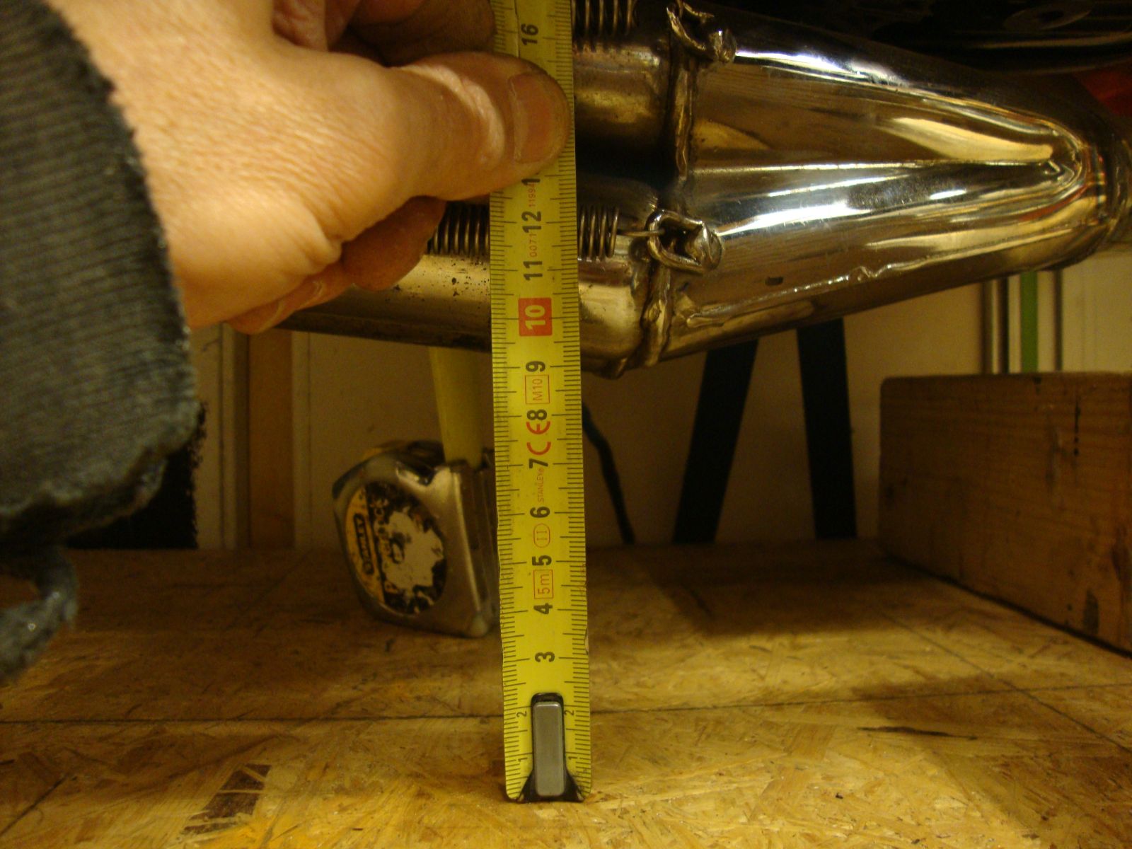

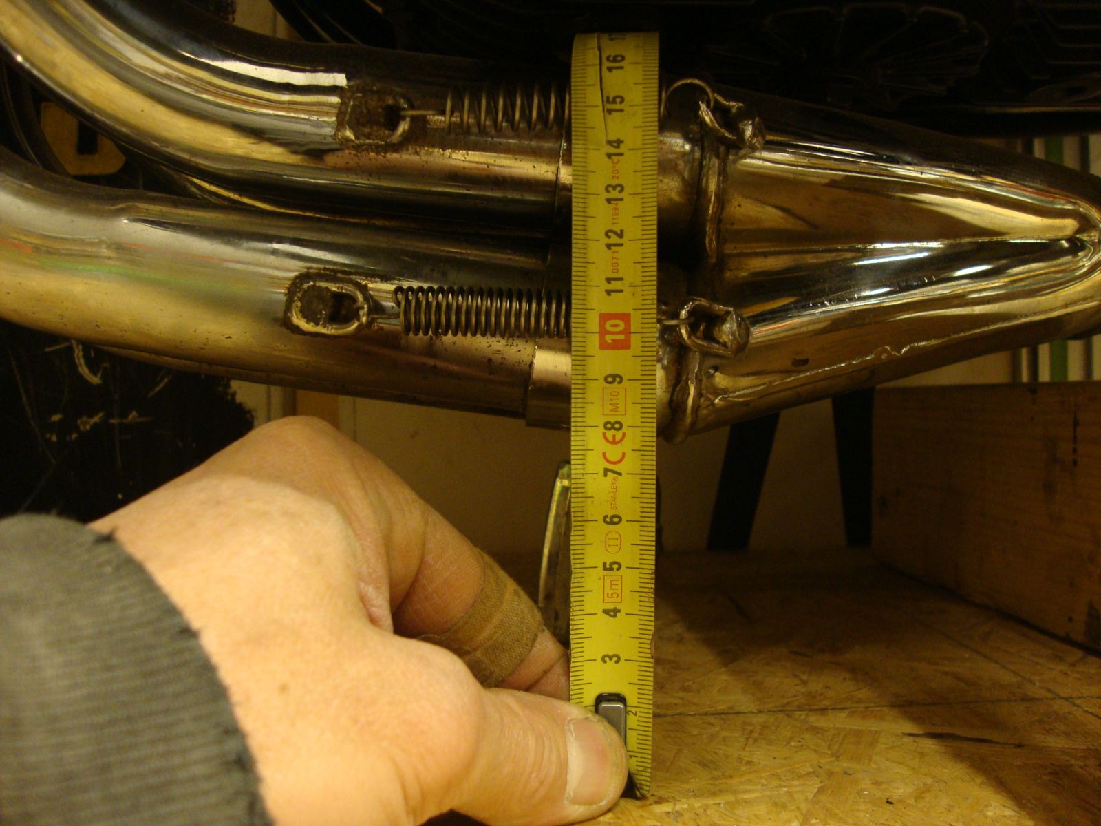

I took some measurements this morning and my ZX9R forks (from axle center to top of tube) are 76mm. I have the early model with the
4pot brake calipers. Later models might be a bit different.
I also took the bike off the paddock stand and measured the ground clearance with it standing free.
8,5 to 9cm. Not a lot! Thats twixt the ground and the lowest point of the (Harris) 4into1. 17inch wheels, YSS shocks (same length and mounted at the same angle as the originals )and rebuilt forks with original springs and fresh 10w oil
Then I grabbed my neighbour and got him to sit his fat 100kilo arse on the bike.
7,5 cm!!!!. Ok Im only around 70kilos and Im starting with a monoseat but still,7,5cm is not a lot.I can take it easy over potholes and sleeping policemen when I see them but for the ones I dont see....!! Or If i slam on the brakes....! My 4into1 is going to become a 3into1 very easily!!!!!!!!!!
Bugger. Have to have a thunk on this.
Anyway,I hope this is of some help to you and gives you something to think about.
