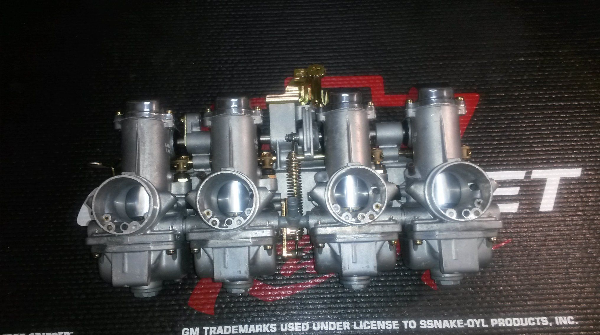

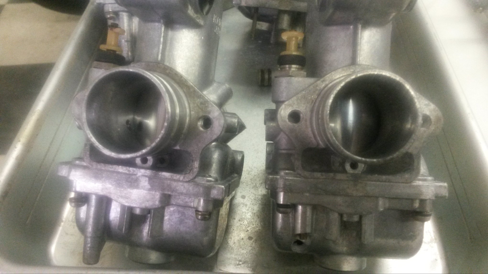

I did think about the 1831 being a little harsh that's why I used carbs I was not worried about.
here's some pics of after the 1220 cleaner and before the 1831 cleaner. I'll get some pics from after the 1831 cleaner

Those look really good, Eddie! I think I need to extend the length of time and drop the temp a little when I'm using the 1220. I've been using 30 mins @ 65*C as my 'standard' exposure. My results have been good, but not as clean as those, judging by the photos above.

eddiem wrote: I did think about the 1831 being a little harsh that's why I used carbs I was not worried about.
It'll be interesting to see what the 1831 removes that the 1220 left behind. I think that SharperTEK probably has to issue that warning on the 1831 for liability issues. As that IS a slightly acidic formulation, if used at full strength for an extended time it probably will begin to eat at aluminum surfaces. Diluted per instructions and neutralized straight after the tank and it's probably not a real-world issue.
Look forward to seeing the post-1831 pics!

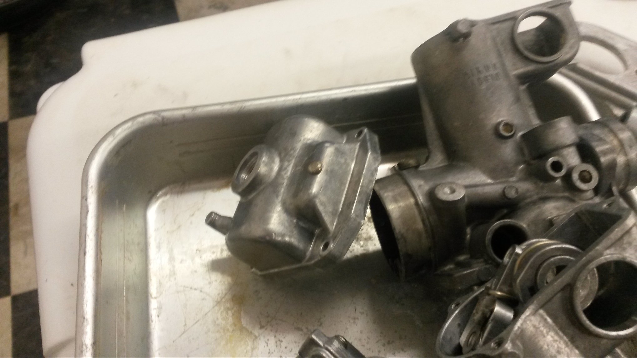

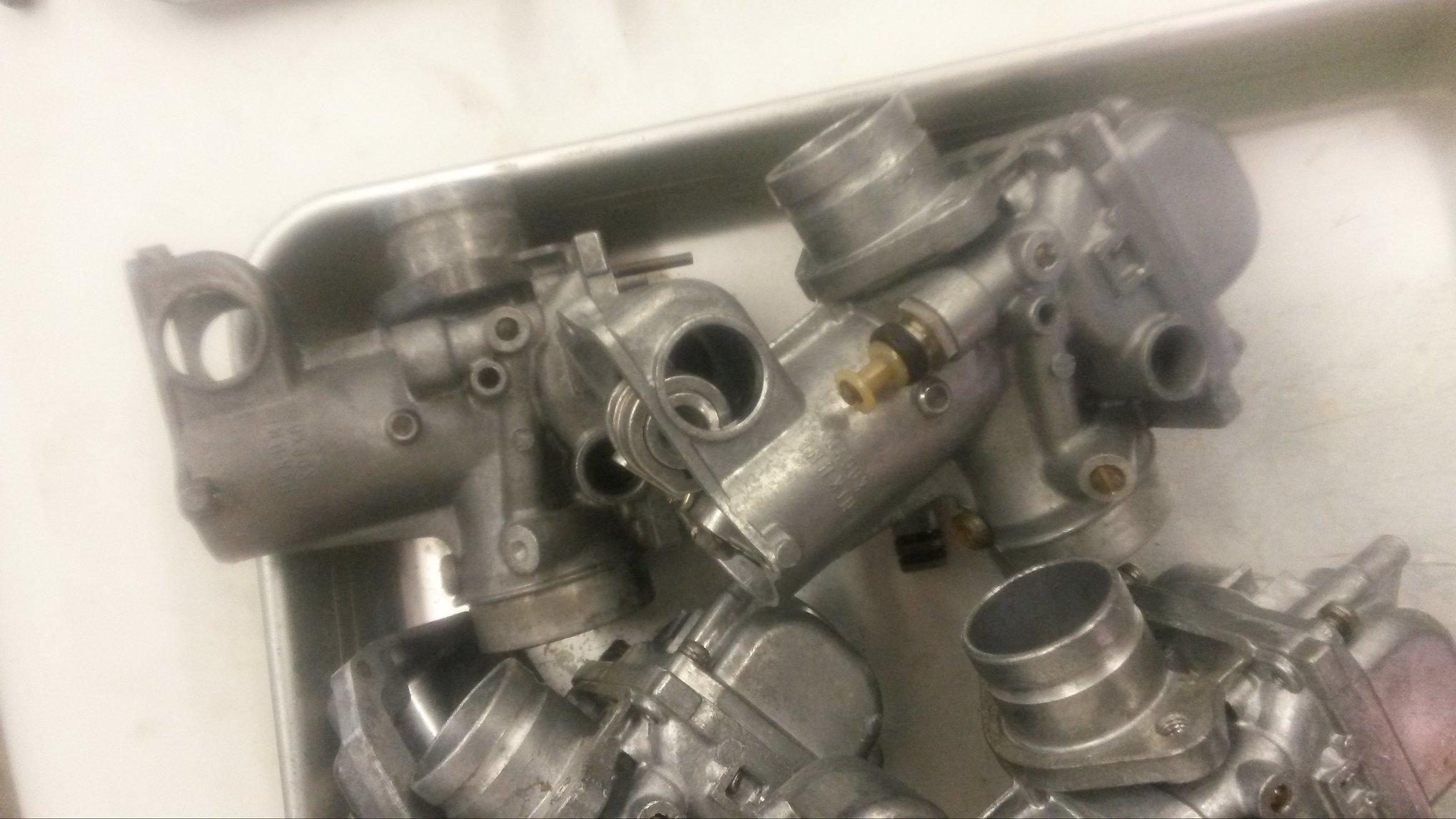

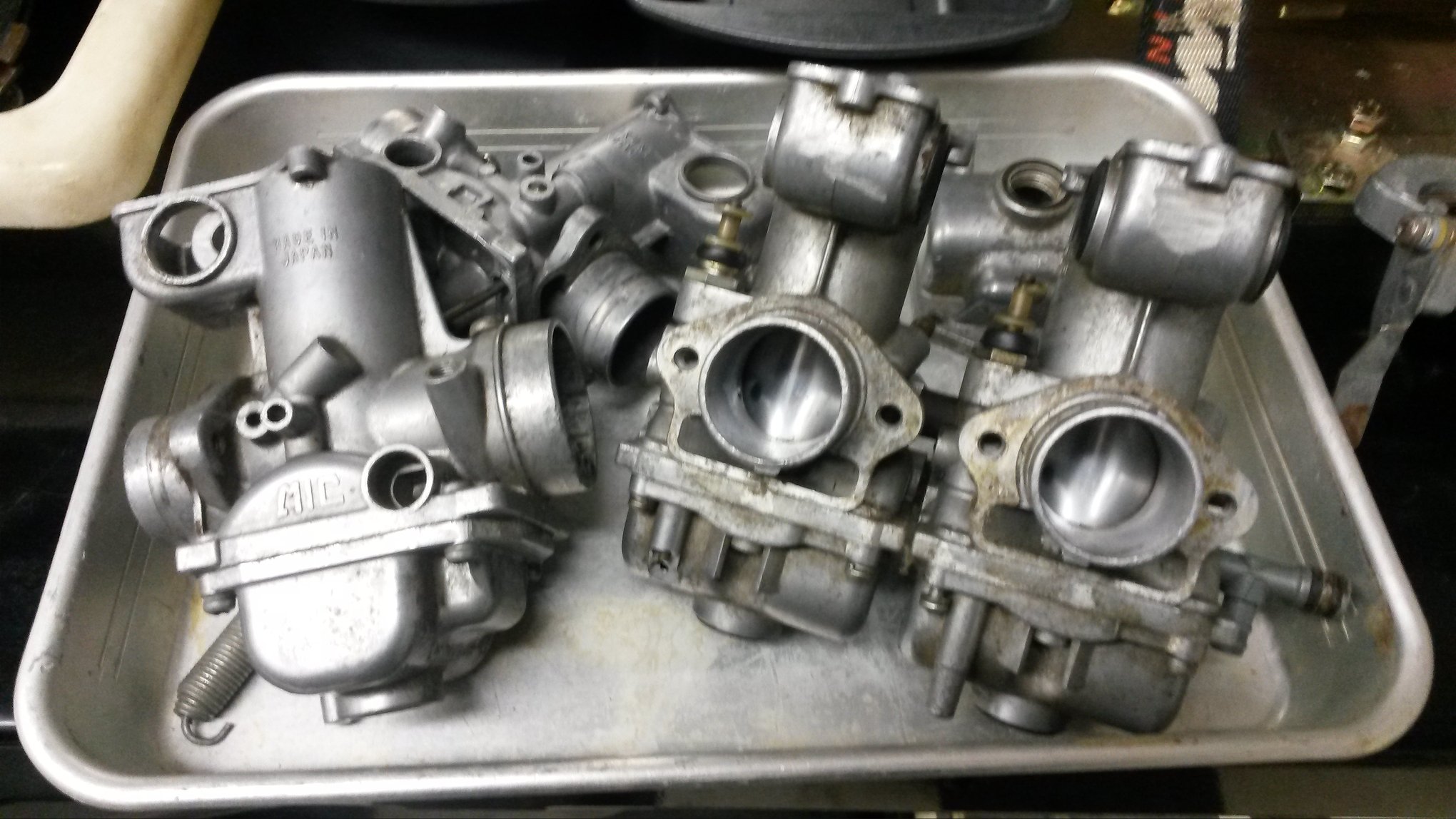

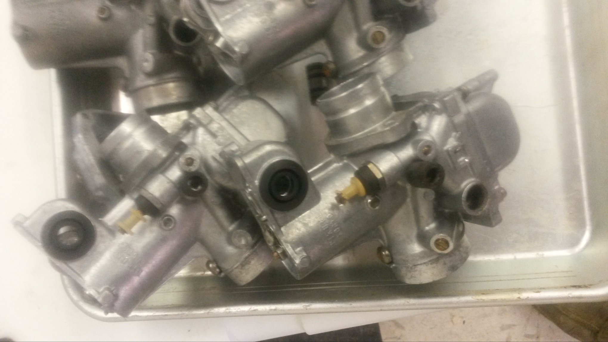

I finely got some pics
there was one card that didn't clean up like the rest
there was very little white crust and I'm not sure if maybe the cleaner caused it

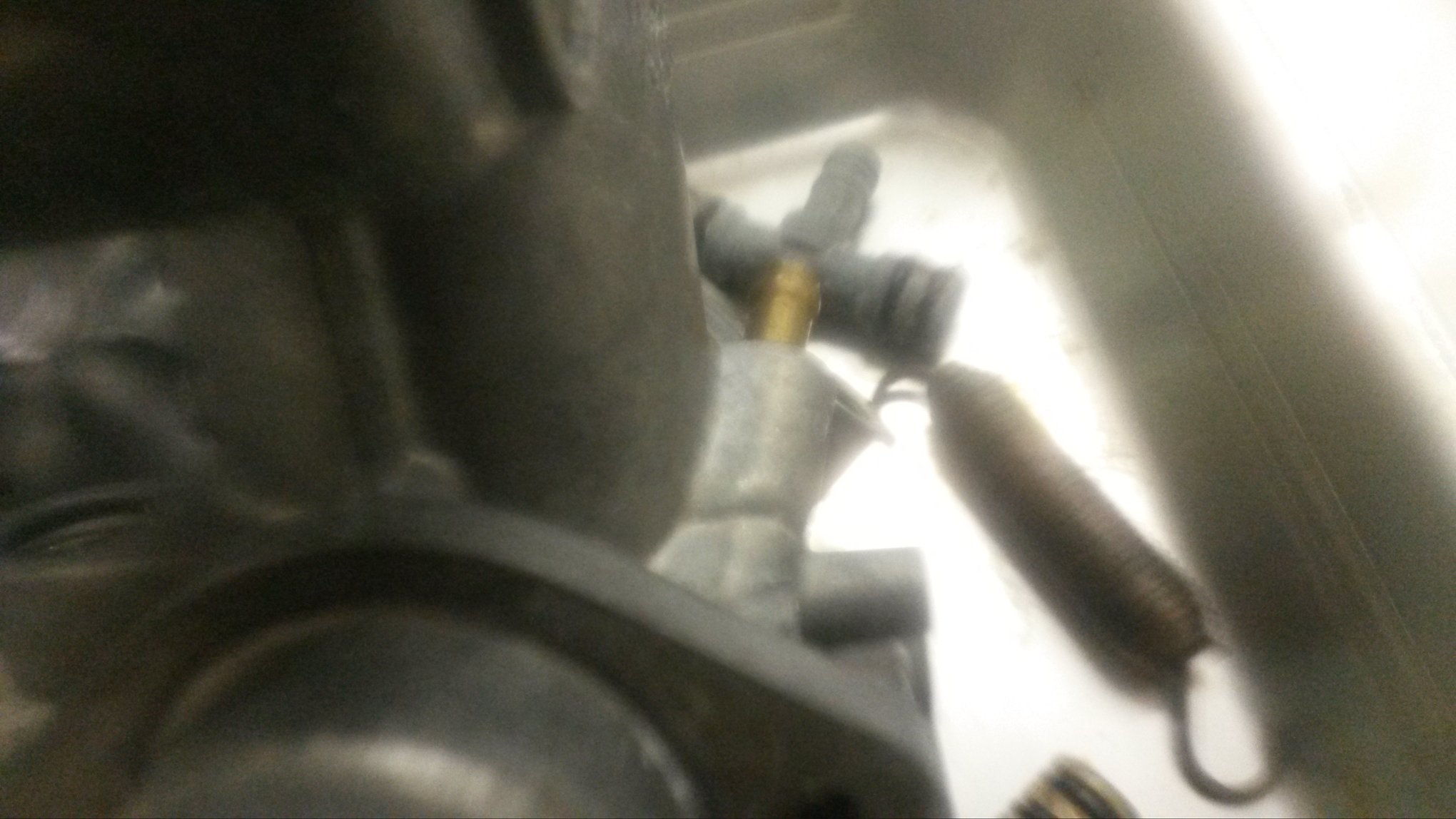

the spring did have some zinc plating on it but the cleaner took it off

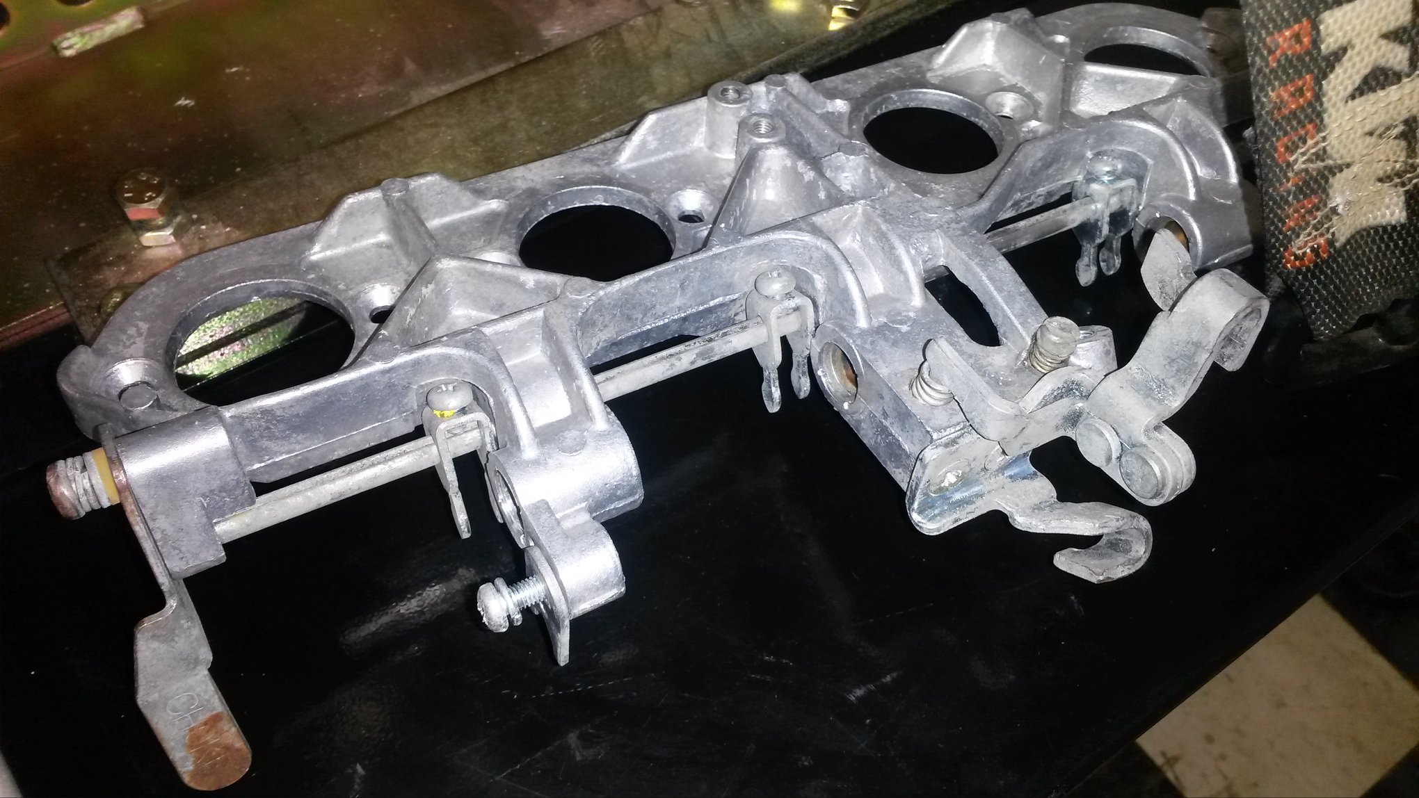

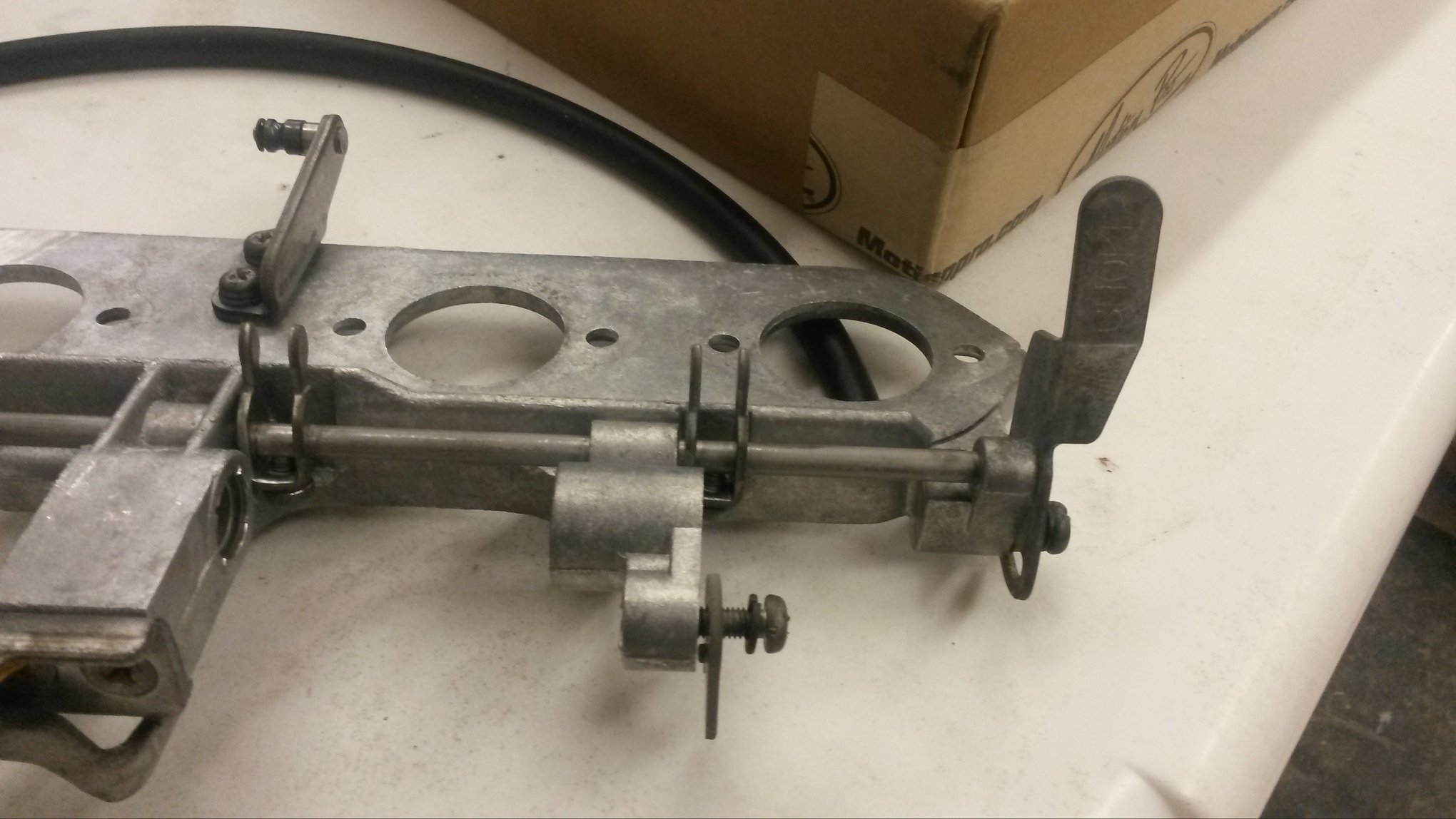

before and after of the carb holders. As you can see the cleaner did take the rust off the choke lever

eddiem wrote: I finely got some pics
Thanks, Eddie.
Maybe that's a 'dead spot' in your tank causing the problem. I'm not saying that you have a transducer going bad, but that the way parts are laid out in the basket can apparently affect the effectiveness of the ultrasonic wave patterns.

I'm going to run that carb one more time. But I think your right on how I loaded it
