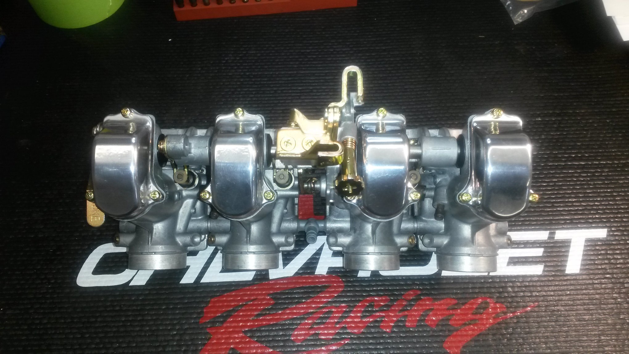

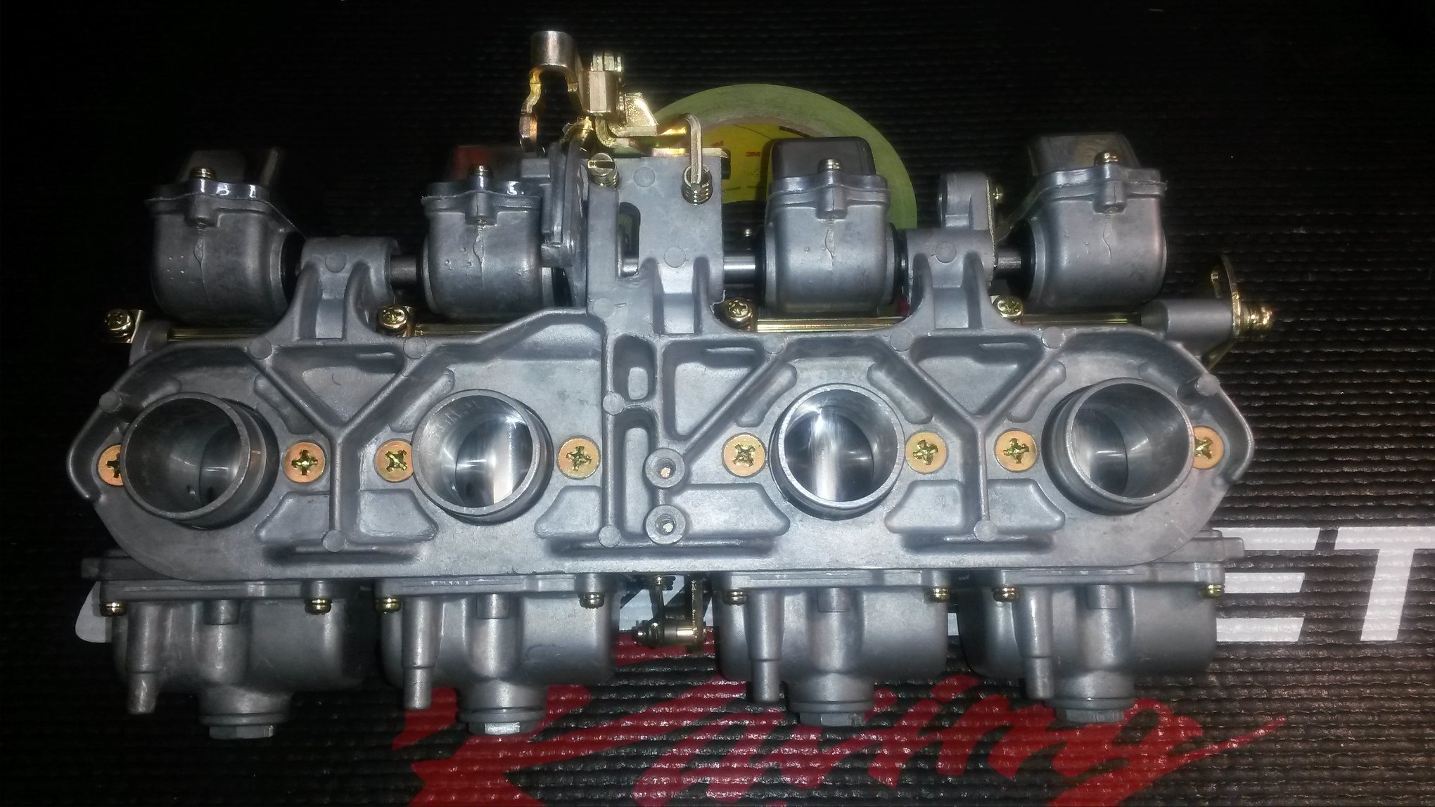

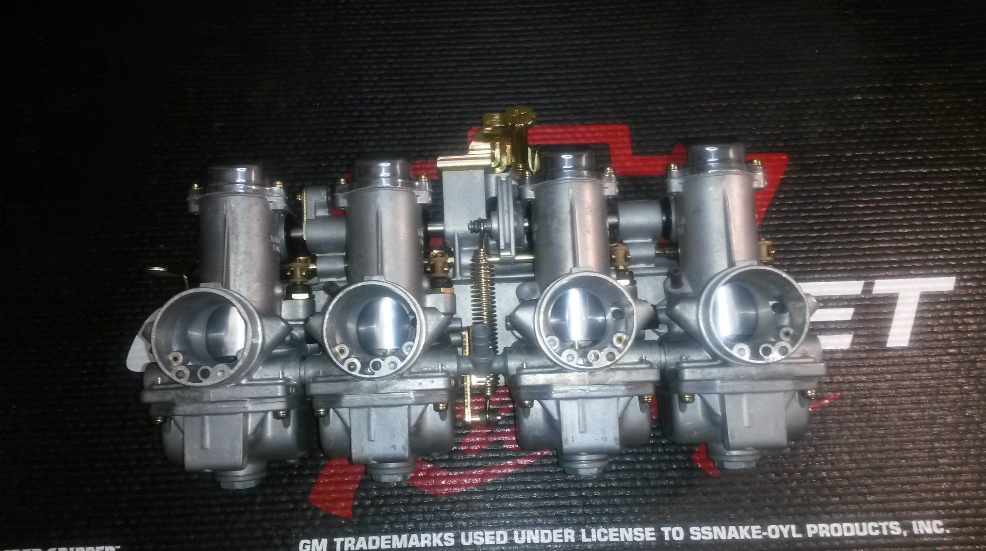

I ran it at 55c and 90mins. They were a set of 29s a friend gave me that were in sad shape but might have some hope. I went back and looked em over good and I have to take back what I said about 1831 doing the same job as the 1220. I forgot I had already tried cleaning them with the 1220 carb cleaner. And they sill had a dark color to them but putting them in the 1831 cleaner for about 20mins at a time I have to say the 1831 cleaner did a nice job. I will take a really good look at them to see if it attacked the aluminum.
On another set of 29's I did in the 1220 cleaner I ran the temp around 50c and at least ninety mins.
If the last 29's would have cleaned up like the first set I would have not tried the 1831 cleaner.
here's the first set I did with the 1220 cleaner.
