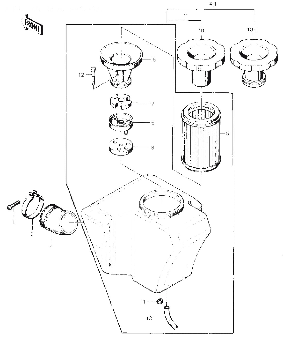

30 Oct 2015 07:18 - 30 Oct 2015 07:19Connectors from carburetor to airbox are dried up and torn. Unfortunate. I think I've read that airbox parts are hard to come by, is that why so many people run pods? Anyways, next up is inspecting the carbs. Should be educational.

I think that most people run pods from the misinformation that they make the bike run better or that it will be cheaper than running the stock air box ( if broken or missing). Since better is really an opinion , lets just say that stock is maximum efficiency ( fuel, power.....) And it is by far not cheaper to rejet and put pods on these bikes. The easiest thing to do is purchase the boots that fit the airbox/carbs new or off ebay. On a side note, looks like you have a real gem in the rough!

Yes.. that bike is too sweet to mod it all out.
And I agree with punisher.... find some replacement boots.
$$$ well worth it.
I have a small fortune in brass from trying to run pods on twins and big four Kawasaki bikes!!!
I'm not 100% sure if I every felt any improvement in power with any pod system I've ever used, except in a crazy custom system on the old Z1, which also used modified velocity stacks with small UNI pods tucked and crammed in front of the battery area.
And I still had many tens of dollars in various jets with that set up plus what seemed like a 100 hours of fab work....so there was ZERO dollar savings.
$$$ well worth it.

I've been having difficulty finding replacement air cleaner ducts but finally stumbled upon them at this site:
mcshop.dk/
. Does anyone have any experience with purchases from this site?

There were posts on the old kawasaki twins forum (dont know if it still exists) that alluded to using fernco plumbing adapters (did it on a 750 twin myself) not sure what size tho. Might be worth looking into

Try here, if its not listed call to see about having them made.
www.claussstudios.com/index.html

03 Nov 2015 04:29Kidkawie wrote: Try here, if its not listed call to see about having them made. www.claussstudios.com/index.html
Really appreciate the tip Kidkawie. He doesn't have the part but I sent an email to see if it can be fabricated.
