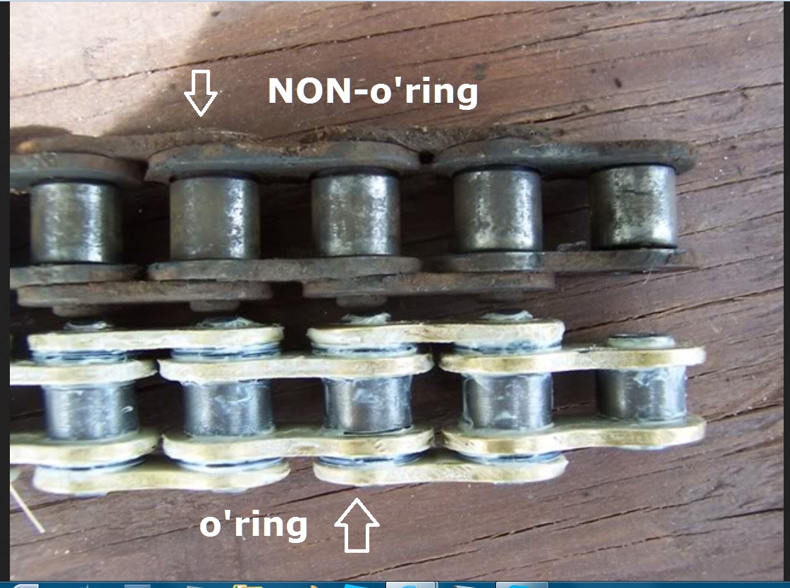

30 Sep 2016 05:26 - 30 Sep 2016 05:28Mikaw wrote:Attachment Chain1.JPG not found
Difficult to tell from the lateral view, but looks like a non-o'ring chain.
Z1 was first produced with a non-o'ring chain and a separate oil supply tank with an owner-regulated pump to control continuous lubrication of the drive chain. It functioned okay, but was messy. And Kawasaki soon converted to an o'ring chain absent the on-board chain lubrication system.
Properly lubing a non-o'ring chain will likely prove to be extremely messy.
The only reason I can think of for using the non-o'ring version is for racing application, especially drag racing, in order to remove the very slight resistance imparted by the o'rings.

Re: Fuel Tank and Pet Cock Problems
30 Sep 2016 06:13
It's an ES630HT chain. Not an oring chain. Might as well use it til it's worn out. Just using a rag and Kerosene or WD40 wiping off the chain is about all you can do to clean, then apply lube. I still have my reservations about motorcycle chain lube after some bad experiences. The only brand I ever used that worked was BG. Hard to find. If not using the BG, I would just lube with regular motor oil.
30 Sep 2016 06:56
I think it is non-o-ring. Izumi (see
www.izumichain.co.jp/bike_e.html
) shows a chain with the ES630HT number. Ed
30 Sep 2016 07:57
Again the knowledge base of the contributors here is outstanding. Thanks for all the help. Here are a few more pictures, Form what i see its non-oring. That confuses me because I could swear when I purchased it 25 years ago I though I was buying an oring. Either way its staying for know because I do know the chain has very low miles on it, and as long as there isn't concern for deterioration form years of sitting i'm gonna clean it and run it. Thanks again.
