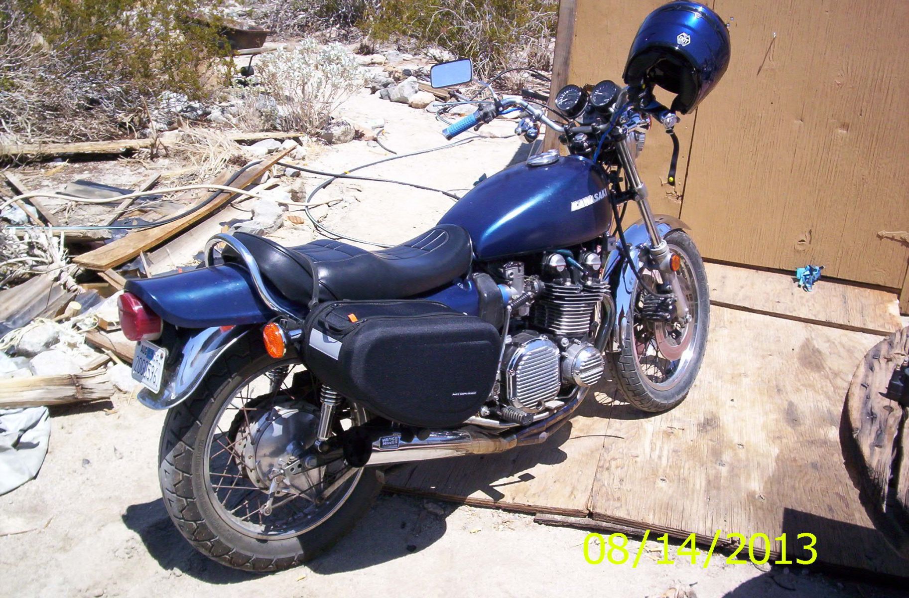

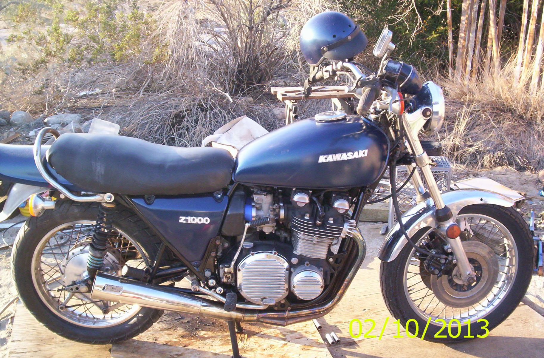

So you snapped off a EZ out. Most of have done it and if they say they haven't, they're ether lying or don't really work on their bikes. :whistle: Very few 30+ year old bikes are as pristine as a FEW here. Bossie sat waiting under a Misquite tree for 15 years. (no garage) :pinch:
The idea is to do one thing at a time. In my case, I didn't have the money to throw at it, so I started by cleaning, painting and polishing things that hadn't been touched in 20 or so years. While doing this I was making a list of things that needed replacing. It got longer and longer. Some things I replaced 15 years ago were still good but not many.
