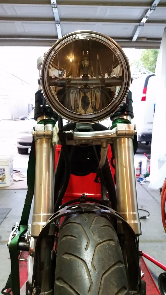

Pictures have to be the correct size. Here is something to help out with that.
As for the headlight, I went this direction
Jon

How's the led headlight work? I tried led fog lights on my car and they were trash! Did you mount the light with the mounts right on ebay?
