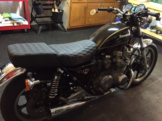

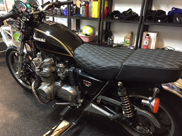

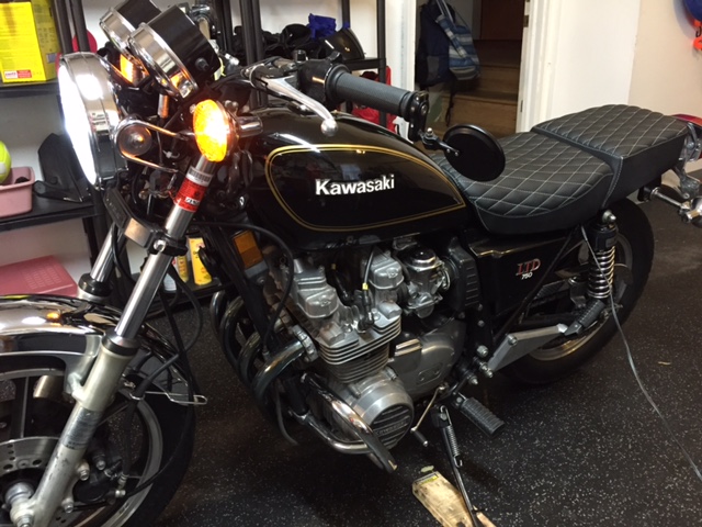

I picked this up in March with 23k miles. valves adjusted, APE cam chain tensioner, fork oil and seals replaced, brake pads, fluid and rebuilt wheel cylinders, rebuilt petcock, replaced fuel filter, air filter, synthetic oil change/filter, spark plugs, battery, sprockets/chain changed to 530 16/38, replaced dash, headlight and tail lamp with LED's. Carbs jetted and cleaned. Handlebars and mirrors changed. Seat redone by Pirate Upholstery. It starts without the choke and pulls like a freight train to the top end. Progressive shocks and springs done by former owner. I have 2 things left to do. Coils are overheating and I will replace them and wires with Dyna 2.2's. The high beam switch seems to be working, as indicated by the instrument panel, but it is not switching the bulb on. I changed bulbs to see if this one was defective, but nope it is not the bulb. High beam was working when installed. If anyone has some troubleshooting advice for this, it would be greatly appreciated. I know very little about electrical circuitry.
