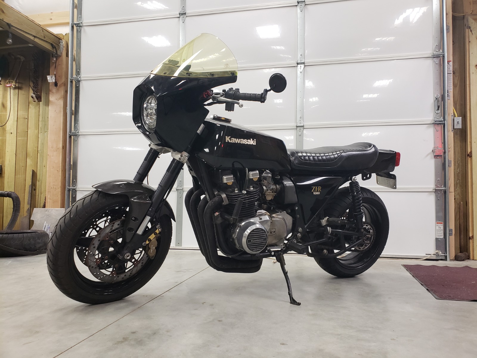

Looks awesome, did you do any frame mods? Have you calculated the head angle with the upgrades?
Had bought a Frame bracing kit, mono shock bolt on kit Susuki GSXR1100 engine conversion kit plus the engine for 250 Euro last year. The Price was a steal.
The Frame in the Picture is an especially Italian Z1000 Frame with stamped stars before and after the VIN#! A very popular frame for the Japenese collectors.
He ask 50 Euro for the Frame but i had no more space in my car to took him home.
The steering head angle is stock and don“t need any mods.

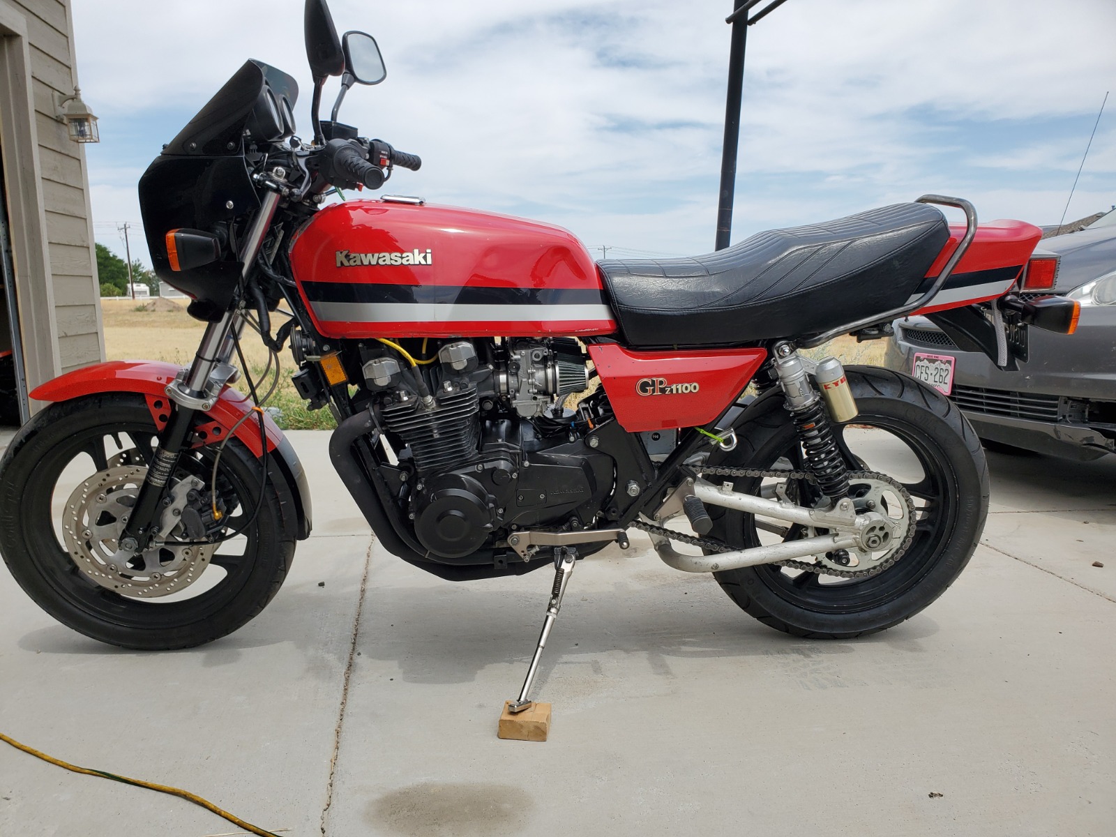

Updated photos with my PMC S1 style rear sets from webbike.jap and my ELR style fairing. Fairing fits perfect, exact replica of the ELR/82GPZ.
Rear sets fit perfect as well, bolt right up and are amazing quality solid as shit.
Desperately need to find a way to upgrade the forks, either re-valve, emulators, springs or replace with late model something. I think with some machining I can squeeze a set of CBRF3 41mm tubes in with out the agro of a full swap out.

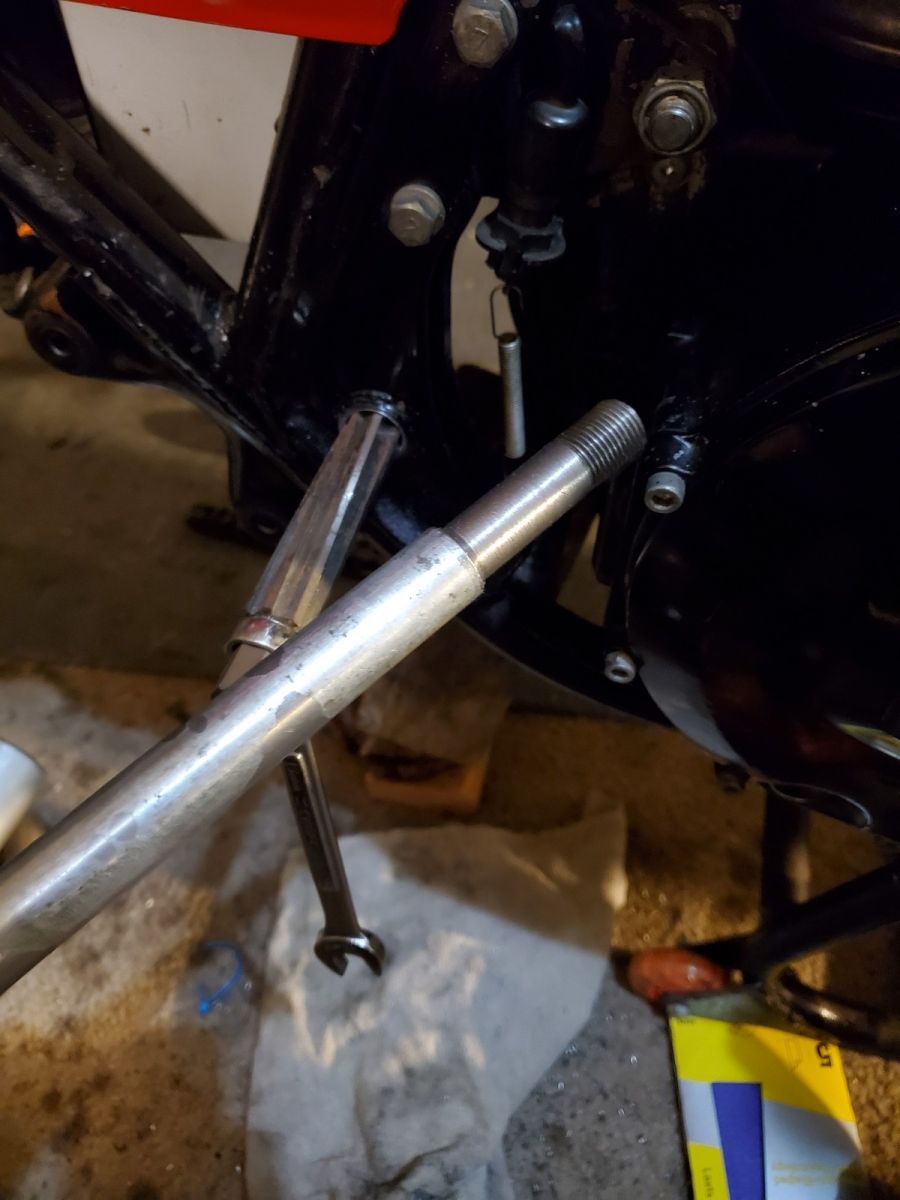

Updating on latest incarnation, I've now fitted a ZRX1100 rear swingarm with a 20mm through bolt up grade. Bored and reamed the frame for a tight no slop fit; used a ZRX1100 rear axle which fit perfectly. I milled the thread end back to fit the 17mm hole and be as tight as possible. Also milled down the head of the bolt so it didn't look funny. It was NOT as straight in fit, I had to mill down the end shims about 2mm so it would snuggly. Also had to file back the swingarm a little too. Pretty happy with the results so far...should handle a lot better without the slop. I had to shim out the S1 style rear sets on the right side to clear the swingarm. Next up is a mounting the S1 replica bars. Probably looking at dropping in a set of performance street cams...nothing too wild at this point. Been looking for a late model bathtub head, but they are rare.

Ride report and update..
So I now have a full summer of riding on the GPZ1100 with suspension upgrades...wow what a difference! I LOVE riding this bike! I used it to commute to
work about 70% of time this summer, and have put at least 5000 miles on it. I ride 600 miles a week commuting, about 60 miles one way on back country roads.
Needless to say I really let're eat on some sections....rock ass solid at 100+ no problems. No slappers, wobbles, pogoing...nothing just stable as can be. Power is wonderful now that I have the Mikuni RS34's dialed in as well. It will pull redline in every gear...roll on is massive no need to downshift. It easily is making the same power as my ZRX1100.
Here is what my current suspension mods are sitting at:
1. ZRX1100 rear swingarm with 20mm through bolt (zrx1100 rear axle) upgrade, hole reamed slightly tight for zero slop per Dr. Gamma advice.
2. 1986 GSXR1100 front and rear wheels, for a 4.0 inch rear with a 150 mounted and a 2.75 front with a 110 mounted.
3. Critical step here..front and rear wheels perfectly aligned < than a 1mm off. They were at least 1 cm off when I first checked it! This is key to fixing slappers.
4. NHK high end steering dampener.
5. S1 style lower triple clamp from Motogp. Stiffened the forks.
6. ZRX1100 rear shocks overhauled by DMR Jamie Daughtery << great guy.
7. Installed RaceTek Cartridge emulators both forks with O rings for a tight fit..1.5 clicks in. per side.
8. RaceTek fork springs.
9. Critical point here, multiple weeks testing the perfect fork oil mixture for this setup. For me 20ml ATF with seal conditioner, 30ml 75-120w synthetic gear oil (for rebound), then the remaining 10-30w synthetic motor oil. Also 10psi air per fork. For more rebound add the gear oil in 10ml increments. Caution this only works in ancient NON cartridge forks. I use this same basic formula in my RZ350 also...works perfect.
10. Change the fork oil often, dirt and grit contaminate it causing leaking seals. I found a way to change the GPZ1100 fork oil in about 15 minutes. I use a an old Hyperlube bottle which as a cone sprout. It fits perfectly into the air valve hole (remove the valve) and I have pre measured the oil and just let drain in. cap it and use a bicycle hand pump to put 10psi in per side. ..and Bobs your uncle.
11.Lasty, a Fork Brace.
