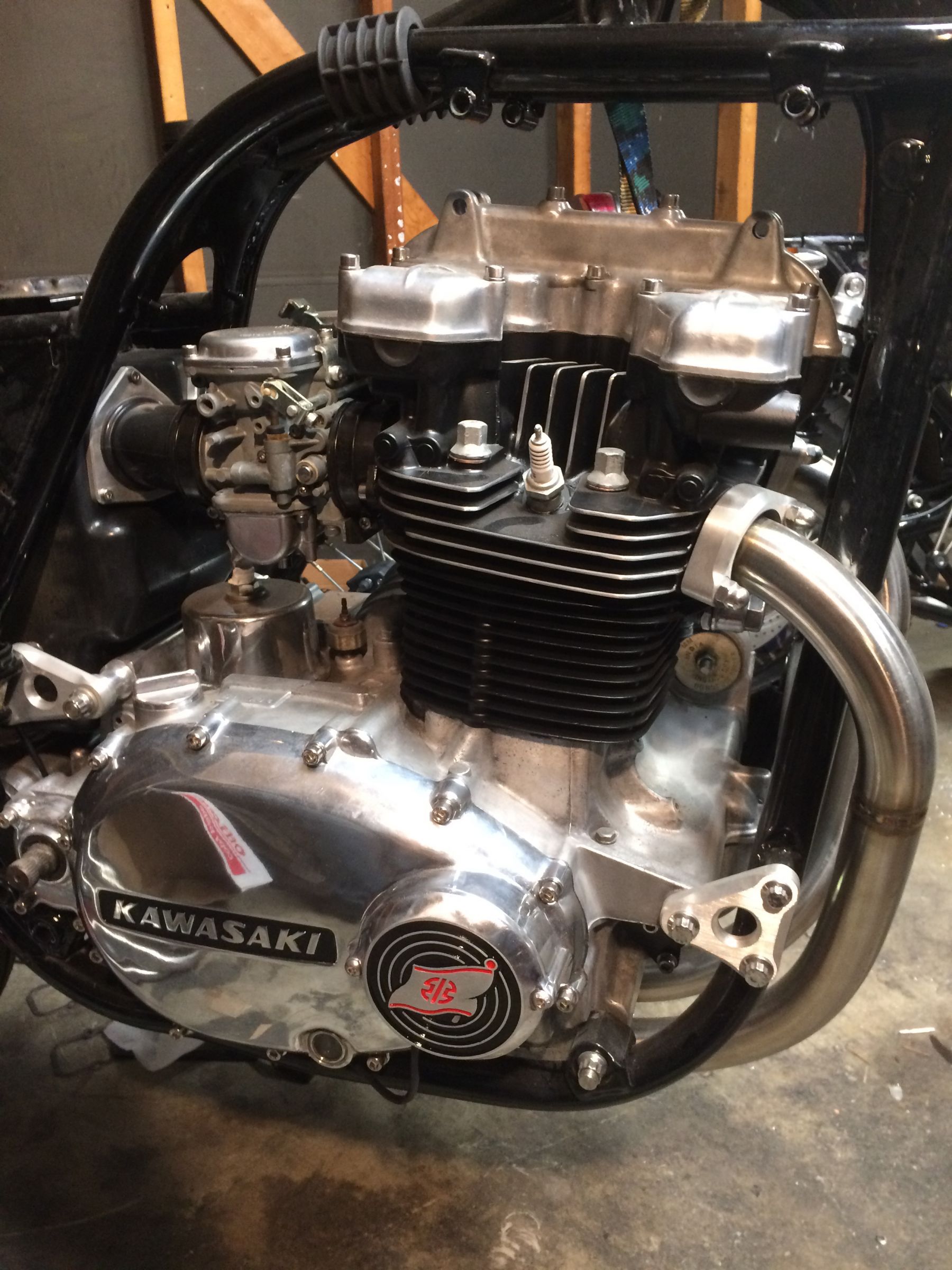

I have been working on this ignition cover for several months off and on whenever I have a short downtime. They're finally finished. I based them off the badges on the early Kawasaki exports. I designed it in CAD and had it 3-d printed so I could take a rubber mold off of it and then cast it in wax. First time ever casting aluminum, which I poured myself, so no photos. I did get some photos of the bronze being poured. They came out ok, but the final casting was very rough and porous. Lots of filing and sanding later they look pretty good.....good enough for an ignition cover. I also made some bronze belt buckles from a mold I took off an KZ650 ignition cover.
