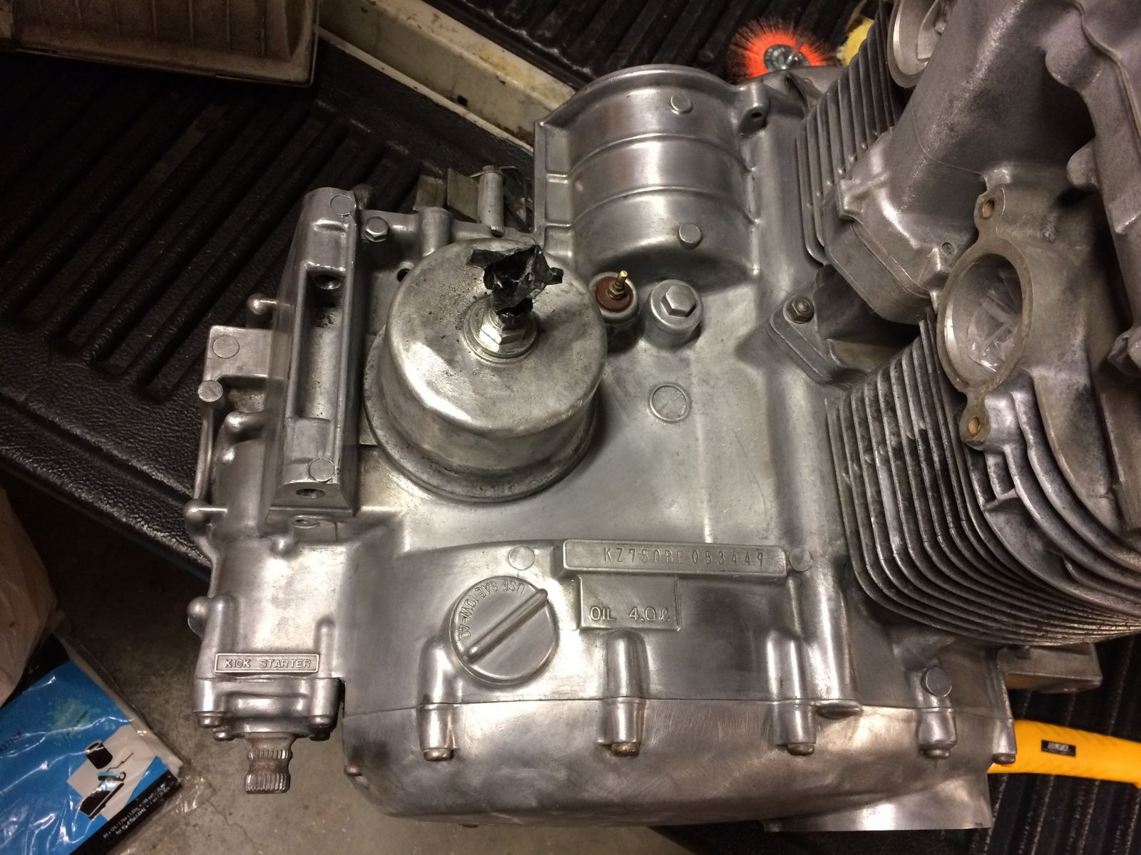

I soda blasted the engine. It did a good job of removing the paint and dirt, but there was some hardcore oxidization under the paint. So I started polishing the cases and sanding the fins for paint. I also discovered that someone has been mucking around with the ignition. Not sure what its out of, but the advancer that supposed to be on this bike is supposed to have a M8 bolt running through it. Instead there was this cobbled bolt, and an advancer with a M6 bolt.(maybe a 400?) Ill have to look at what I
need to run my C5 ignition, but i may need to get a new advancer of ebay. Also when i pulled the starter I noticed the starter sprocket was not in there either, and the chain was hanging loose.... :dry: , i'm gonna pull every cover off this thing to see if there are any other surprises. I should have the jugs and head painted tomorrow which means the polished covers and stainless bolt kit will go on. :woohoo: Ive only got a week before I move to San Jose, and id like this thing rolling in the frame before i do as the project bikes wont be coming until I can find some better housing (read; a garage). I've never tried to find a apartment/house to rent from another state without being there, what a pain in the ass...

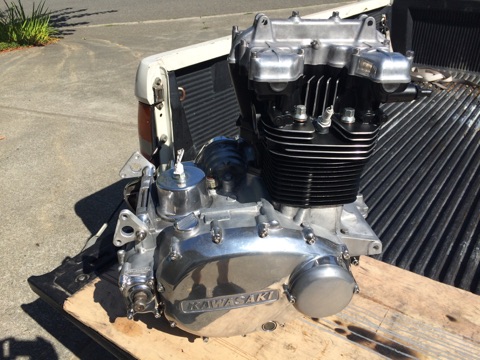

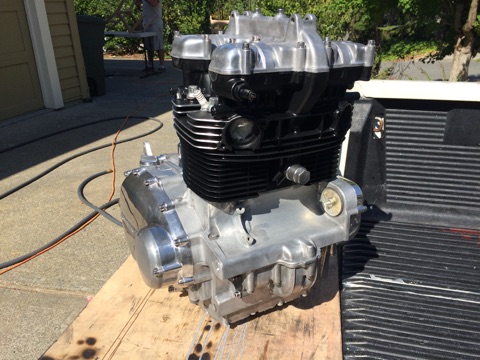

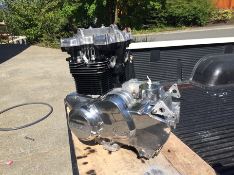

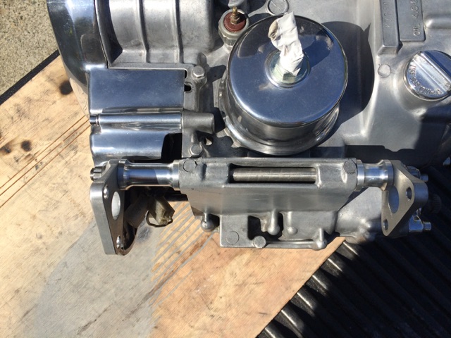

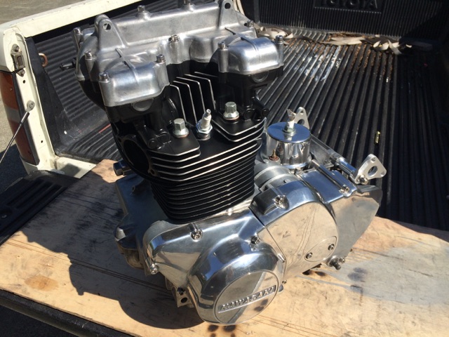

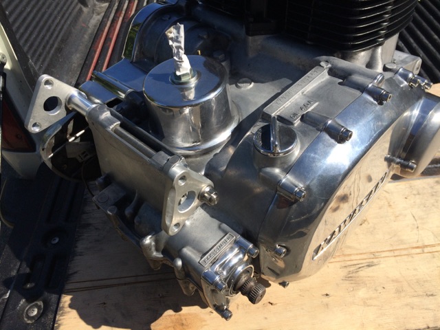

got a little photo happy, but im so pleased with how it turned out, and even more pleased I don't have to polish anymore. My custom bolts/spacers came in for the close tolerance motor mounts as well.
- 80B4
- Posts: 447
- Thanks: 105
Re: Saving a 1980 750 twin.
20 Aug 2015 19:29
Clean, the top rear mount plates are good. If people take the time to look, it's good to give them nice details to find.
