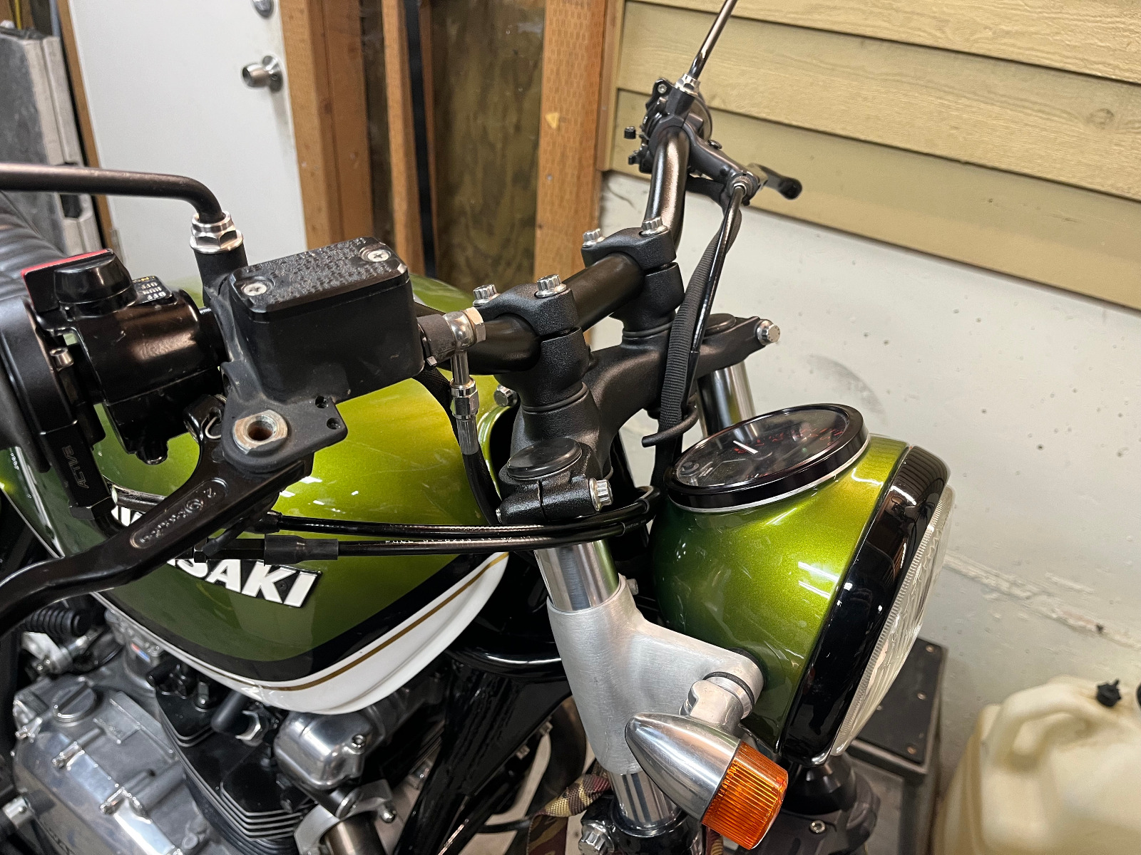

New bars came in and the owner is happy with them. These gold ones were $50 cheaper than black and I was going to paint them anyway to cover up the Rizoma logo. I went ahead and shortened the throttle and clutch cables, machined new ends and ferrules in stainless. Soldered with stainless specific solder and flux and its good to go.

attempting to reign in my OCD... its not going well. I didn't like the black painted axle adjusters so I remade them in stainless.

Clamps powder coated and bars painted. Also added some Woodcraft bar end sliders, installed shorter brake hose and fresh brake fluid. These handlebars have a really thick wall so there was no way I was going to be able to internally route the wires even if I wanted to. I put on some fresh woven heat shrink and routed them along the brake/clutch lines. It looks OK, but not my favorite. Just needs an oil change and a shine up and this suckers ready for some better weather.
