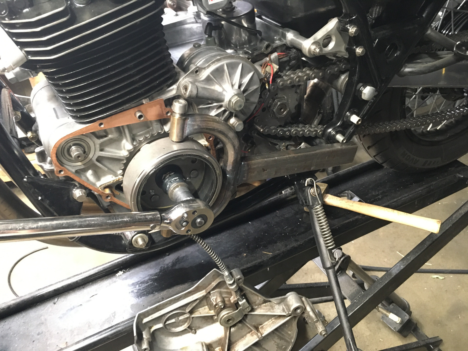

Changed out the starter clutch this weekend. This really is a crap design from Kawasaki. I pulled out an old starter clutch that had only 1000 miles on it since full rebuild and one of the springs was already deformed. and the engagement surface already had some roller marks.
Instead of the mickey mouse crap i have been doing to hold the rotor I finally made proper rotor holder. Makes it so much easier to remove and install the rotor.

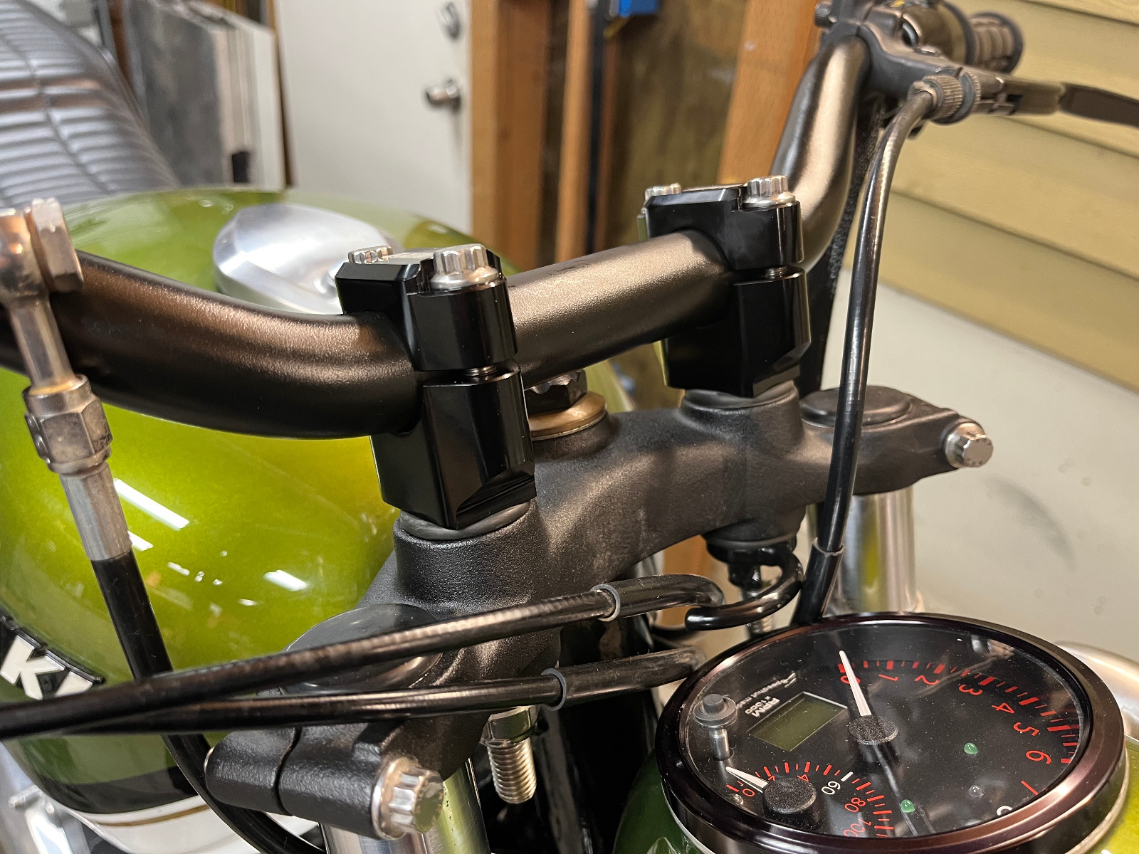

I sold this bike to a good friend a couple years ago. He wants to change up the bars and since its back in the shop i'm gonna update a few things.
First up is a fat bar conversion. I had these bars sitting from a different project and they seem like they will work here. I sand-blasted and painted them with Gunkote. The Pro-taper fatbar clamps are too modern billet looking so immediately after unboxing them threw them in 4 jaw on the lathe... trimmed a bit off, welded, put back in the lathe, grind, weld, grind...etc. They need a bit more work but now they look a lot more cast OEM. They will get the same finish as the top clamp.
Part of the reason for this bar conversion is to have a much stronger handlebar to help prevent damage in case of a crash. I have seen first hand how stout handlebars, like foot pegs, can save a bike from alot of damage in a simple lowside on the street and the track. Because of this I am pretty torn on whether or not to route the handle bar switches internally. Obviously this will weaken the bars. I dont see an elegant way to route the wires without drilling the bars.....ideas?

Waiting on some different handlebars. these were a tad wide and not enough pull back.

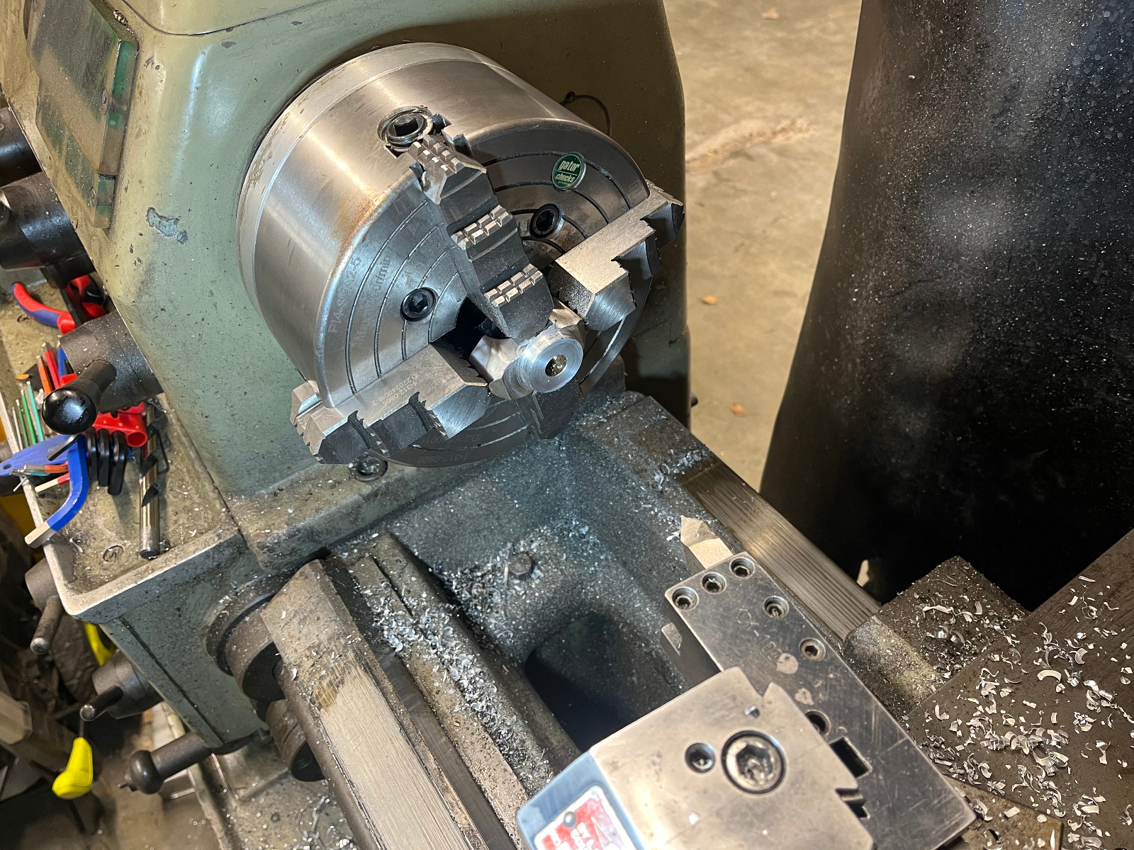

I never really liked the brass washer and yellow zinc fasteners I came up with for the footpegs and shock mounts so I machined some new ones out of stainless.
I don't have a rotary broach for my lathe, but I came up with a crude method of sharpening an allen key and hammering it into a properly sized hole in the stock to make an internal hex. Worked remarkably well. Finally fixed the high speed contactor on my lathe so 2000 RPM is possible. Combined with the coolant mister and stainless specific cutting inserts this is leaving a nice tool finish on these screws.(they are still oily in the pic)
I also remade my tach plug for the engine in aluminum with the same internal hex.
