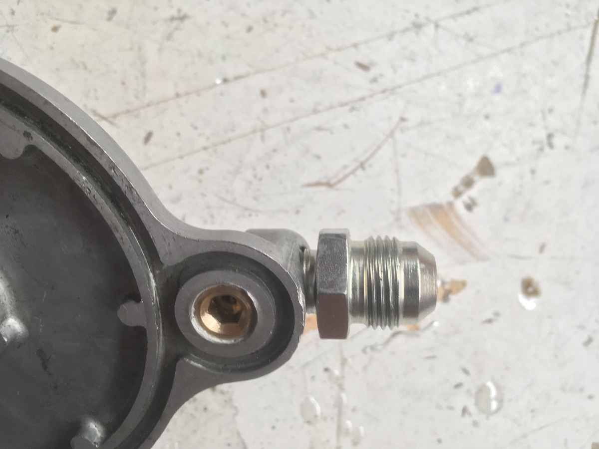

After two years of head scratching, I think this is the easiest way to adapt an oil cooler to this engine. Reclock the filter cover, and tap the cases for 1/4"npt

29 Jun 2020 15:23 - 29 Jun 2020 15:25Perhaps the oil is cooled by spraying it all over the transmission case and letting the breeze take the heat away. A large hole in the top of the case will let the cooled oil drop back into the sump where the pump can pick it up again.
Brilliant engeneering, I say :silly:
Last edit: 29 Jun 2020 15:25 by TexasKZ.
- DoctoRot
- Posts: 2617
- Thanks: 780
Re: Saving a 1980 750 twin.
29 Jun 2020 15:26 - 29 Jun 2020 15:29
Gives new meaning to air/oil cooled!
I actually cracked the edge of that cover trying to hold it in a vise so i had to make some wooden jaws to hold it. The existing holes are already perfectly sized for a 1/4"NPT tap. I used 1/4npt -8 AN fittings. I got steel fittings so I could drill out the 1/4" NPT side to match the 8AN diameter without loosing strength.
Last edit: 29 Jun 2020 15:29 by DoctoRot.
The following user(s) said Thank You: Scirocco
- Thanks: 2260
29 Jun 2020 15:30 - 29 Jun 2020 15:32
Don´t spray such bullsh**, some advance people reading here will trust your kind of words TexasKZ :laugh: :laugh: :laugh:
