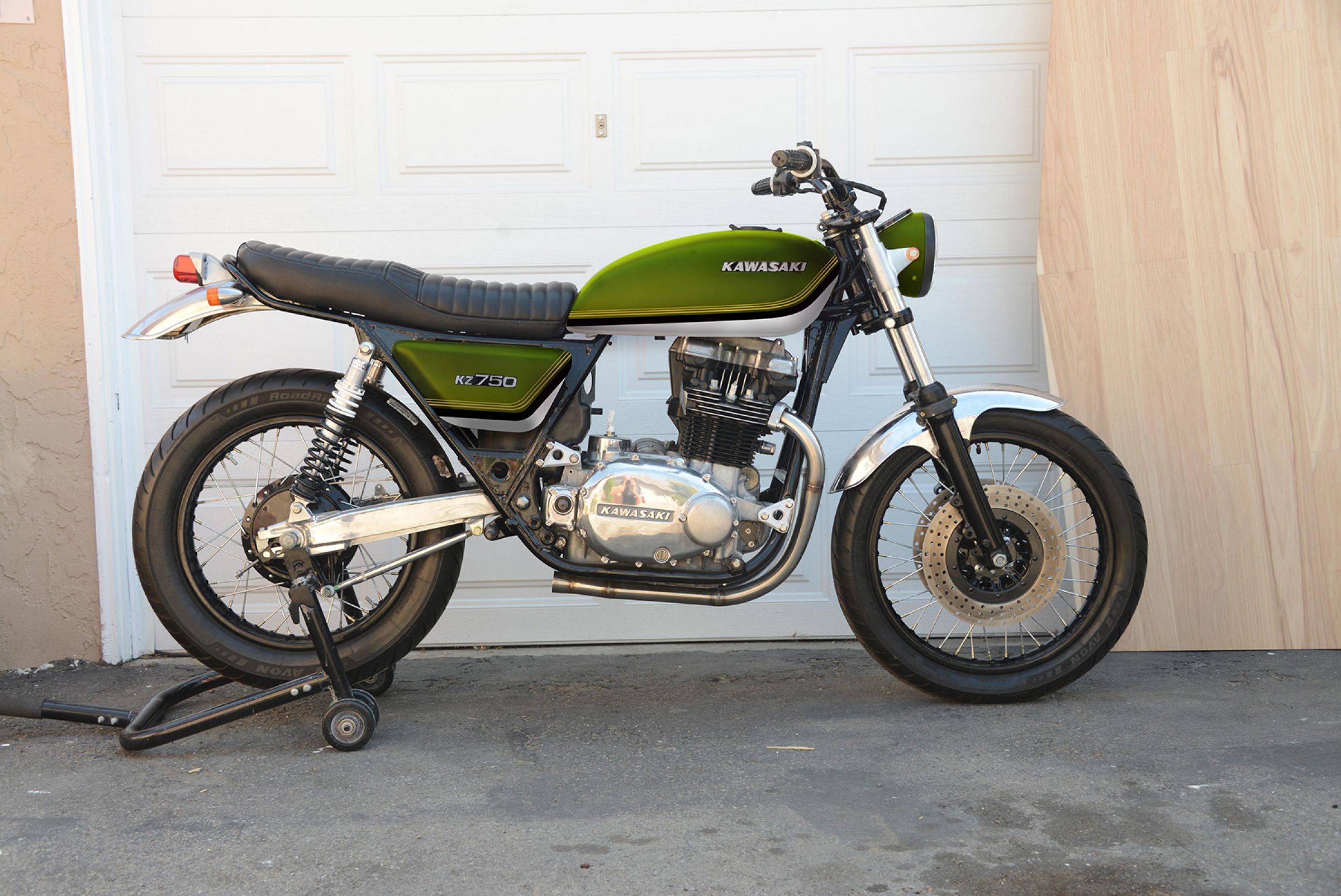

Jesus Doc, is there anything you can't do? I like the red with the white stripe under the tank.

12 Sep 2016 18:31Thanks man, I just like trying new things, and I'm willing to risk failure for a lesson.Bowman wrote: Jesus Doc, is there anything you can't do? I like the red with the white stripe under the tank.

I like your latest rendering, what about continuing the white stripe along the underside of the side cover? Could have the same lightening effect.

14 Sep 2016 17:24Tusch wrote: I like your latest rendering, what about continuing the white stripe along the underside of the side cover? Could have the same lightening effect.
I tried it but since the stripes are on the complicated side it made everything seem too busy, especially with the emblem. I think this is one of the reasons why Ma Kaw rarely put pinstripes on the side covers, and when they did the pinstripes were very simple.

Personally I think that looks great but I get where you're coming from on how busy it could be.
