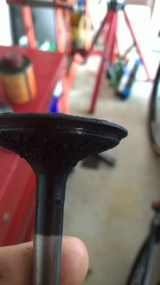

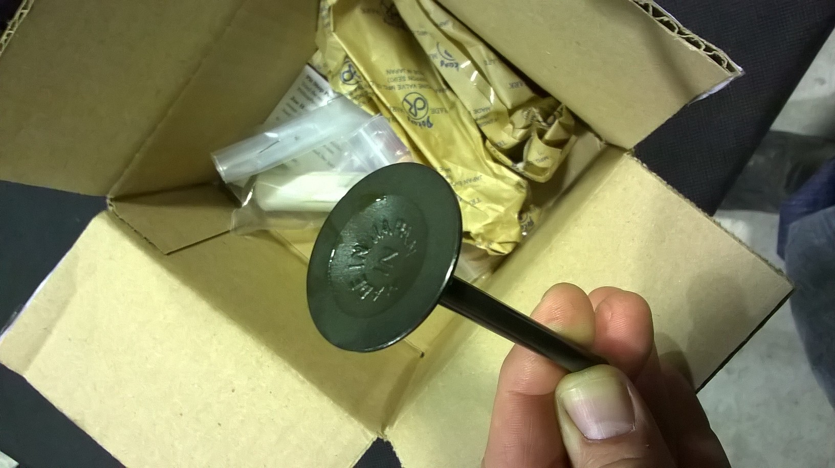

Started in earnest on the engine as all the required parts have finally come in. Had to order new valves, check out the photo of the inlet valve. All four were absolutely poked. Always surprises me how these old girls still keep trucking even when all the bits are flogged to within an inch of their life lol! Head has gone off to the machine shop to get sorted and once it's back it will be assembly time. Exciting!! (well for me anyway)

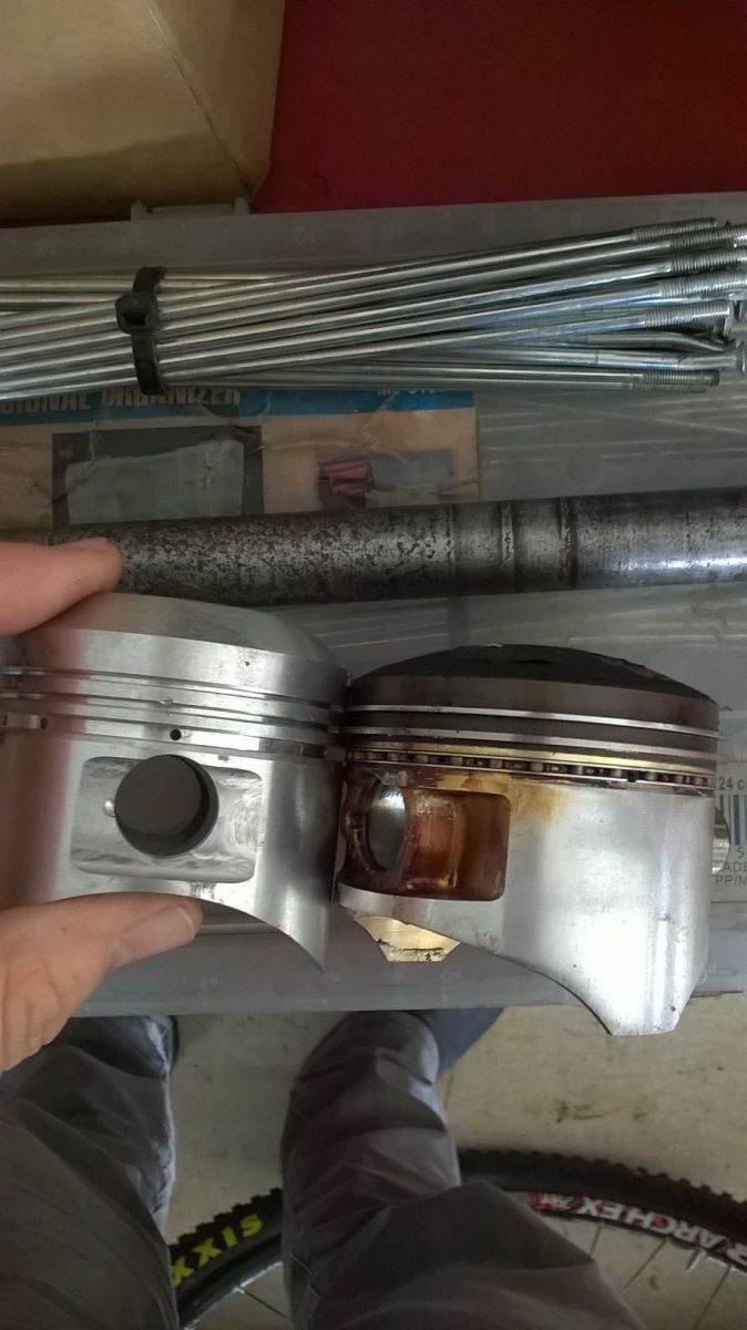

What pistons are those?
- larriken
- Posts: 556
- Thanks: 61
Re: Kiwi KZP
05 Sep 2015 03:15swest wrote: What pistons are those?
They are Moriaki pistons that were made for race kits. They are standard bore size so as to keep them under 1000cc for the race classes but with high comp. I am matching them up to GPZ1100 cams.

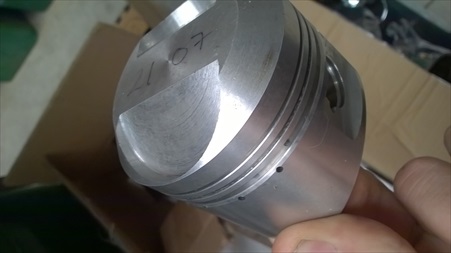

Top pics?

11/1?
- larriken
- Posts: 556
- Thanks: 61
Re: Kiwi KZP
06 Sep 2015 01:06swest wrote: 11/1?
I worked it out that with the cams I am using iit should be 11.5/1
