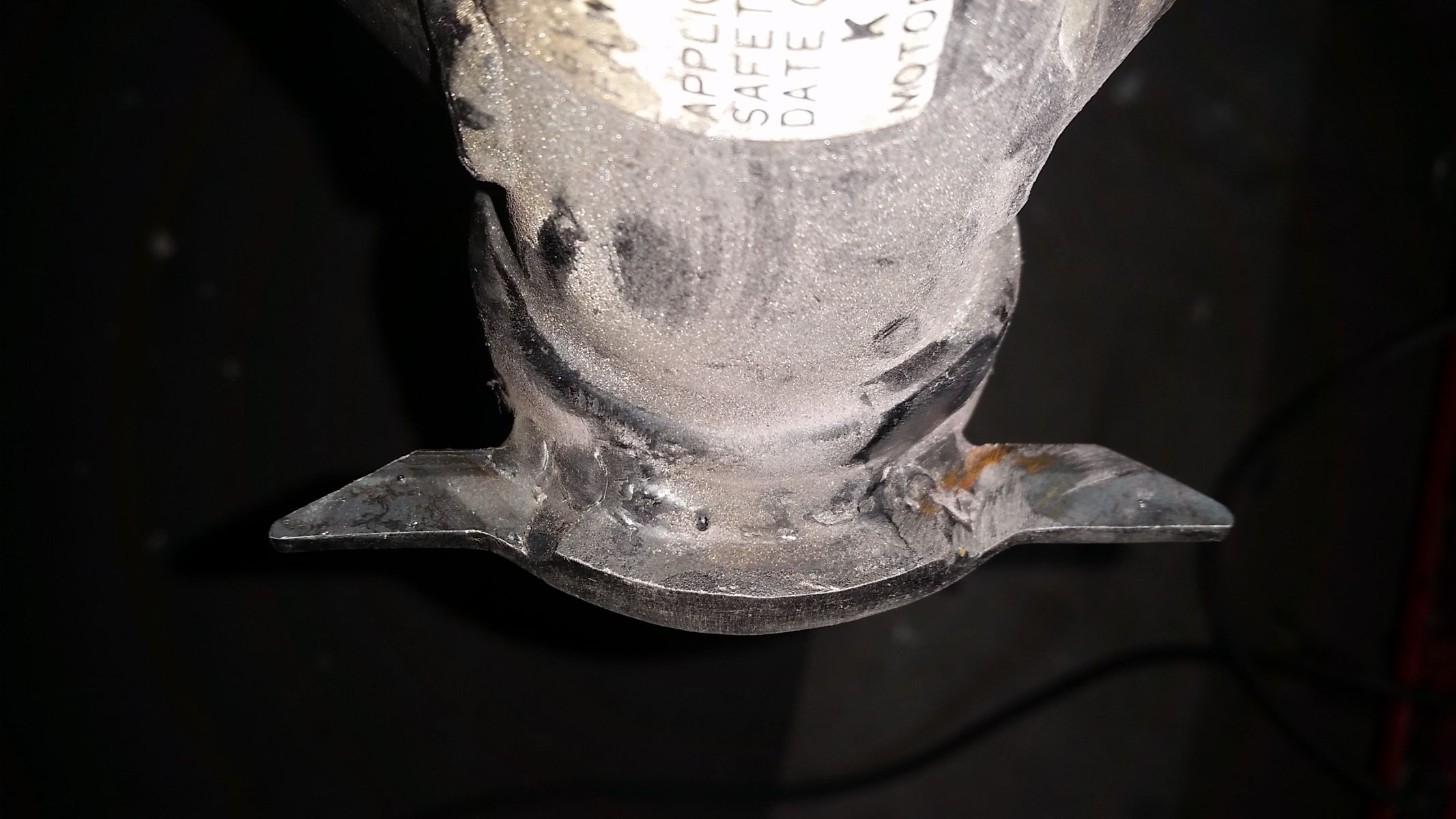

Painted motor looks really nice. I used 98 GSXR 750W USD forks which are substantially wider. I just cut out a piece of steel to lay on top of the existing tab that was welded to the tube and welded it on.

Kaw-a-holic The bandit forks are wide enough its the the triple clamp angle between stem and forks legs.
Needs a larger of set. maybe this.

Sorry gtrain, I was just sharing how I kept my forks from hitting the tank. I modified the stock steering stop.

OK kaw-a-holic thanks for the input, I've swooped the trip clamp for a 1200 ZG voyager clamp, had the original stem fitted and the fork tube holes machined out 2mm to take the suzuki forks, The top clamp sits a little higher,
and I'll have to use 1" handle bars !
