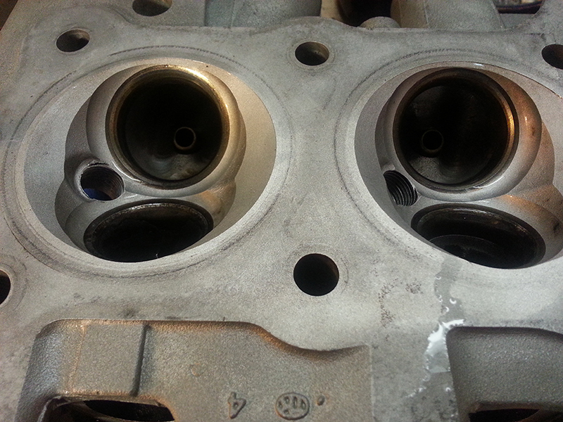

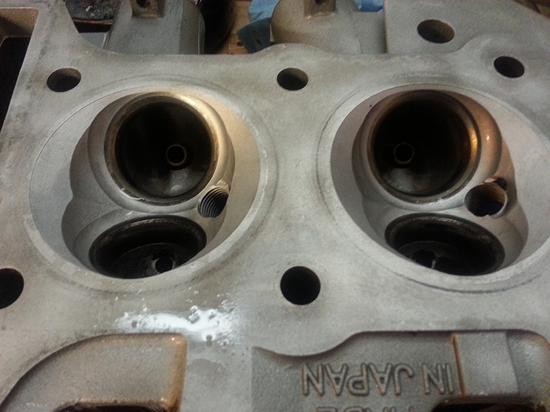

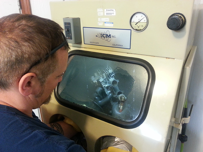

We got our wet blast machine up and running at the shop. This thing is amazing. No toxic chemicals, no dust and makes quick work of carbon buildup and other junk. Dave did the first go at the valve head. I'll be doing some touch up this weekend.

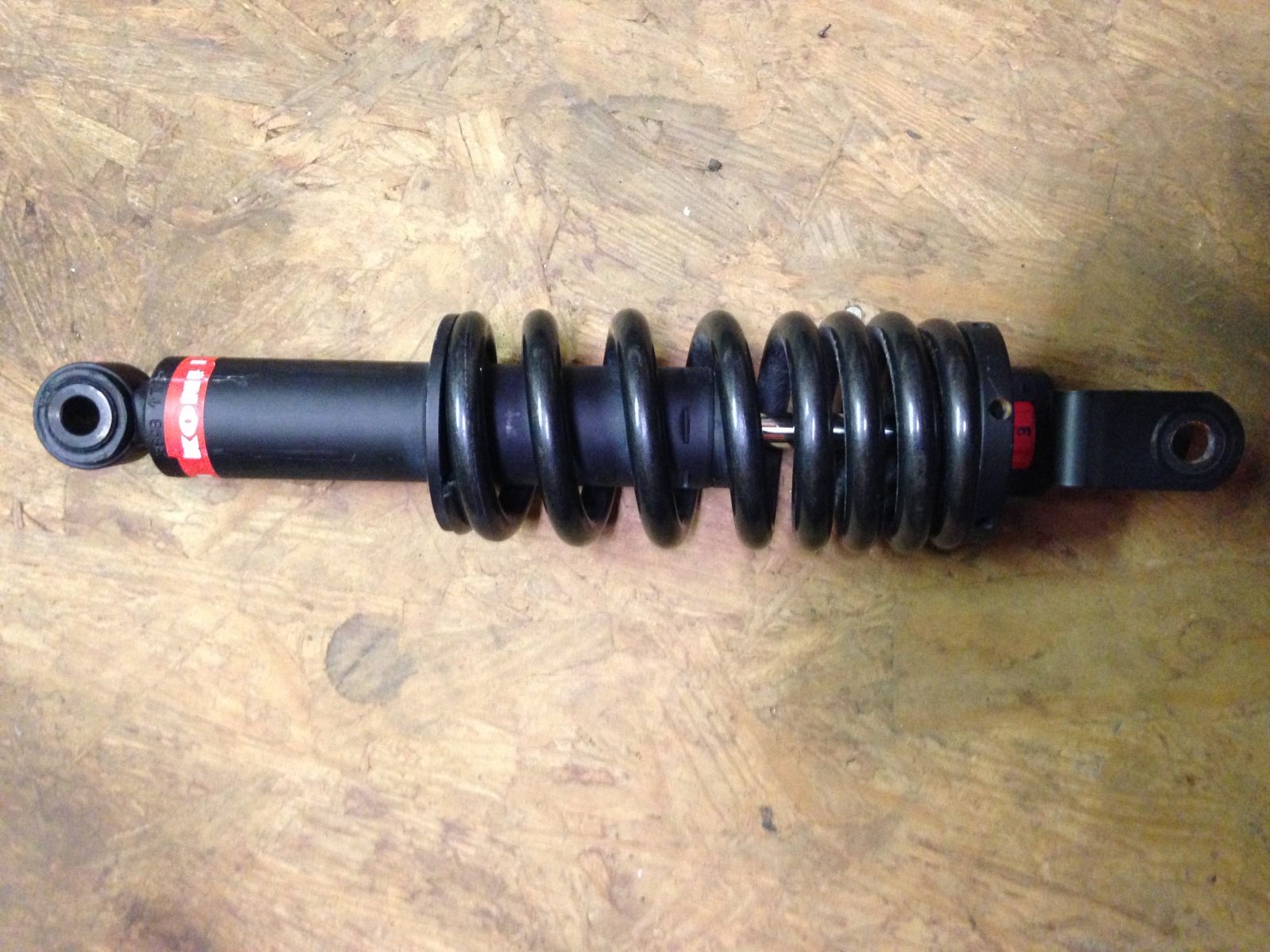

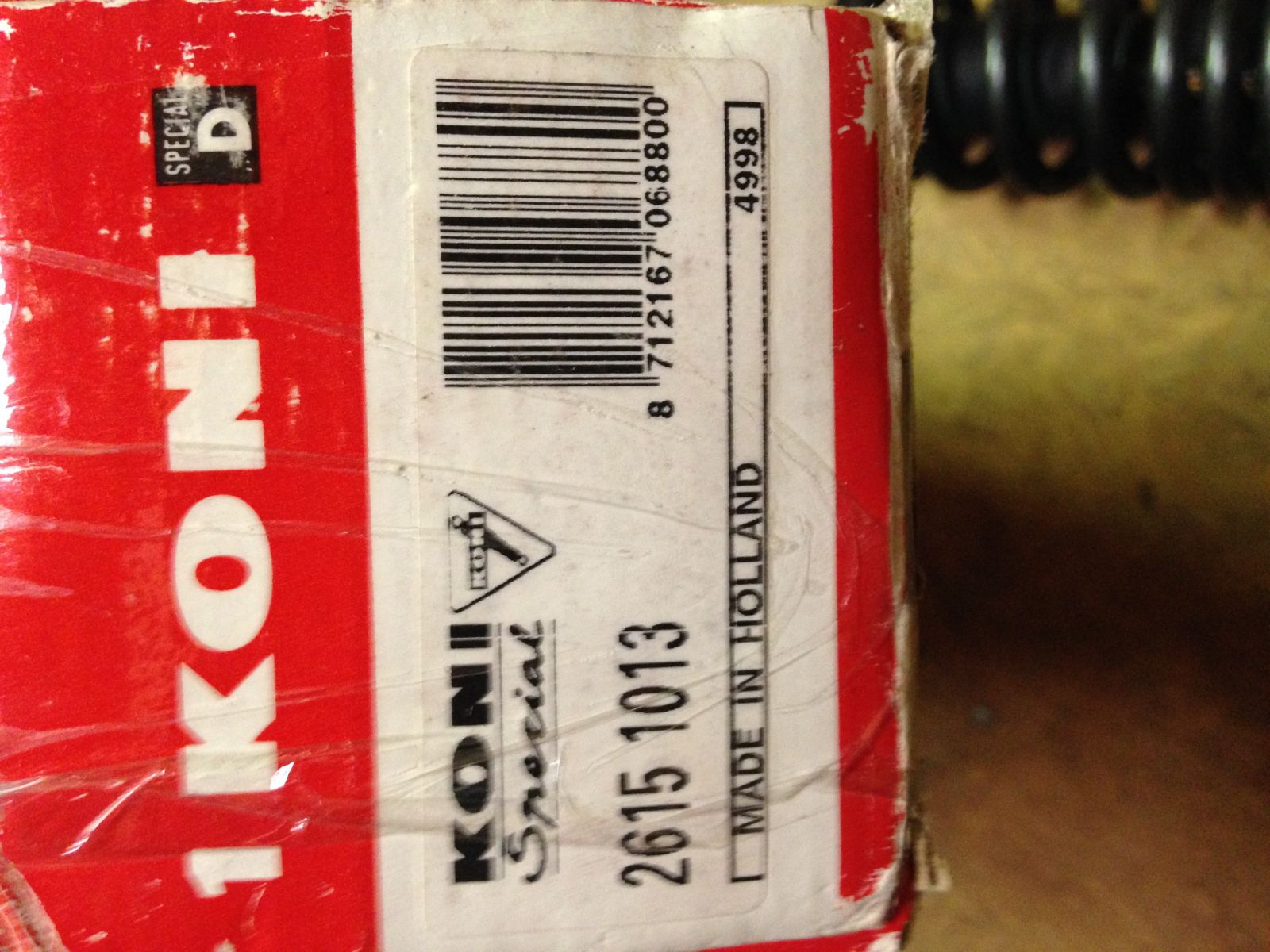

if interested i have a 83-85 gpz1100 single adjustable Koni shock. i bout for my project but is 1" longer and i had welded the pieces for a 12.5" shock.
$125 shipped in the states.

No thanks on the rear shock. I have a ZX6 one I will be running with the 636 swingarm.

21 Nov 2014 14:18Im afraid to ask what that new blaster cost.all I can find online is specs,no pricing. :laugh:
- eofa
- Posts: 26
Re: 1984 GPZ1100 Rebuild
21 Nov 2014 14:22 - 21 Nov 2014 14:25
Oh there's pricing out there. Just gotta hunt for it. I'll say this much, at what this was spec'd out at, brand new from the factory, it's was around $15-20k. We did not pay that for sure. You also need an industrial sized compressor to run the proper PSI.

IDK...if those pics are a typical example of what the end result is, I'd say they're a pile of money pissed down the drain. That finish is far from impressive.
This is blasted in a regular cabinet and didn't get finessed because it's going to be painted black....... real bead...not crushed glass and a steady 65 PSI.

That hydro blast machine looks awesome. What media does it use? I've heard there is less risk of grit residue with wet blasting but I don't know that much about the process.
Edit: looking on youtube and found this video...
Vapor blasting looks to leave a superior finish to that of bead blasting with glass. Less hassle of degreasing and pre cleaning too. Good stuff.
Last edit: 22 Nov 2014 05:40 by Nessism.
- Tyler
- Posts: 845
- Thanks: 92
22 Nov 2014 08:11
wet blasting is sweet, the big systems I have used have been way nicer than conventional type. with air blasting the problems are almost always with dust collection and solids recycle, wet systems do this much better.
Larry has point, finish should be better... what media are you using?

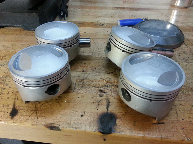

I guess there's always gotta be someone poo pooing someones excitement. I think the wet blasting is working just fine. Our biggest concern in the shop was dust and airborn particles. The wet blast has none. It also works fast. I blasted my pistions and it took around 15 min to do all four. I think they turned out real nice. We can also stretch the media since it's contained in the water and depending how many parts we do the slurry could last a long time before we have to empty it and start fresh. Pros and cons to everything but for our clean shop this is the best solution for us.
I reblasted the head and it cleaned up even better than the first pics I posted.
