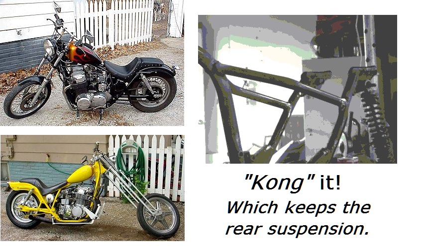

Another option --
Meanwhile, wearing tall-heel cowboy boots may help with reaching the ground while stopped.
