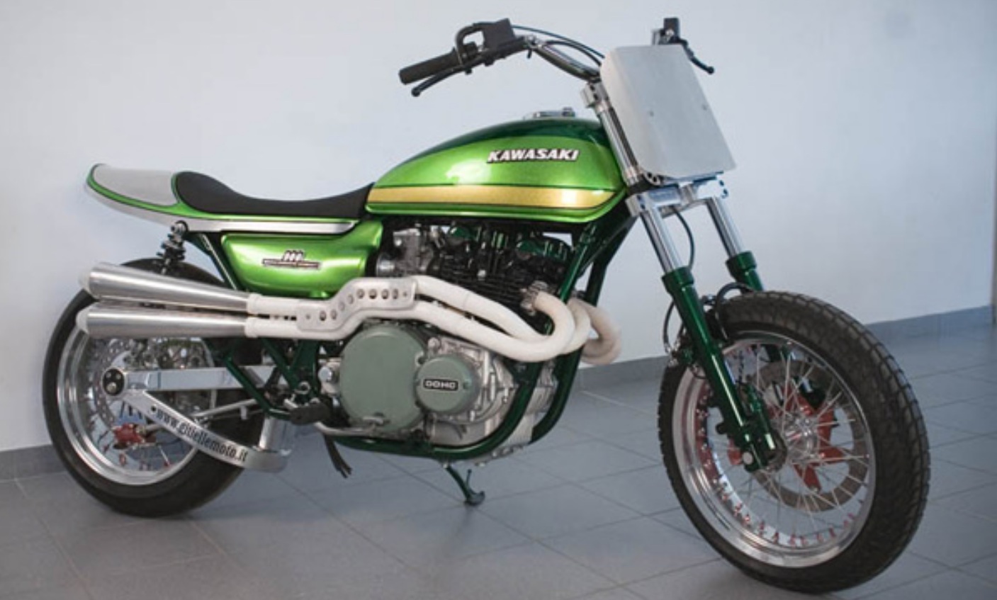

Flat tracker? I don't think so. Dual disks up front and it looks like no rear brake? :blink: Sort of backwards for a flat tracker.
- Posts: 18564
- Thanks: 2103
Re: 1980 kz440 USD and monoshock conversion
10 Jun 2014 09:12 - 10 Jun 2014 10:08omarsdtr.com/streetmain.html
Or perhaps any customized motorcycle having overall lines similar to and vaguely resembling a flat tracker?
Honda produced a good looking street bike that resembled a flat tracker.
(Will try to find a pic). [Oops -- the Ascot wasn't so good looking after all, and not too flat trackish.]
So did Harley. [Oops -- The XR1000 wasn't as flat trackish as throught.]
www.vitalmx.com/forums/Moto-Related,20/H...Dirt-Tracker,1213557
Anyhow, I'm pretty sure this is a tracker:
Last edit: 10 Jun 2014 10:08 by Patton.
