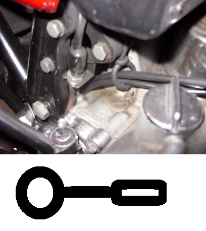

At the very bottom of each carb bowl there is a brass nipple. Those are where the overflow hoses attach. From there. the hoses run toward the rear; right hand side of the engine, and they go through that rubber loop. From there they run down behind the engine between it and the swing arm pivot. They should be long enough to aim down at the ground so any fuel that may overflow goes onto the road instead of the engine. Ed

Here's the stock fitment of the rubber collector for the overflow hoses on a 1976 KZ900-B1 LTD.

Nifty little thing that is then. Got it squared away.
