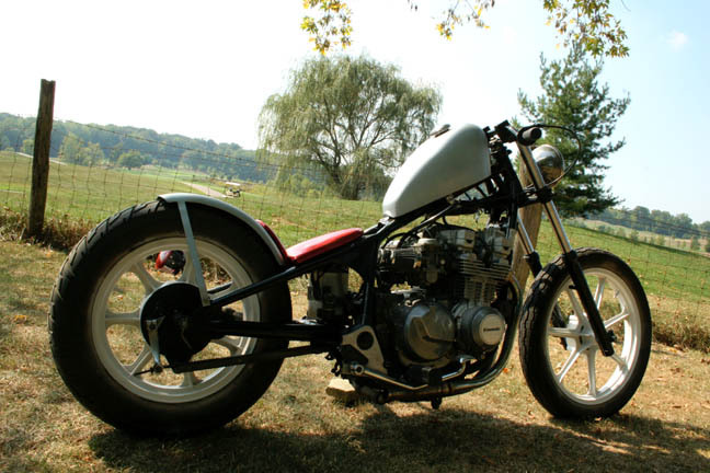

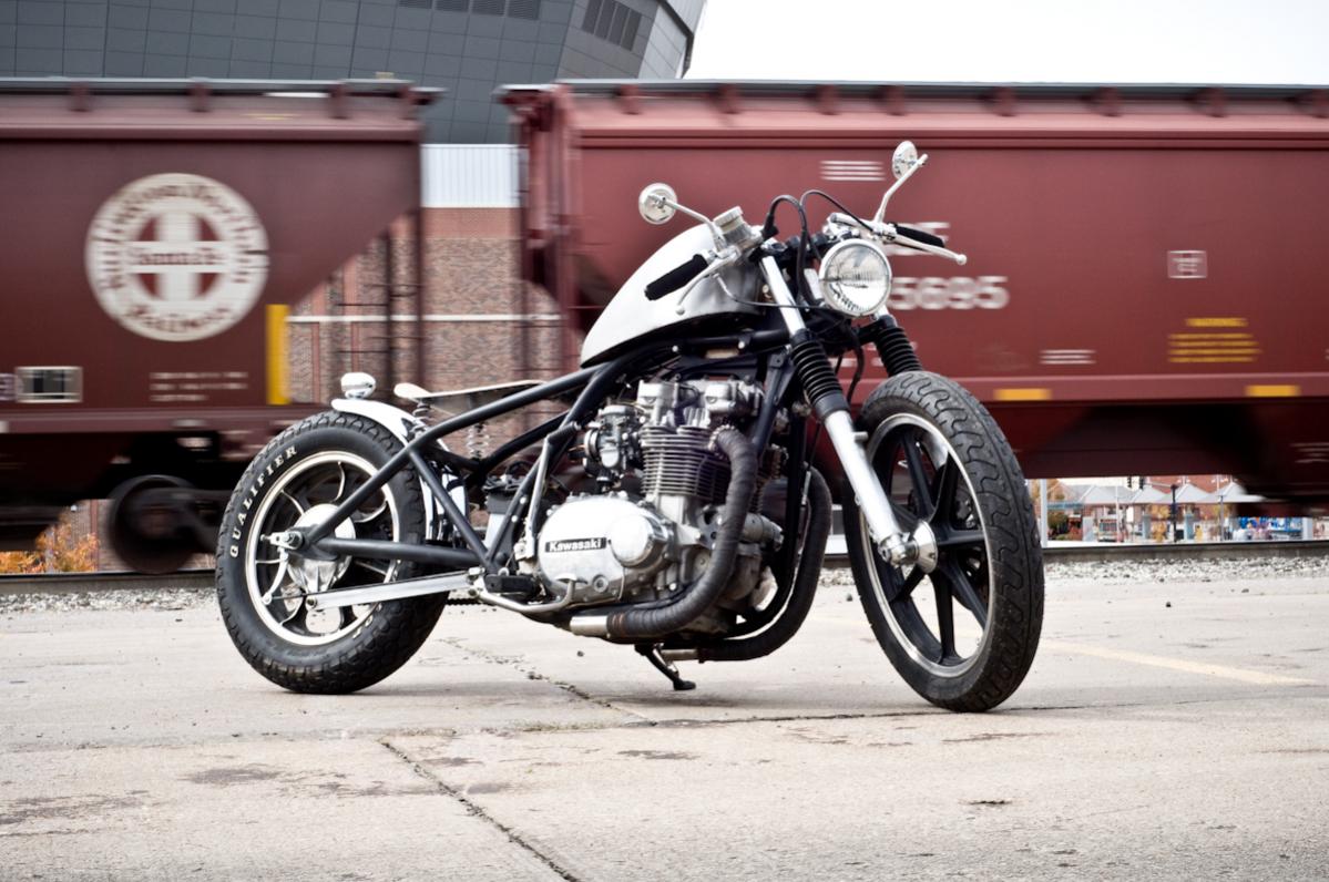

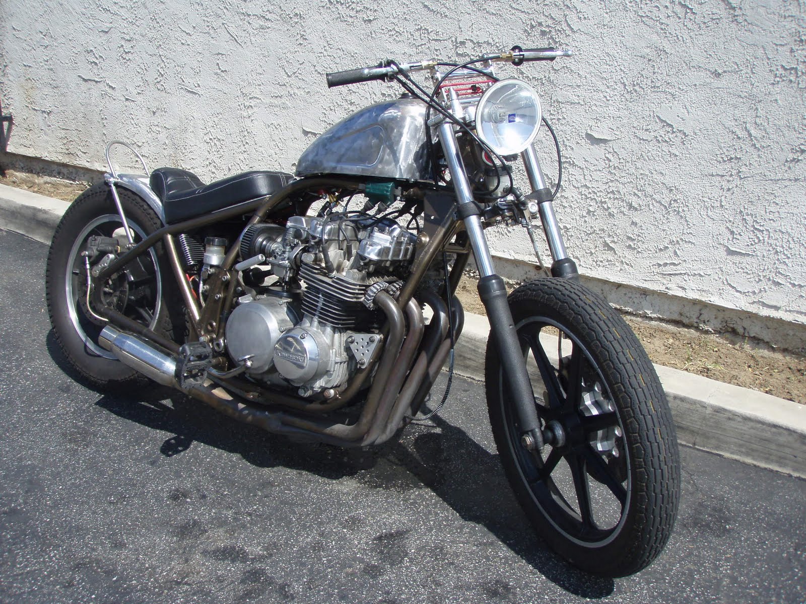

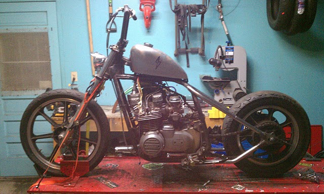

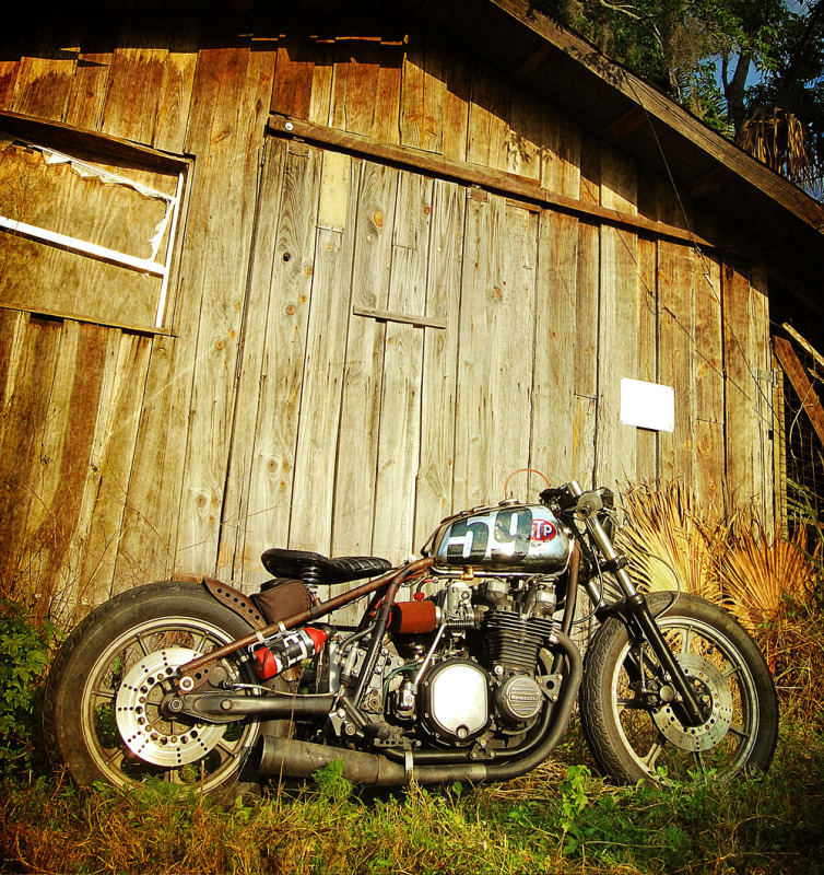

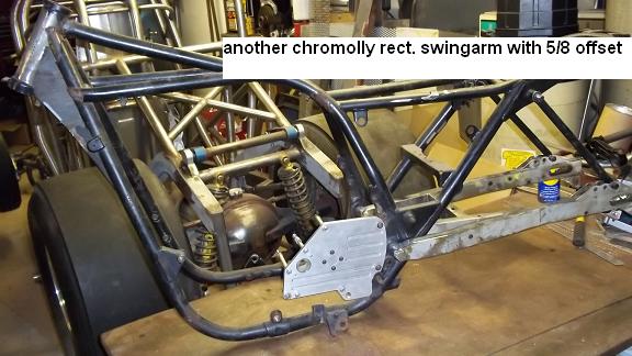

here are some captured swingarm pics.
although they never look/ride as good as a weld on hardtail,imho.

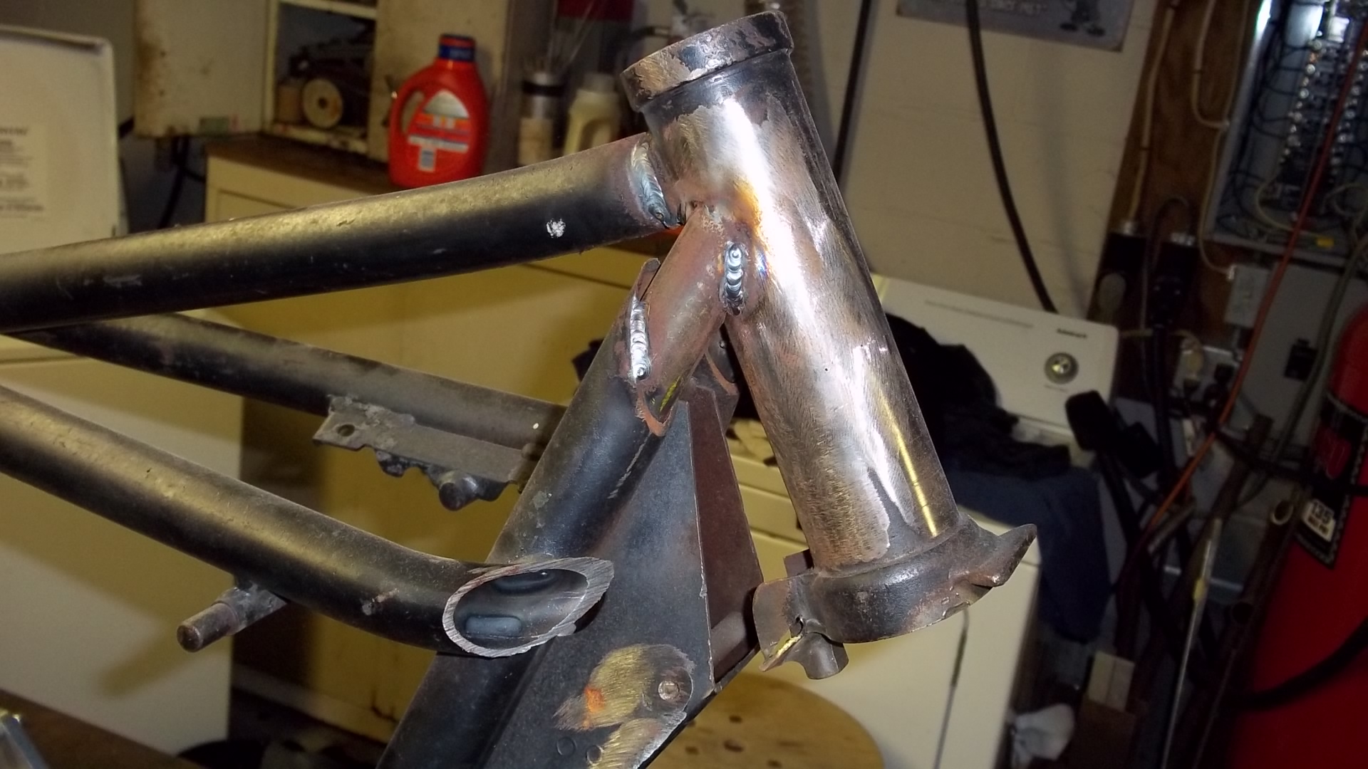

Start looking man! Once you get that swing arm in place, make some struts. And weld it all up. Including the pivot bolt. Then it is permanent!
Heres an old picture. I raked this frame at a buddys house, we were building an old Gasser Willy's Got $50 grand into it so far. You can do anything if you want to!
