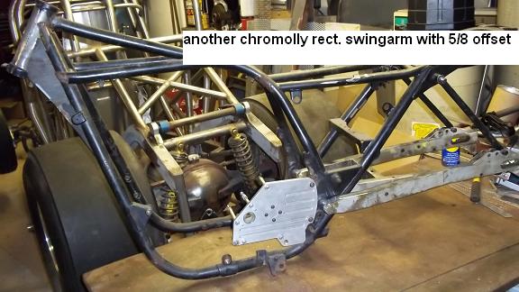

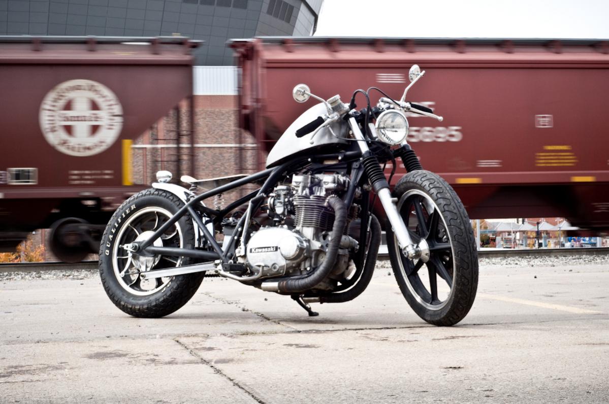

here are some captured swingarm pics.
although they never look/ride as good as a weld on hardtail,imho.

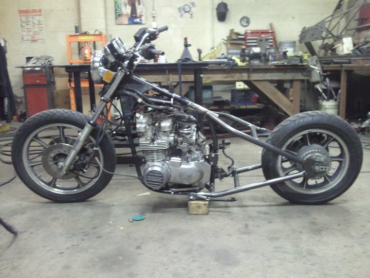

Here is the bike at my neded height btw . I said Id post a picture . It is 7 inches between shock mounts .

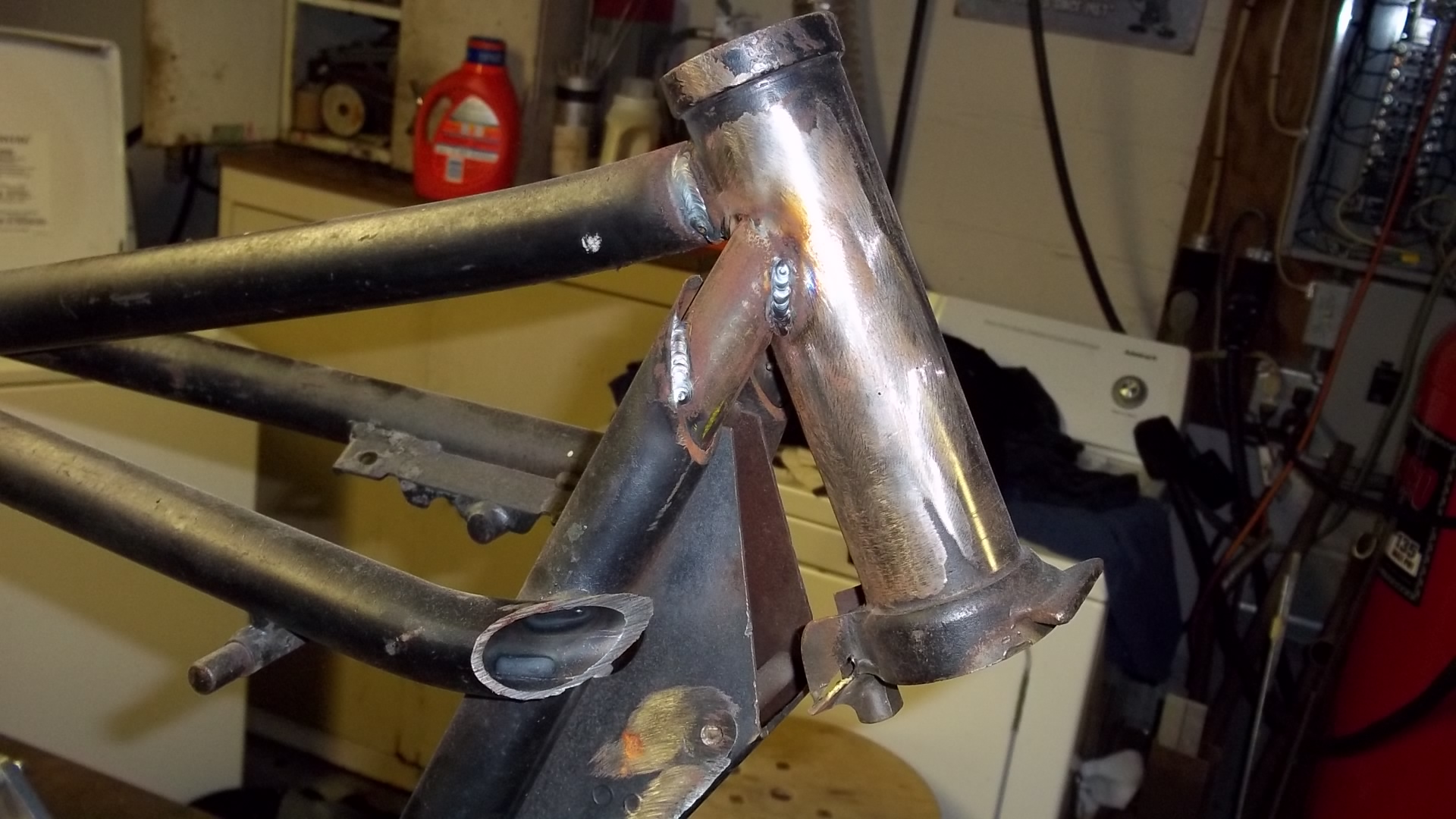

Heres an old picture. I raked this frame at a buddys house, we were building an old Gasser Willy's Got $50 grand into it so far. You can do anything if you want to!
