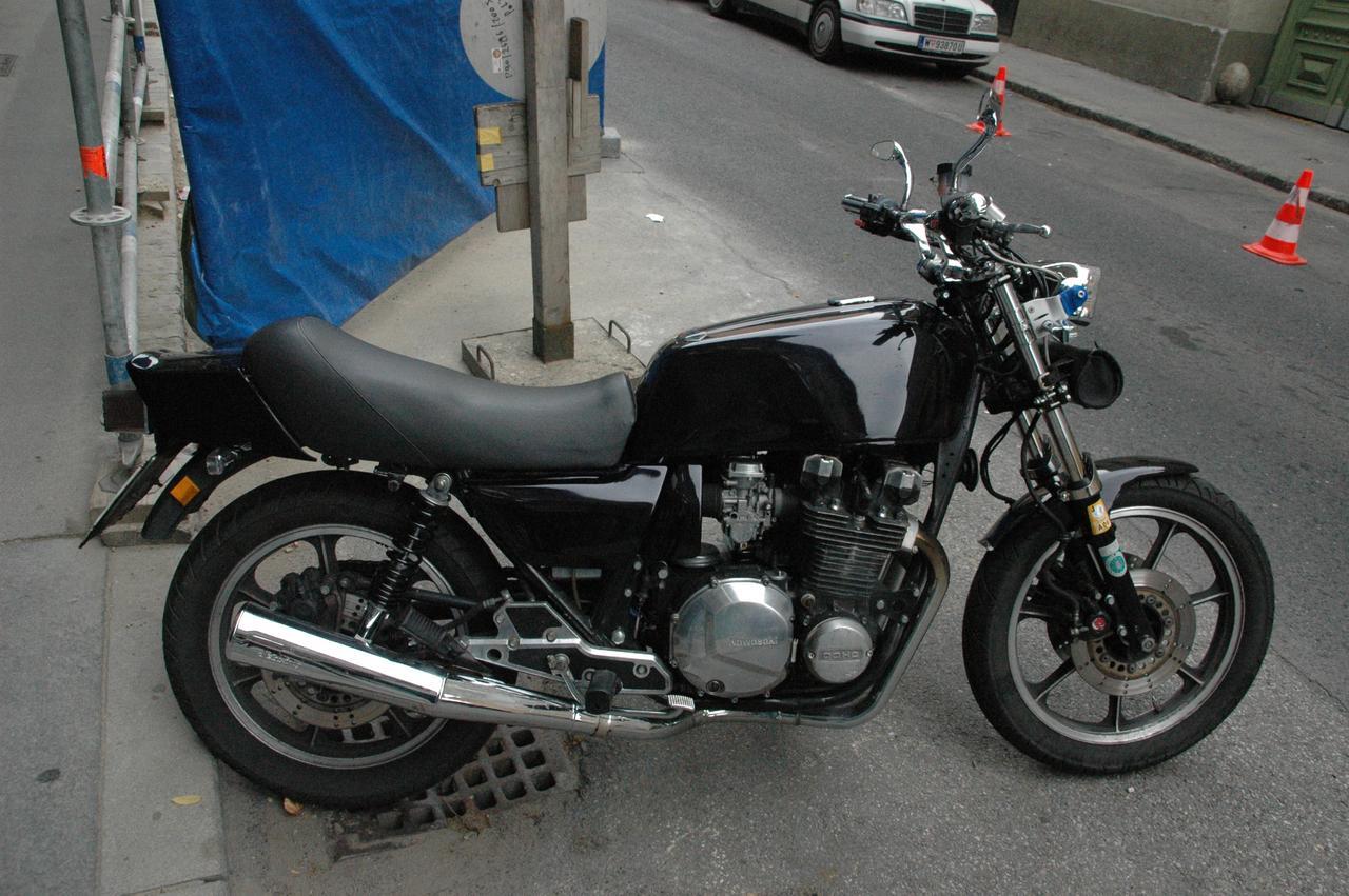

Hello everyone. New to forum, I come seeking wisdom.
So far I have acquired a 1996 ZX9r front forks/triple/wheel as these are almost the longest USD forks you can get. I also picked up a almost complete 1998 ZX6r for free and I am in the process of transplanting the swing arm.
This is where my question comes in. Did anyone re-purpose the center stand mounting holes for the mono shock pivot point? It lines up dead on. If not how did you do it? I am looking for up close shots.
On to the photos!
So here is a few shots of the bike when I got her and where I am now.
1st photo is when I picked her up ( person in photo is not me)
The other pho

Not sure if anyone is even looking at my post but I completed the front end swap.
1996 ZX9r front end on my KZ1000:
