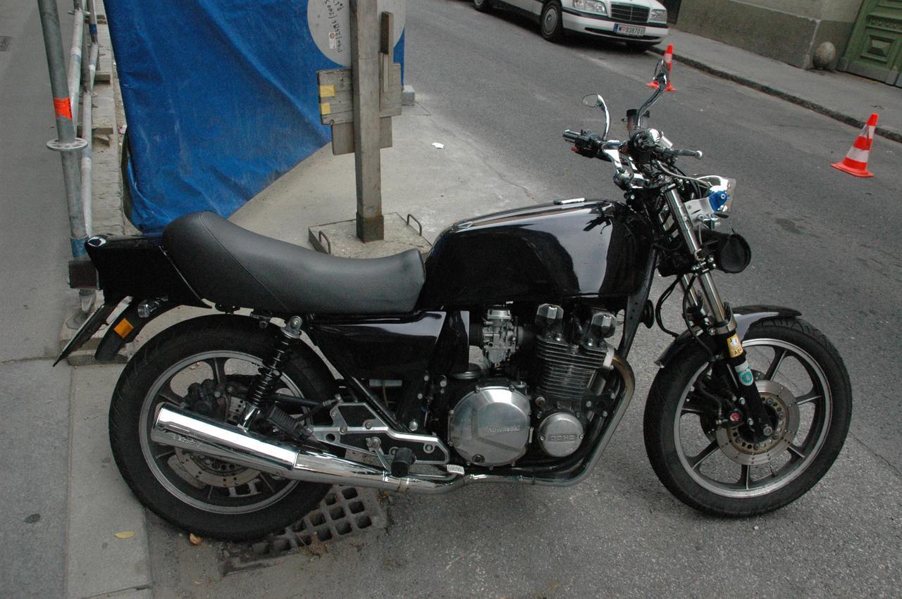

So here is a few shots of the bike when I got her and where I am now.
1st photo is when I picked her up ( person in photo is not me)

Not sure if anyone is even looking at my post but I completed the front end swap.
1996 ZX9r front end on my KZ1000:
