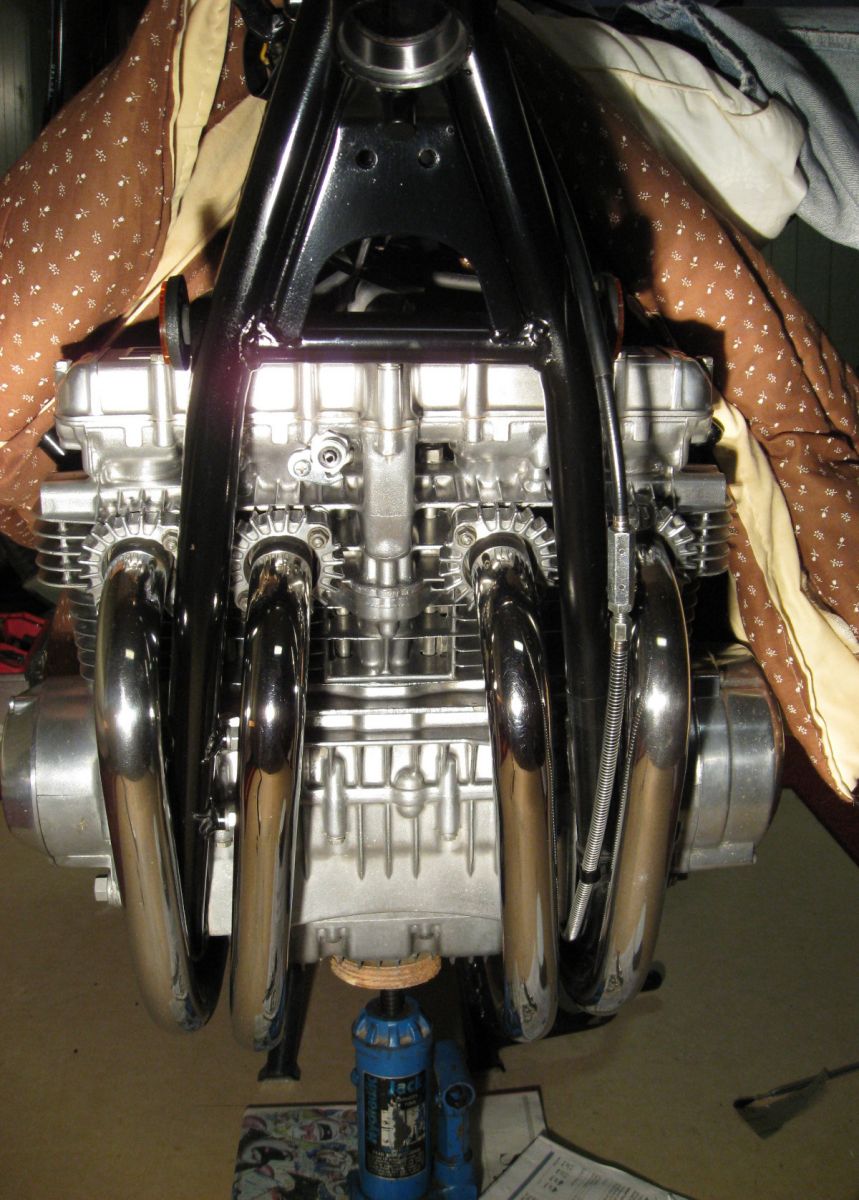

Here's what I do to lift the front wheel off the ground to change the tire. In fact, as you can see it even works for removing the whole front fork, although obviously that's not necessary to remove the tire. I put the bike on the center stand; put a small bottle jack under front of engine with a block of wood between it and the engine to protect the fins, and jack it up slowly until the rear tire JUST BARELY kisses the ground. Just don't jack it up so high that you lever it off the center stand. Ed
