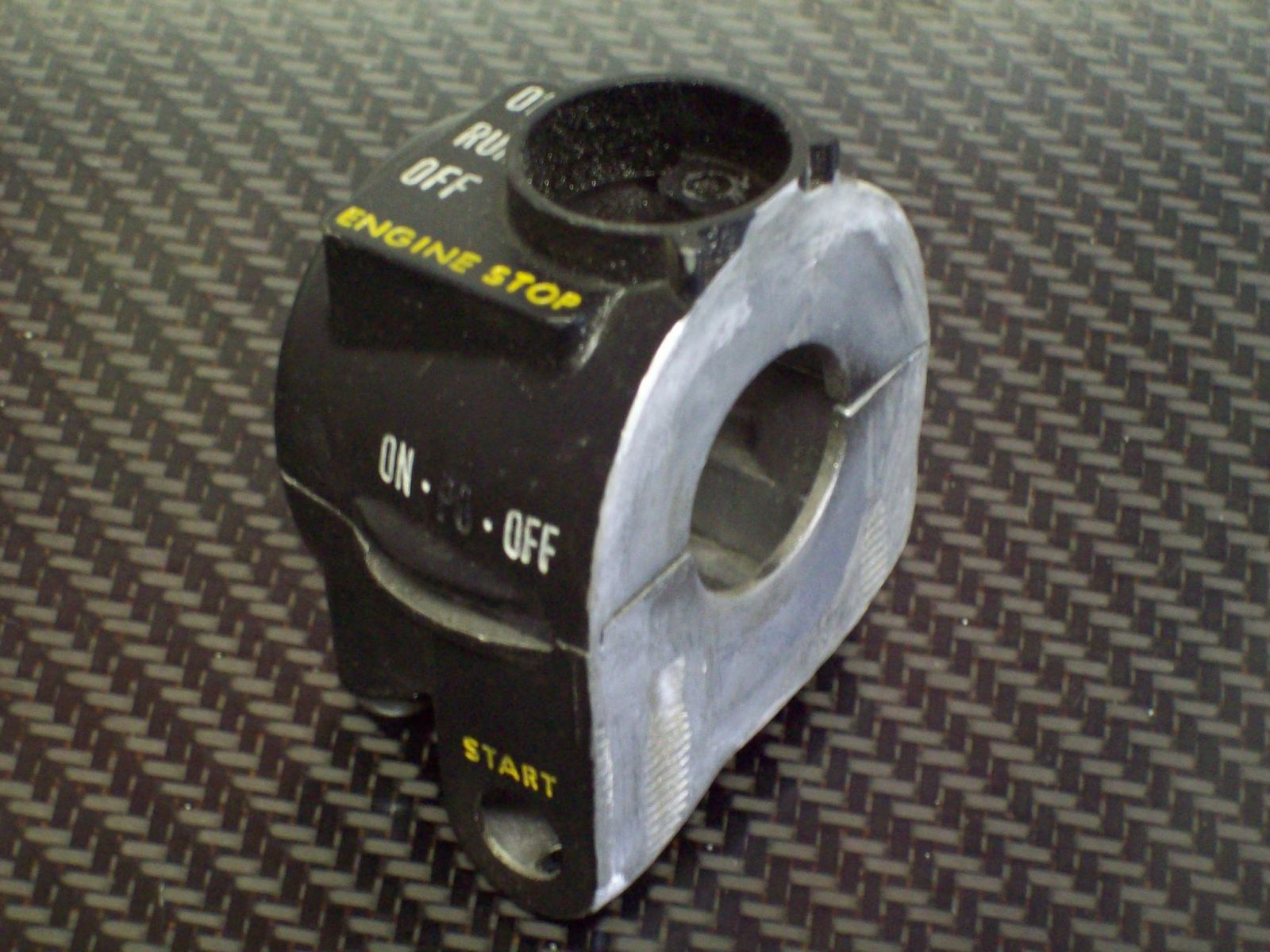

Finally had an opening at the Hot Rod Shop to get my welding done. It came out pretty good in my book. His welds are not as pretty as my welder extraordinaire, Lubbarb back in Chicago were, but they are close!!! My rearsets are now finished. I think they came out plain and simple. That's how I like things!!!!
Also been working on my righthand switch body too!!! Its amazing how a little project takes so much time in the end to complete. Painting those little letters on the switch body reminded me of all the time I used to spend putting models together back when I was younger.
Between the machinist and the welder, I am over budget for this month. That means I can't buy anything else till next month. That really sucks in my book!!!

Hey doc, I tried a few times to brush paint the letters on switchgear. Ended up figuring out to just blob the paint on and wipe off the remainder with a damp sponge.
If you painted that the "right way" you deserve some credit, it's a pain

I used a toothpick and thinned the paint out a bit. It flowed to most of the indent for each letter. Yea I still had to wipe the excess paint off on some of the letters. Back when I was younger, I could paint the "GOODYEAR" on the tires freehand!!! Now I am blind in one eye, and can't see out of the other!!!
