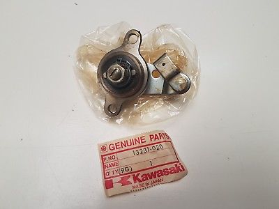

No eBay APP ID and/or Cert ID defined in Kunena configurationCool! thanks Bob, scored a filthy one off of flea bay, taken off a 80 kz550
They list a bunch of bikes that it will fit but no 1000's , looks the same though, fingers crossed.

They list that release to be the very same part number, 13231-020. So it should fit no problem!!!
Just make sure you repack it with some good hi-temp grease after you get all the old grease, and grit that has accumulated in that release out of it!!!

So you say that it has ball bearings that I don't want to deal with, what is the best way to clean it? soak it in gas?

I cleaned mine in the past with Safety Kleen. Any solvent like gas would do. Then spray some carb cleaner through it to make sure there is no more grit inside of it. Just check it when you get your release and see if you can feel any grit inside of the release. If not just repack it. The hardest thing is to get grease all the way through the whole release. I have used that spray grease to get all the way into the release.
I never had the patience to take one of those releases apart. I found it easier to just replace it with a new one. But that was back in the day when you could still buy them from Kawasaki, and I had extra money to spend!!!

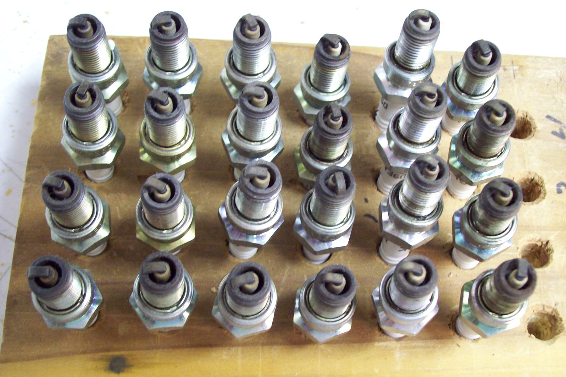

Since its too cold outside here to do anything outside. I been playing around in my work area.
Here are the plugs from my GSXR750 when I was trying to get my flat slide Mikuni's dialed in from last year. The CR Keihin carbs are a lot easier to dial in than the flat slide Mikuni carbs. That damn accelerator pump really screws up your plug readings!!! I ended up running with the pump shut off till I got the pilot circuit pretty close. Then I hooked the pump back up. That accelerator pump needs to be backed off big time, and get it to squirt at the right time!!!
Plugs on the left side is where I started with the jetting. You can see the plug color get lighter as the plugs move to the right. Its best to start out with a new set of plugs when you make a jetting change. It is real hard to read a plug that has already been run with different jetting. Each set of plugs here has just under 100 miles on them. The very last set of plugs on the right has over 250 miles on them. That was the set I ran after I got the jetting almost right on. Running air filters on the flat slide mikuni's made it a lot harder to get the jetting real close.
