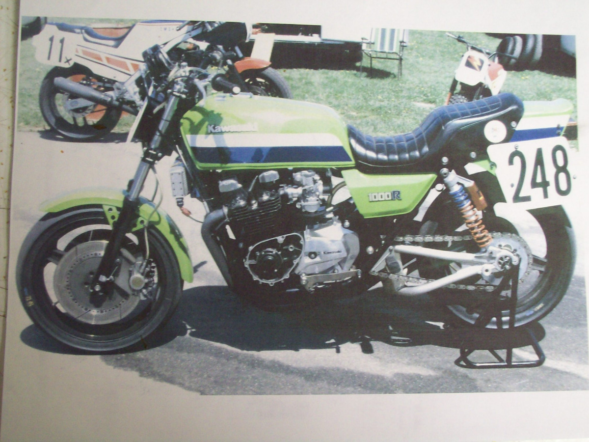

23 Mar 2018 16:35Yes I did. # 000062. It was 5 seconds slower a lap around Road America than my Kz Superbike I built!!! So I sold it.
Who knew they would some day be worth what they are now.
I was a " C " rider with "A" equipment. I never raced at the level of Lawson. Plus I had to go to work on Monday morning. Plus I was involved with a few large dealerships back then. I got a couple of large bonuses for not going racing till after Labor Day!!

What do you think made the S1 slower? Was the frame modified like your KZ mkII? Does any body modify frames like that anymore?
Hey sorry for all the questions, but not too many people have that first hand experience with these bikes like you do. They were 10 years before my time. But I love them.

My first road race bike was a KH400. I ran 400 Production for a few years.
The '81/'82 Kz1000J and GPz1100 frames don't need a major modifications to handle. Everything Kawasaki learned from the '79/'80 Superbikes was incorporated into the '81/'82 stock frames. There is only one small extra brace added to the S1 frame to make it different from the stock J model frame!!!
The stock S1 forks were pure junk out of the crate. The major problem was the excessive clearance between the inner and outer fork legs!!! The S1 motor out of the crate only made like 115 to 120 horsepower. Like any Japanese racebike, you take it all a part, and make sure everything is up to snuff before you put it on the track. Thats when I found the forks were not right. The first time I raced it, I got into a major wobble going around the Carousel at Road America. I was not expecting any of that from a factory race bike. Not for something I just paid 11,000 dollars for!!!! Thats when I parked it, and ran my MK. II that weekend.

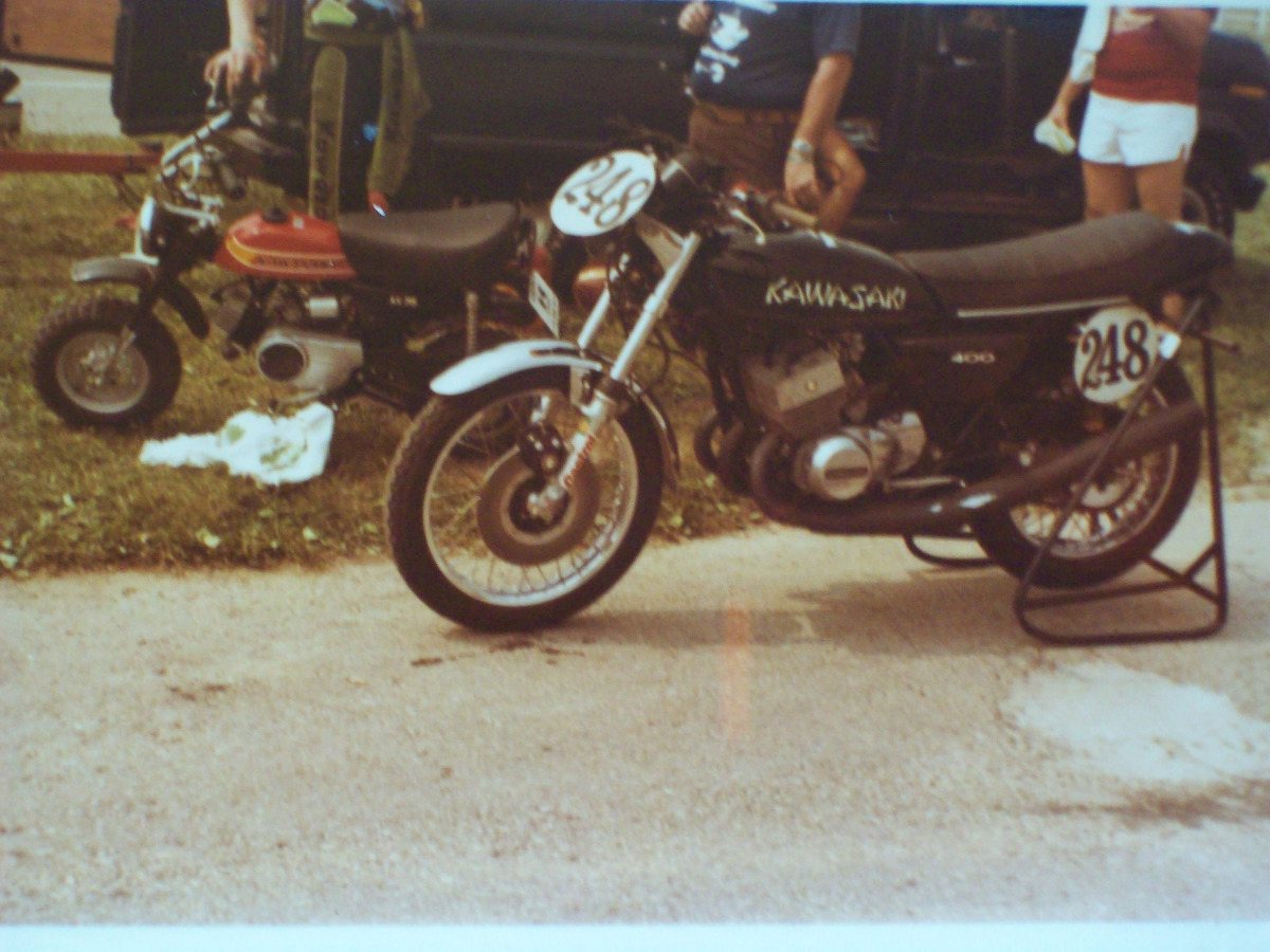

My KH400 Production road racer back in 1977. This is the bike I learned how to road race on. I still own it today. It was in great shape until I had it in storage inside my buddy's garage, and for some unknown reason he put it outside uncovered. The Illinois winter took a real toll on it. When I loaded it up in my van, water poured out of the pipes!!! I was sick when I saw that!!

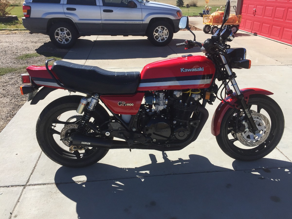

Just saw this post...I know it's old but I had to reply.....in regards to the 86/87 GSXR wheels, I did use them on my 1981 GPZ1100....they seem to me to be a no brainer. I milled out spacers, and tweak here and there. Used a gsxr rear brake, milled some pieces for it. Welded the brake mount on the bottom. I had to mill the brake rotor mounts in about 6mm to clear the stock forks. Milled the speedometer drive down a little and a little off the fork. The drive even works with a 1984 GPZ1100 or ZX 750 speedometer and gauges. IT's ~3 MPH off at 75mph. Tank gauge works, tach etc.... I used a zx750 light cluster and it bolted right on with some english. I hated that friggin ugly cluster that come on the b1... Using the stock swingarm I didn't have to use a offset front sprocket so no worries with the pickoff shaft side loading and toasting the bearings and seals. I had to cup the swing arm just a tad, nothing big. I used the 1100 rear wheel so i could run a 150 or 160, but if you used the 750 3.5" and a 140 it will clear no problem. Of course, like all projects, I found a even better "family recipe" using a set of zx1100 triple clamps (which are ~.75" wider, and zrx1100 rotors(same bolt pattern)) which have 1/3" the offset, which them makes milling the rotor mounts not necessary. You do need to make a brake adapter, which is easy. However...the gixxr axle front axle is 2mm larger, so I had to make some inserts on my lathe so the fit was correct. All of the small stuff is a pain in the butt, and took 90% of the time. So far no issues I aligned the front and to 1/8" and have experienced no wobbles or slappers. I need to seriously upgrade the front fork internals. I have a set of racetech springs and GoldValve Emulators ready to be installed. I am installing a fork brace and steering dampener as well. Rear shocks are off a ZRX1100 rebuilt and revalved and with hyperpro springs by Jamie Daughtery. He says don't bother with the Ohlins, the KYB's properly tuned work as good ot better for way less.
Do you know what the weight difference is between the GSXR wheels and you Morris's? I'm sure they weigh way less.

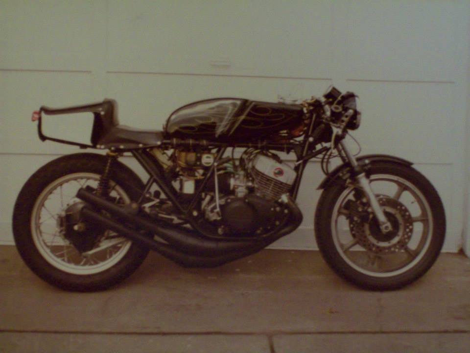

I grew up building and riding Kawasaki two stroke triples!!! I always liked going fast, and going around corners. I would go to the drag strip once and a while too. The H2 you see here ran in the low 11,s to high 10's without a wheelie bar, and no powershifting!!! I forgot how many sets of Denco ported cylinders I had for my H2. I also have a set of Kevin Cameron ported cylinders and pipes for the H2. I held on to those to this very day!!! I still have a few two stroke bikes left. I love to ride or just hear my Rg 500. Go to my facebook page and see more photos of my bikes past and present....Look for Rob Kiekenapp.
I just wish I had the money, and my health back so I could go vintage racing. I can't believe how much everything costs today for my bikes. I can't even afford the insurance and a new set of tires this year for my GSXR. Oh Well end of my soapbox.
I built this bike back in 1974.
