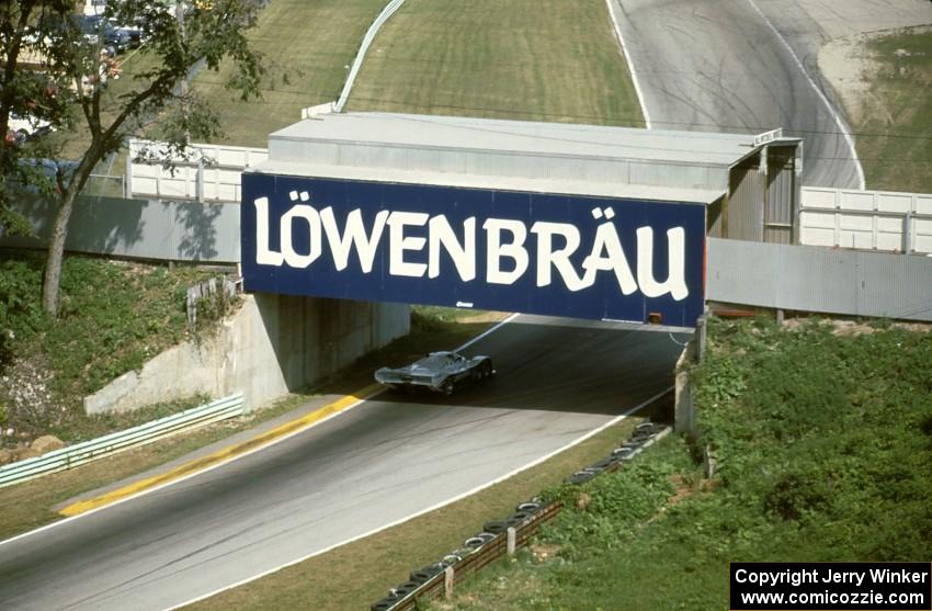

22 Mar 2018 17:50 - 22 Mar 2018 17:52bluej58 wrote: Barreling down the Moraine Sweep to a hard left and a wheelie up Fireman's Hill
I always enjoyed The Kink on the back part of the track. Come flying out of The Carousel then you are looking at a retaining wall as you set up for The Kink!!! Depending on the size of your attachments, you can either take it wide open or if you back off for a second!!!! Now they put a chicane in before The Kink and taken most of the fun out of that corner!!!
The corner that bothered me was the left hander under the now gone Billy Mitchell Bridge. You are aiming at the bridge abutment as you turn into that corner. Now that they have removed that damned bridge, I bet you my lap times would have dropped another couple of seconds because its gone!!!! I watched Jerry Titus crash his Trans Am Firebird there back in 1970. I will NEVER forget the sound it made when he hit that same abutment almost head on!!!
Photo credit goes to Jerry Winker.

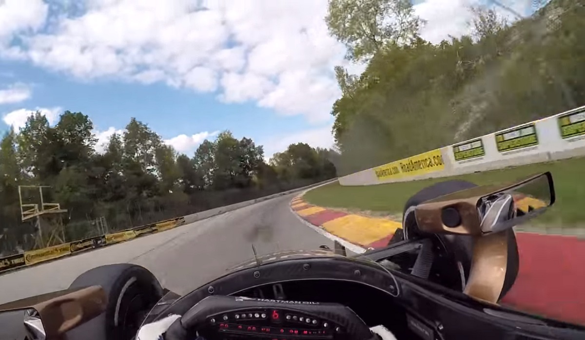

22 Mar 2018 18:02 - 22 Mar 2018 18:05This is one FUN track to race on!!!!!!!
1986 RG500G 2 stroke terror.

WOW !!!
I loved watching that bike racing vid !!!!!!!!!!!!!!
