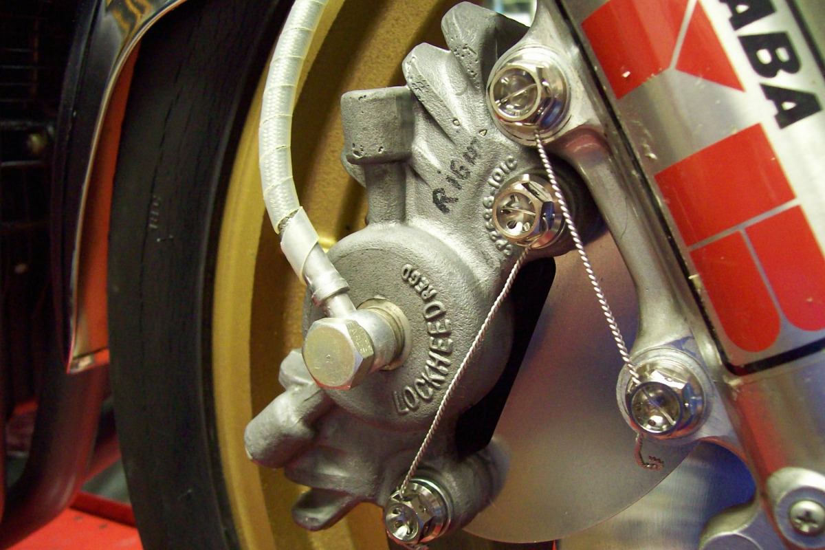

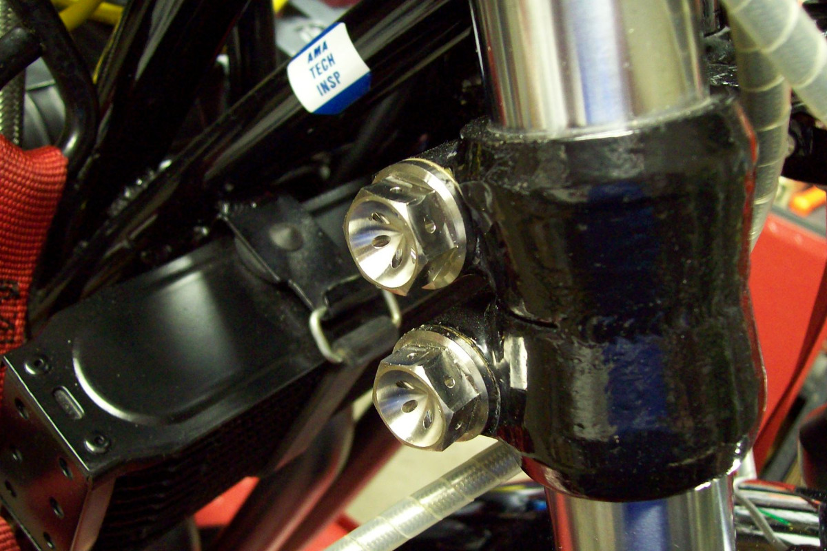

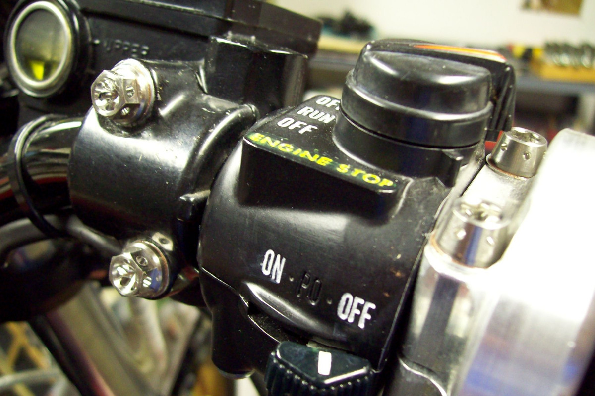

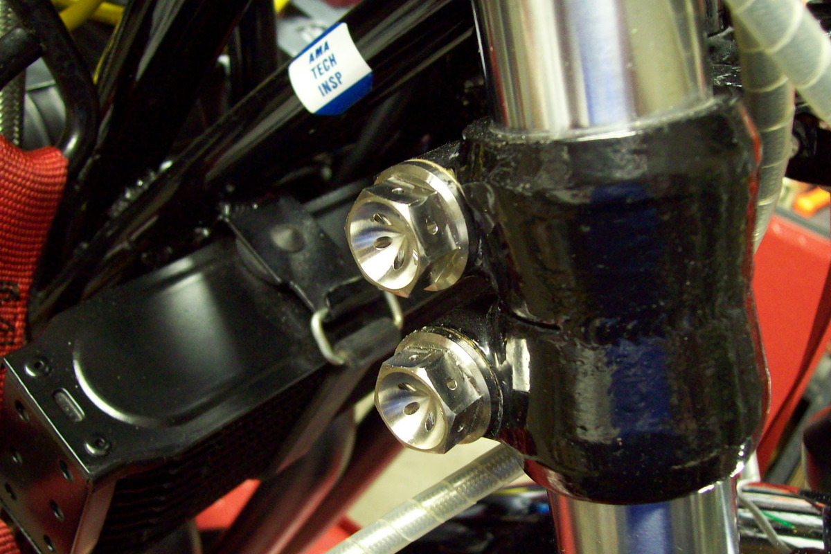

I just got another order of titanium fasteners in for my bike. All these trips to the blood bank are paying off, I shaved 1 pound 11 ounces off the old KZ. All the nuts and bolts on the front forks and handlebars of my Kz are now titanium!!!!! Can't wait to start doing the rest of the chassis bolts in Ti22 now!!! I wonder if they pay more for blood during the holidays??? Find out tomorrow!!!
