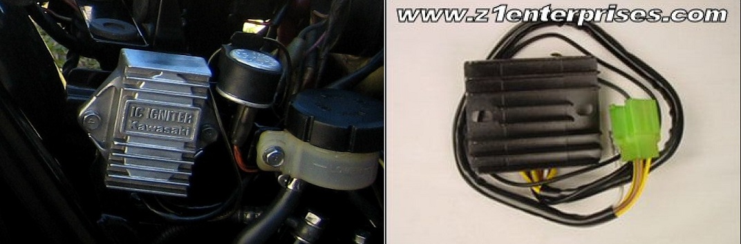

The bike's electrical systems include the ignition system (which has its own separate components), and the charging system (which has its own separate components).
The I.C. Igniter unit is a stock component in the bike's ignition system.
The I.C. Igniter isn't used with Dyna-S ignition.
Here's an example of the igniter as compared with a regulator/rectifier.
The regulator/rectifier, often located under the battery box is a required component of the charging system.
Good Fortune! :)
