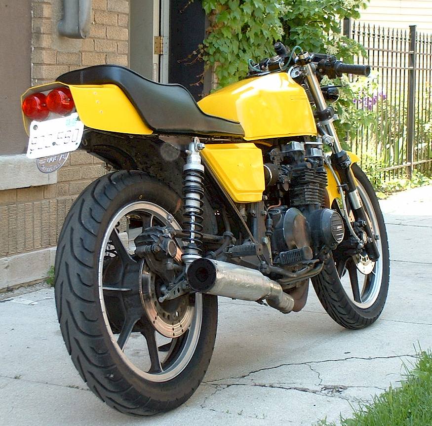

Here she is as she stands now

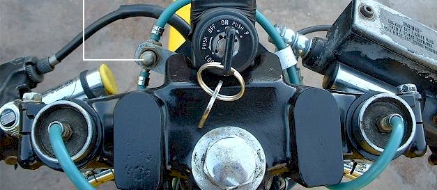

I saw a guy take his upper crown and cut/grind off the riser bar tabs. is that safe?

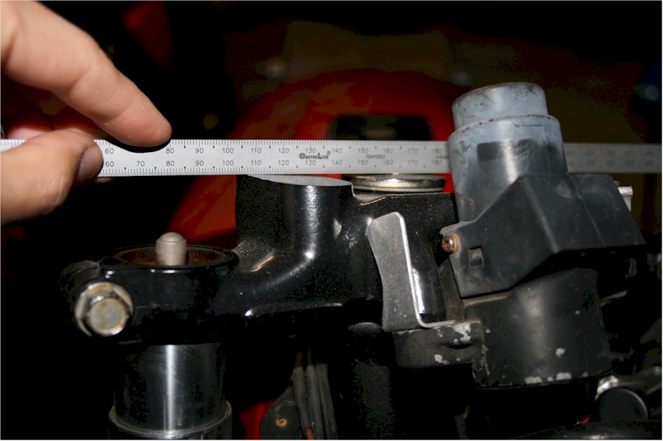

On the 550, you can cut the bar risers off, but there will be odd shaped holes in the casting where the base of the risers had ribs. After cutting off the risers, the ribs will still be there for strength, but the holes need to be welded up. Any good welding shop can fill them easily. I had a buddy mig weld mine up. The top triple clamp does not support any weight, it just stabilizes the tops of the forks.
Notice the lower clamp is made of steel and uses twice the clamping bolts.
You can see where there is a little pitting from the mig welding. (My buddy was doing it for free, and he is super busy.) You can always smooth any pits with body filler, later.
Cut the risers just above the level of the stack washers. Then after welding, you can belt-sand or file down to the level of the stack washers.
Cut the rises in a plane parallel to the plane of the clamps.
