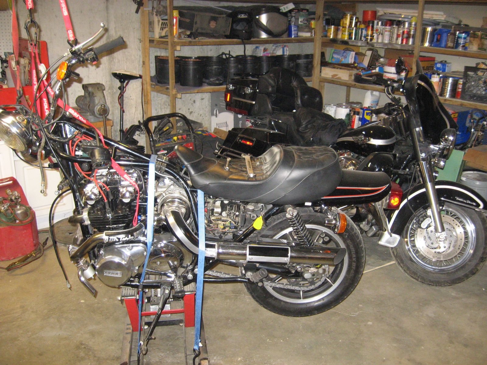

14 Mar 2013 16:47Wanted to share some pictures I just took during tear down and fitting my new custom triple trees from Les Holt.
Trial fitting looks great so far, Had to order new tapered roller bearings from Z 1 Ent this morning . Cant get the ones I already had in the bike out with out damage so after 30 plus years with the old tapered bearings I guess its time for a new set.
Once this is completed Im planning on some more over the top upgrades. ( To announced at a later date ).
Hate to take apart a perfectly good motorcycle, but I made a exception in this case.

looks fantastic! Bearing is upsidedown. :silly:

15 Mar 2013 12:58Yep !!Hollywoodmx wrote: looks fantastic! Bearing is upsidedown. :silly:
Thats the old top bearing, just sitting there so it stays where I can find it later if for some reason I need it . LOL :laugh:
Only used 600 grit paper and some Mothers Billet Polish so far and they look great !! I will be using a buffing wheel and compound on everything before Im done to really make it POP
Les did a great job of machining these trees and the machine marks came out pretty easy.
Will need to modify or make a new Boost Gauge bracket to complete the basic install, and then save up my pennies for all new stainless steel brake lines. I want to see if I can find some that maybe have the ends pre installed to do away with multiple couplings. Anyone know a good source ? I might take a ride to a place in Troy MI. called Auto Cycle Marine that I used to do business with and see what they have.

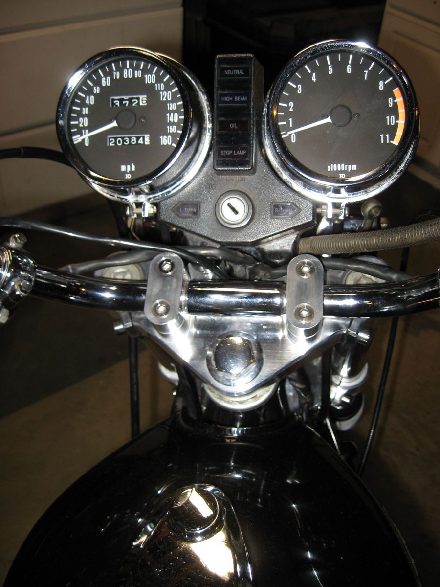

Wow those are nice! :woohoo: Are they set up for stock components? I also like the fork brace...any idea if those can still be purchased anywhere?

20 Mar 2013 15:3679MKII wrote: Wow those are nice! :woohoo: Are they set up for stock components? I also like the fork brace...any idea if those can still be purchased anywhere?
Thanks 79MarkII
Les made these for me to work with all the factory parts .
I had never been in love with the factory brake splitter on the 78 LTD lower trees. It always looked like a design compromise bolted to the front of my bike. And I always since new wanted to cleanup that area. And who wouldnt want to do it with a set of custom billet trees that scream COOOOOOL !!!! :woohoo:
I have said on other threads that I try to keep my bike close to original when it makes sense, but these go with the whole Turbo Hotrod theme I have had since the bike was new.
I think you can still get the fork brace I have , but bought mine over 30 years ago .
All this being said the one change needed when we eliminated the splitter is a longer brake line from the master cylinder to the lower tree . But that just means its time to look at stainless steel lines to really make the front end POP. :evil:

21 Mar 2013 21:06Bike is back together other than boost gauge bracket which I will fix Friday.
Once I get this thing clean again and out of my dark shop I will take some good pics.
Going to a show this weekend and plan on getting some shot of my bud Ron Finch with the Kaw. He loves these classics as much or more than we do. :evil: :evil:
These shot show the factory gauge pack and how the stock brake lines mount to the lower tree without the ugly fackory splitter up front.
