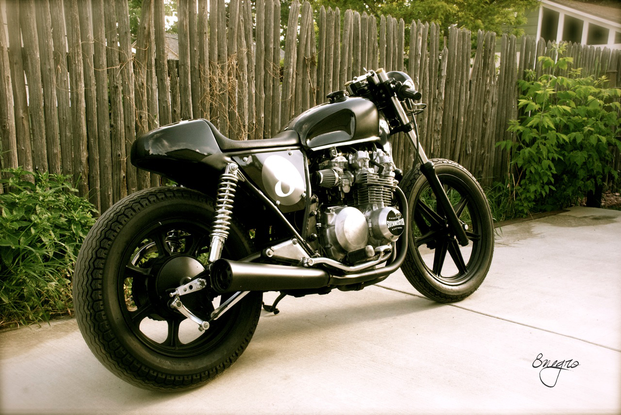

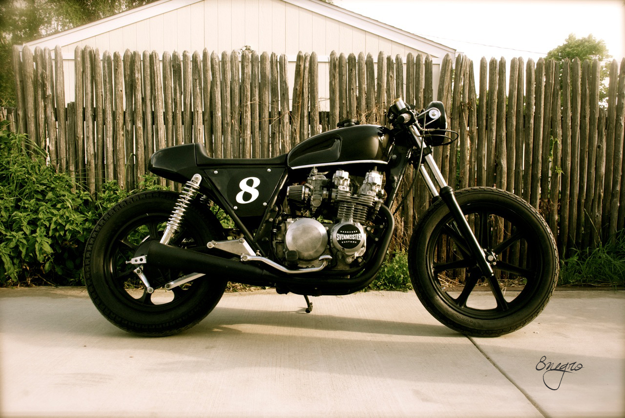

Here are some of the inspiration bikes Im working from on this build...
Farnie

i like all your inspiration bikes.

09 Oct 2012 23:10The first 3 are actually pretty coolfarnie wrote: Here are some of the inspiration bikes Im working from on this build...
Farnie

Yup nice bikes you picked out. This one has always been a favorite of mine, maybe not the direction you're going though.

Those side covers inspire me...
