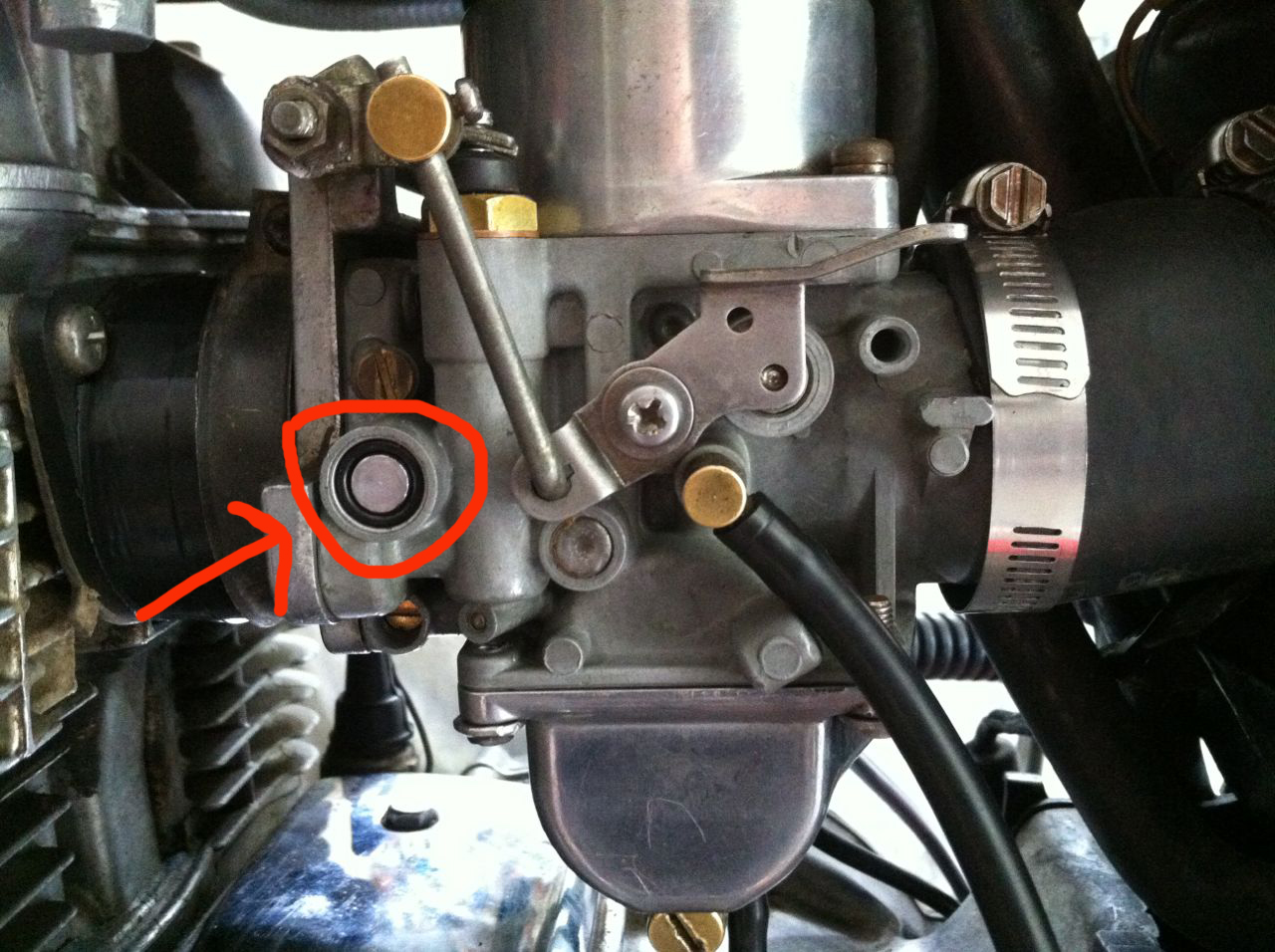

I took the bike over to a buddy's house to help me sync the carbs. We fired the bike up and he said I don't have leaks at the carb holders but at a part of the idle circuit. I circled the part in question on the pic. He said I have a vacuum leak there and suggested maybe putting in an o-ring. He said this is similar to some part on VW carbs that has issues and has to be machined with a groove to hold an o-ring to fix. The whole time adjusting the idle screw couldn't get the bike to hold idle and it ran very rich.
I took the bike home and read up on these carbs trying to find a mention of this wore out circuit. I couldn't find any. I took the carbs back off this morning, checked all the jets, switched the needles to the original ones which were a tiny bit shorter and adjusted the sync screw since I noticed the butterflies were quite a bit off. I set the idle screw to 1.5 turns out and fired the bike. It ran much better and turning in the idle screws another .5 turns got it to hold pretty clean idle at 1,100 rpm. The bike also revved just fine. Letting the bike idle for about 10 min also seemed to make a diff...guessing it hasn't ran in many years.
Has anyone ran into issue with the carb part I circled in the pic? The bike seems to run fine now so I'm not sure what really needs to be done. Thanks.
