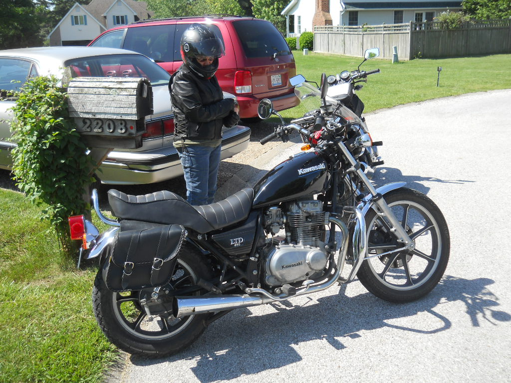

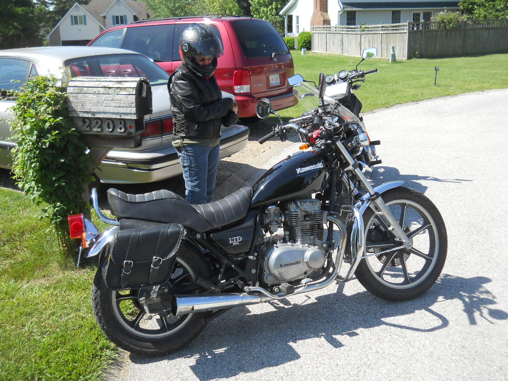

I used a set of bars from a 400 or 550 standard on my wife's 440. The wrist angle is much more pleasing. She is 5', I'm 6' and they fit for both of us.
Changed out the master cylinder for one from a standard also.

Hey that looks great! I'll check into the bars.

I see over in the for sale section a guy has a set of bars off an 82 550 LTD. Something like that?

Nope, LTD bars are going to be like what you have now.

Pumps, The bars on the wife's bike measure approximatly 30" width, 4.5" rise and 6.5" pull back. Center width is about 6".
Z1 has some Daytona Touring bars (EM23-12564)that are close and under 15.00.
