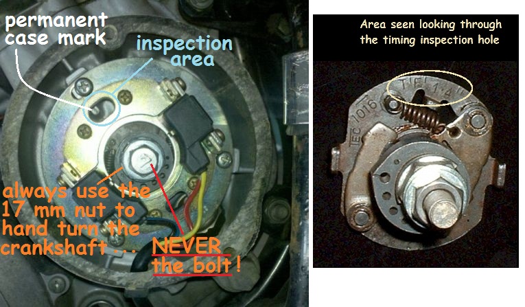

If not already done, would use a timing light to assure proper functioning of the timing advancer by watching for it to quickly move back and forth as rpm is varied by blipping the throttle.
The advancer may require lubing or both cleaning and lubing.
Likely be able to apply a drop of oil onto the weight arm pivots by access through the timing inspection window.
Make sure the advancer does NOT look like this:
